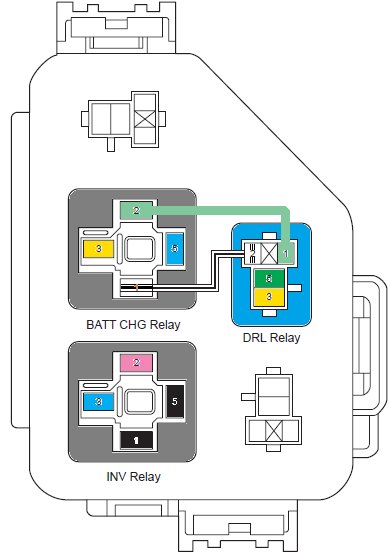

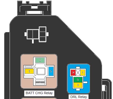

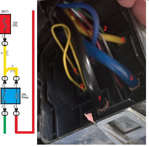

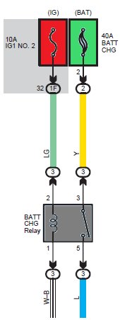

    Cut the yellow wire on the DRL relay, insulate the side that ran towards the relay. Add a small length of same size wire to wire still attached to the relay. T-tap the IGN wire of the battery charger relay, mate it to the wire previously mentioned.
    On the connector that goes into the headlights, cut & insulate the pink (Left hand) Baby blue (Right hand).

    And so they don't turn OFF when you select Low beams, cut the red and T it into the ground wire of the battery Charger ground.

    @caribe makaira
    Thank you! That’s exactly what I was looking for. Your the man!!
