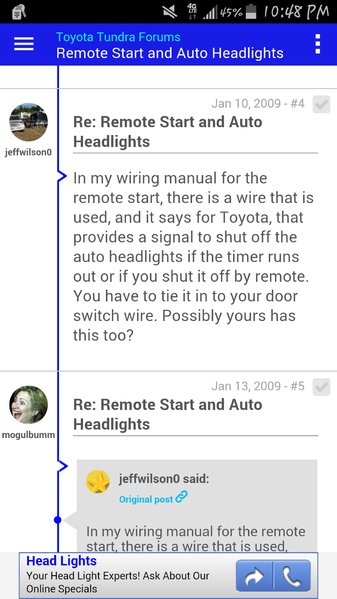

    #178996
    4
    Shaun
    16' Tacoma Dbl Cab TRD Sport
    thanks daddy_o , i will be showing this to the installer, will update as to what progress i get to this, and to everyone if they still have more ideas for me that would be greatly appreciated.
