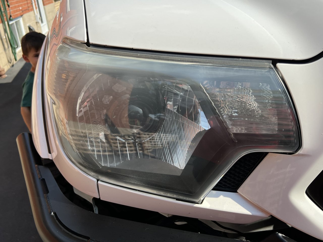

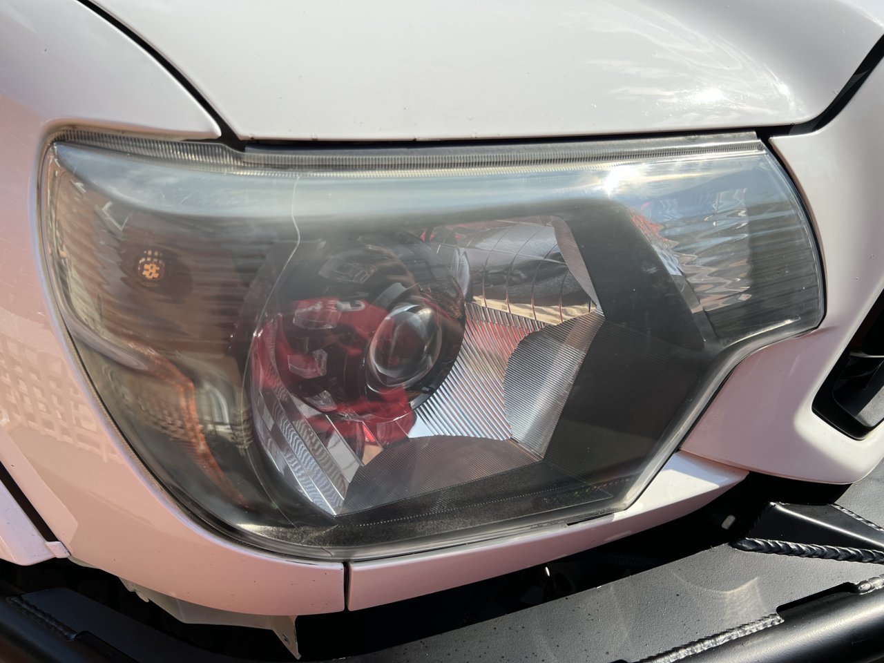

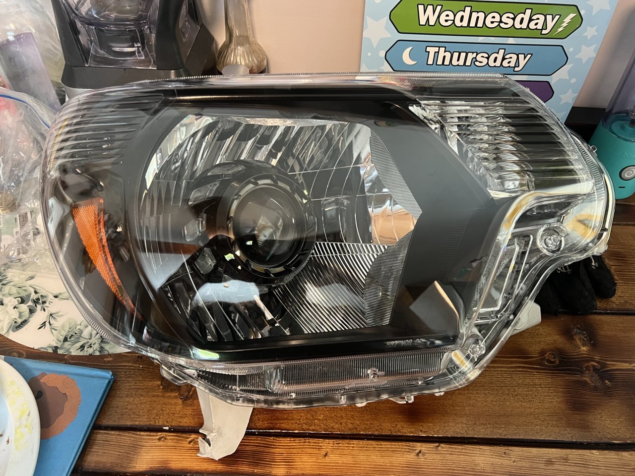

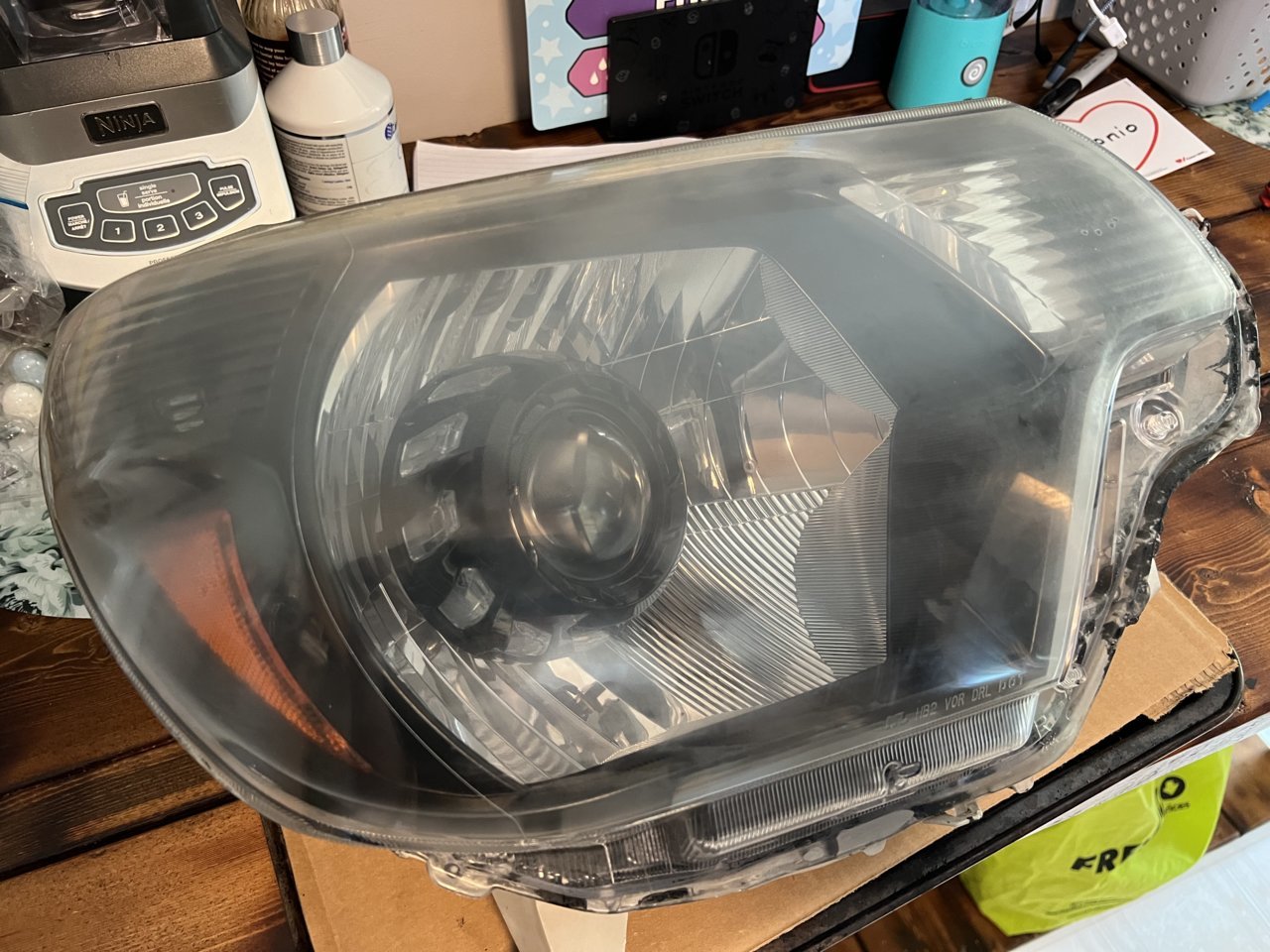

    Bought these lights about 6 months for or take, noticed in the last few months the passenger headlights started getting a haze from the inside.
    There is no condensation or leaks anywhere from what I can see, removed bulbs and put in a few silica gel packs with no luck.
    Is there a fix for this or just have to replace the lense?
    I’m running LED projectors along with LED DRL and corner bulbs.
    57B23A0A-66CC-475A-AEC5-50834AD7901B.jpg 163DED96-510D-4A8C-8287-7411FEB932B5.jpg
    This is the driver side.

    Was this a retrofit? Almost looks like off-gassing from the black bezel paint hazed the inside of your lens. Strange it only happened to the one & not both. If it's a retrofit I would contact whoever did the work.

    Bought them used off of a member. :(

    RTV silicone can offgas and leave a film of translucent crud. One may have been sealed with butyl rubber and the other with rtv?

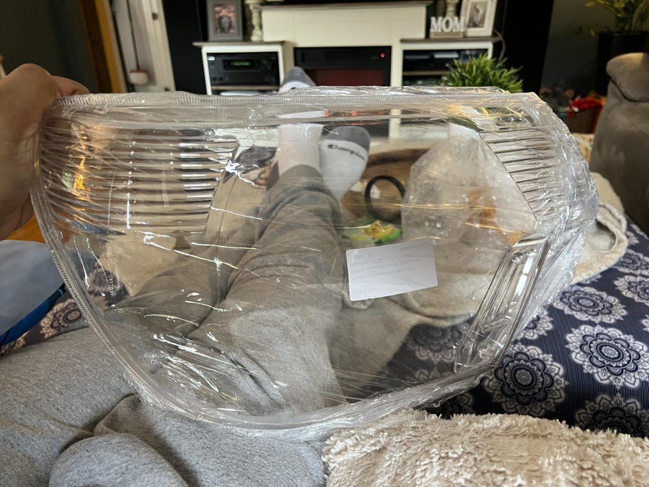

    Just ordered a new replacement lense, hopefully this doesn’t happen again. I’ll be using window weld butyl, never had any issues with gassing from previous BHLM.

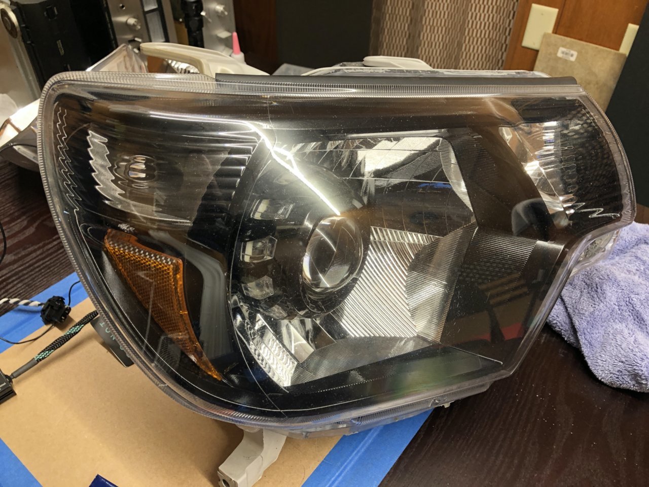

    Replacement lense came in, seems to be great quality!

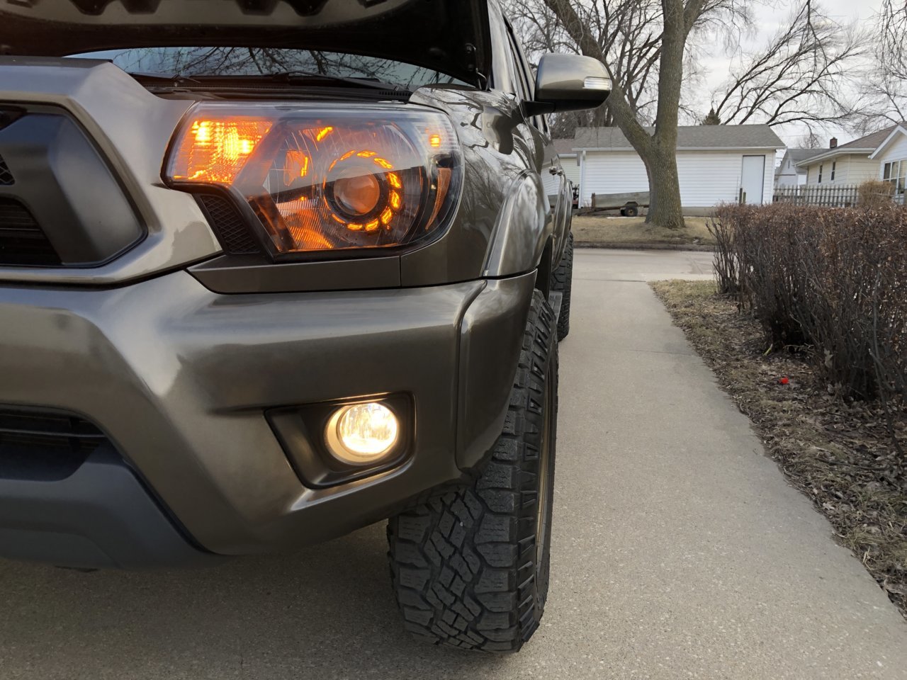

    Funny enough, I did almost the same style retrofit back in 2019 and the lens is getting pretty tired. lol I used RX350's and swapped to clear lenses.

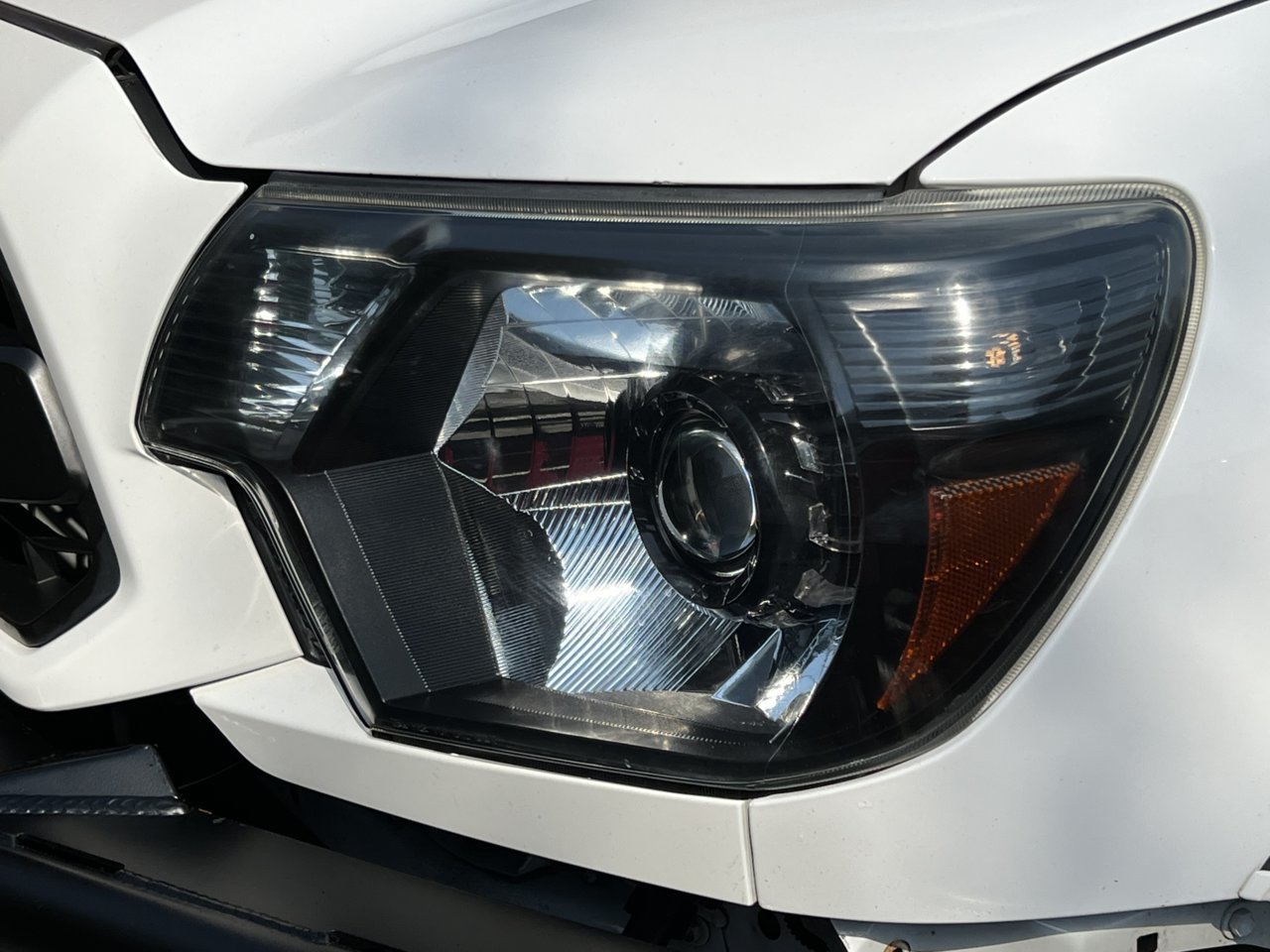

    So much better.
    My headlight lenses are the same way (both sides). But the thought of pulling them off again is nauseating.

    Nice. Did you clear coat them?
