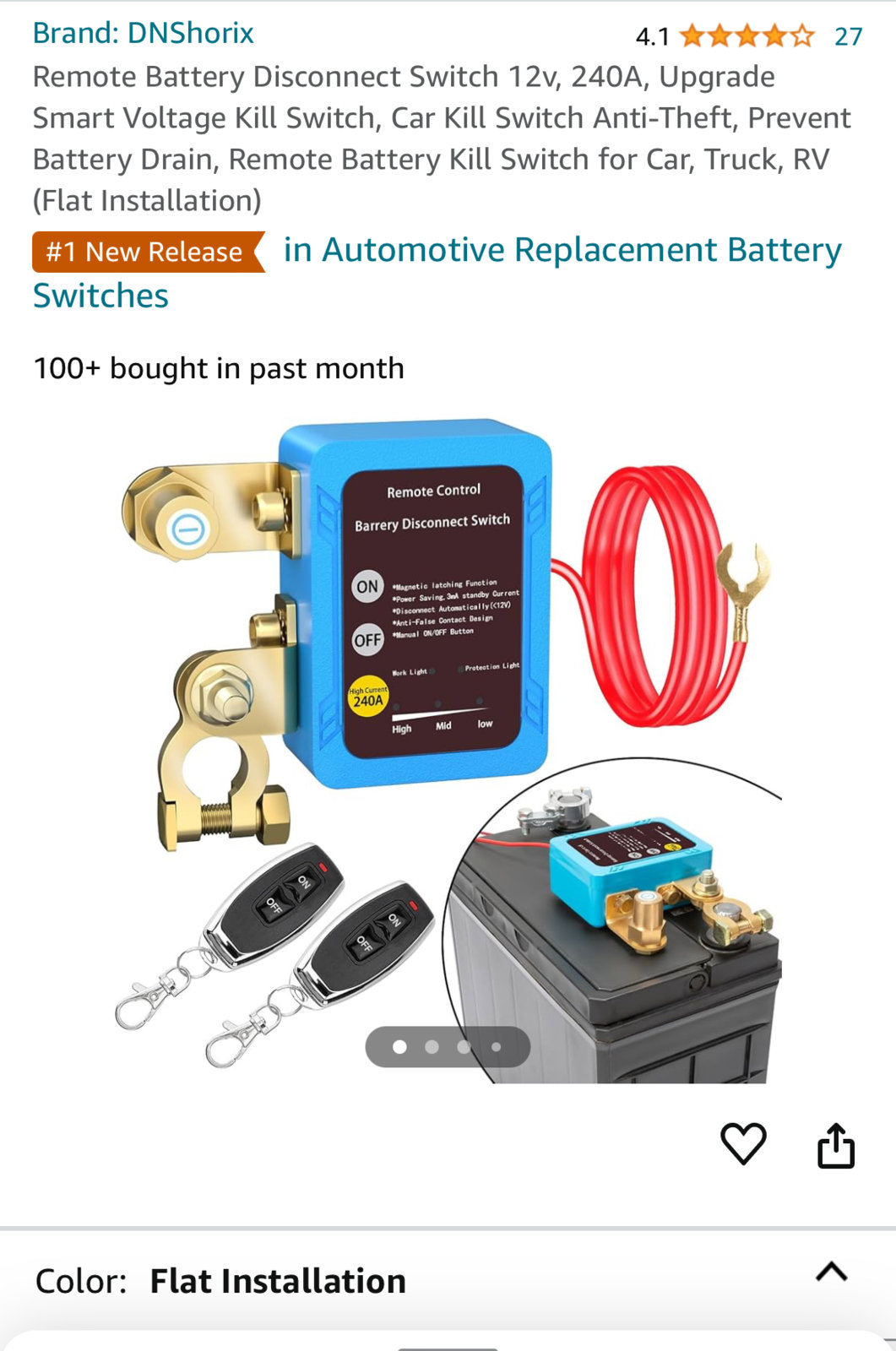

    I have no idea what’s going on with your truck but the below device might be worth buying while you figure it out so you don’t drain your battery every day
