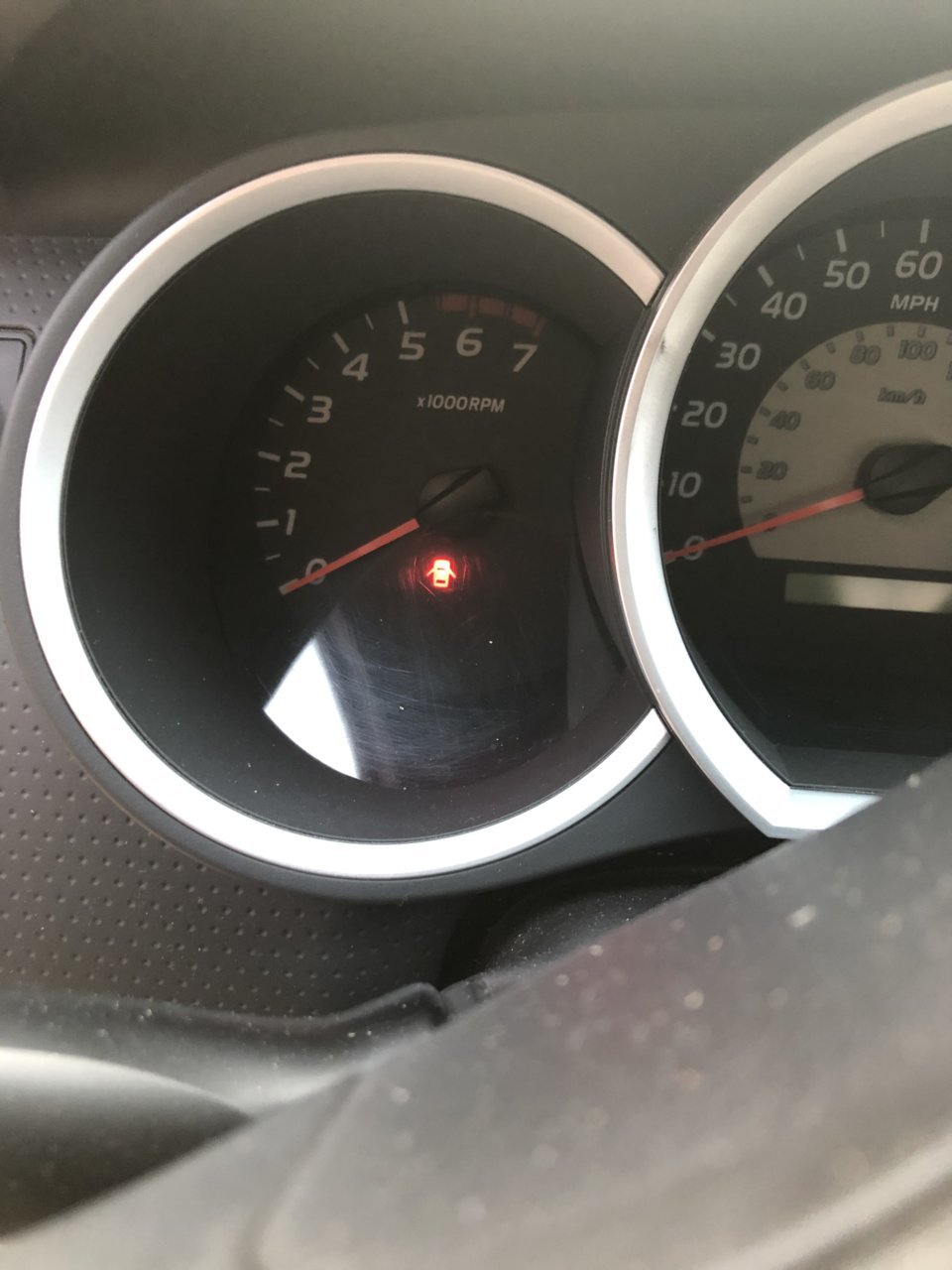

    CA563E8F-8DCF-40A3-B1CF-10A94A4C99F6.jpg Does the door light come on when you open the door?

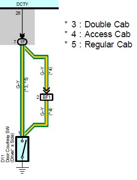

    Aha. My driver-side door ajar sensor is not working. (The passenger side Is working). I'll need to see if this is a sensor failure or if there is a fuse dedicated to the driver side.
    Thanks for the point in the right direction.

    No fuse.
    Just a pin switch to make or break ground.
