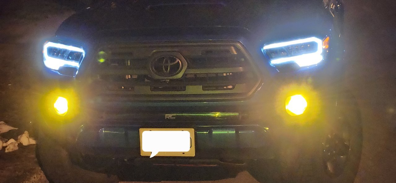

    Did you go with the yellow or white fogs?

    Hauser94[QUOTED][OP] likes this.

    Can you explain to me the backlight cable you got for the fogs. I thought the fogs were straight up plug and play? I am kind of a novice with this stuff so forgive me if this is a dumb question

    The fogs themselves are pnp, but the backlighting feature is not supported as a stock function so you need to find a power source for them. The daveeasa harnesses I got made it easy, else you can splice into something or run a tap out of the fuse box.
