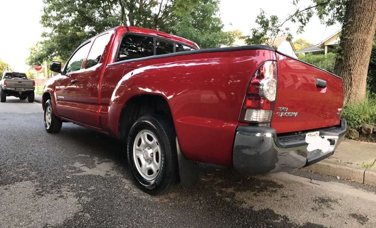

    Here's the last two I did with zaino. I did windows, trim, plastic, weatherstripping, and paint with both. The red truck was in ROUGH shape. I had to hit with Meguiars ultimate compound first.
