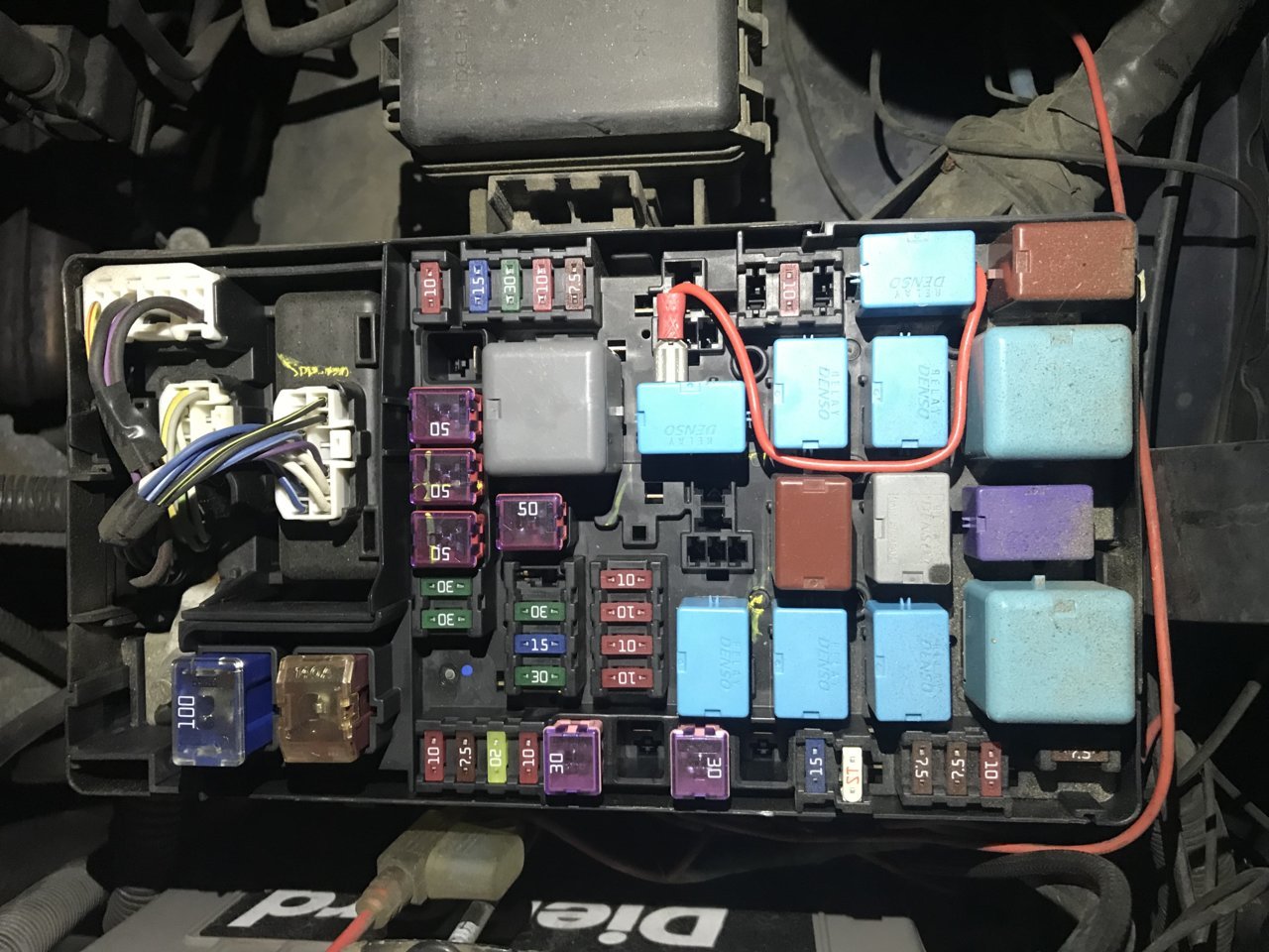

    It’s been so long I have to try and actually remember what I did lol. I believe it was just the jumper wire in the engine bay fuse box.

    I still pulled out the anytime fog jumper. Wire was still in good shape. All the relays were still tight. I had the fog jumped to the towing taillight. Not sure how that’d effect the headlights so not confident that will solve it. Here’s how I had it rigged up....

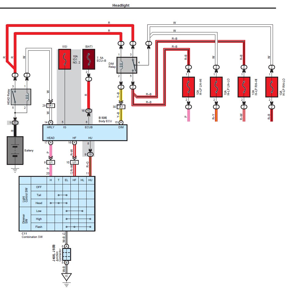

    Thanks!! I have no idea how to read that chart once it passes the relay, so I'll take your word for it:rofl:
    My common sense tells me that whatever is failing must be something that allows a constant power to pass through it, when it would normally prevent it, since the ignition is turned off and the headlight switch is in the off position as well.
    That's why I don't think it's anything downstream, like the foglight mod or HID's, or even the stalk switch for that matter. I'll order up a HEAD relay on Monday and go from there, but gladly still take more ideas from everyone.
