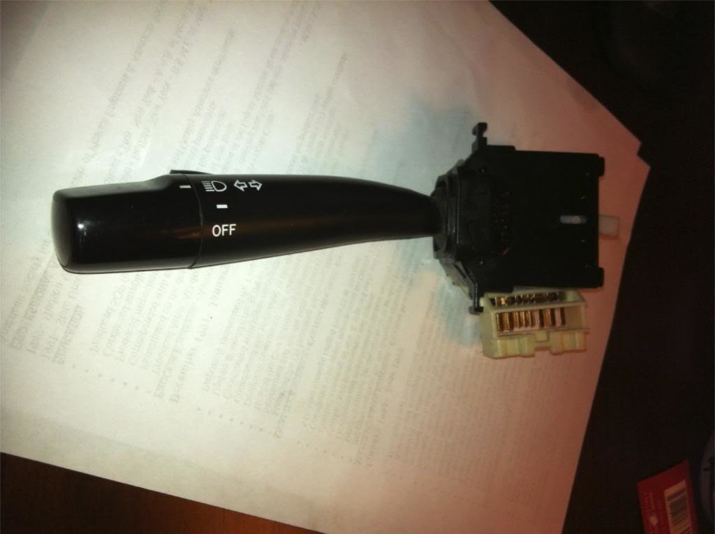

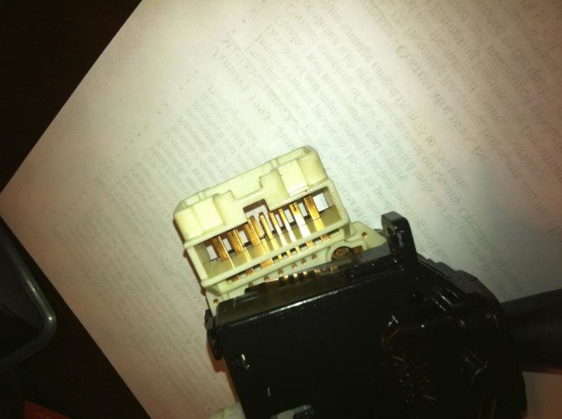

    Actually it's probably the switch that shorted out. My friend had the exact same problem as you described, we tried everything, then replaced the switch and everything worked. They are notorious for going out. You can find non OEM headlight switches on eBay for about $50 bucks.

    Die off!?... Maybe TTORA members are off wheeling, instead of web wheeling like you and I are. :)
    As to your issue, check the bulb, then the connector's wires for torn sheathing, then the relay and finally the switch.
    This is what I found and posted back in April.
