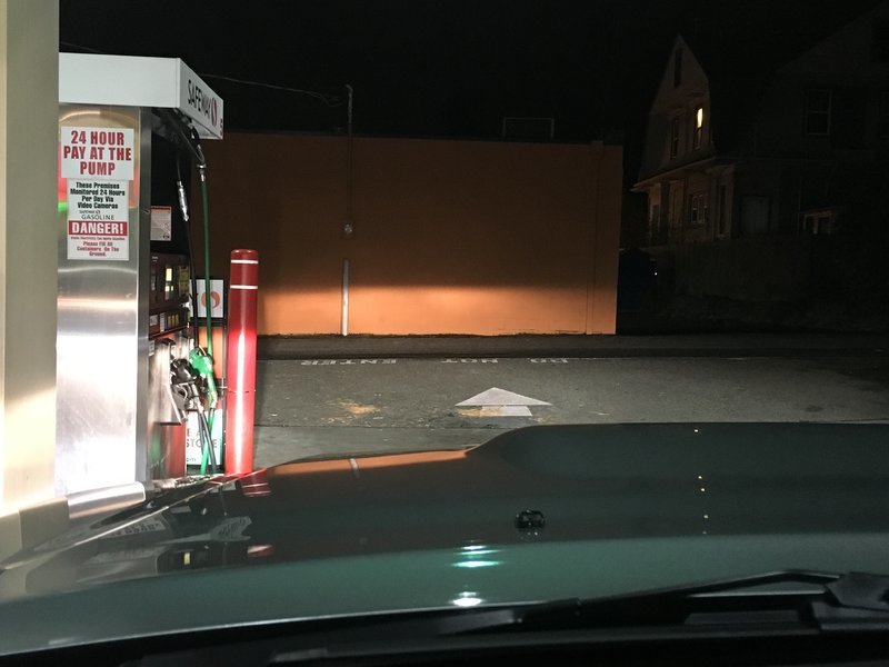

    Here is a pic of the above stated headlight upgrade (Ultimate Headlight Upgrade) using the Osram 85W/90W with the harness in completely stock housings. Notice the very proper cut off and how well they light up this wall which is 30 feet away.
