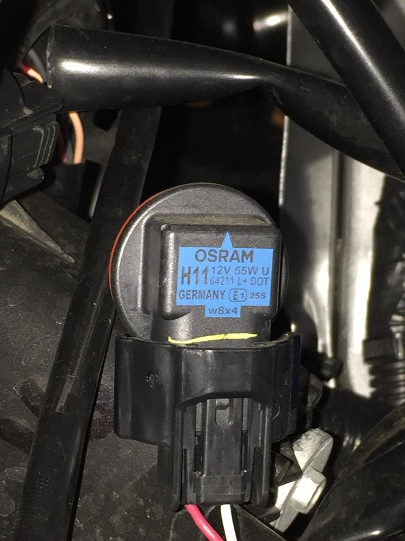

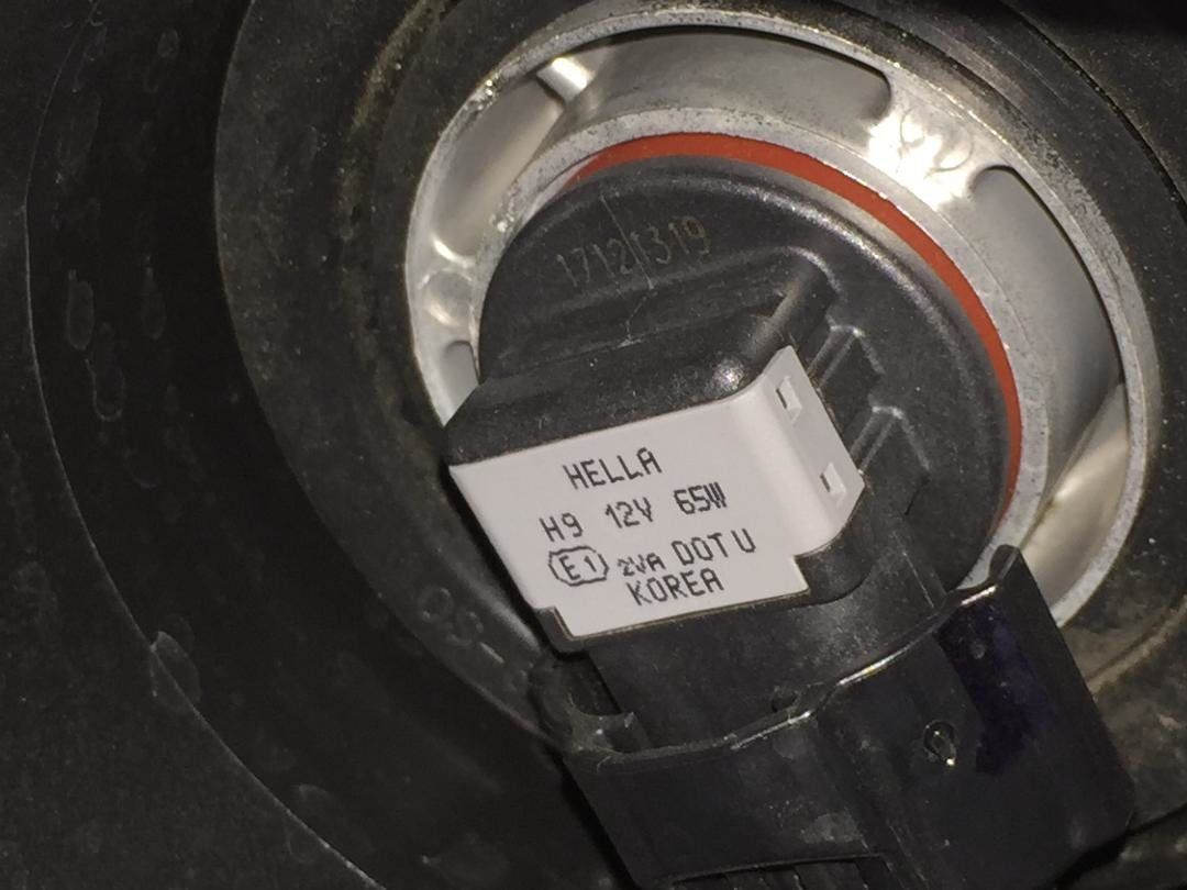

    I will check my low beams and report back, it was the high beams I wanted to project out farther but will keep searching for improvement

    lows are OSRAM and the Hellas I put in high beam, yes the Philips made in Germany are very nice bulbs so now I have spares for the high beams, how strange they put different brands in the low/high ?
