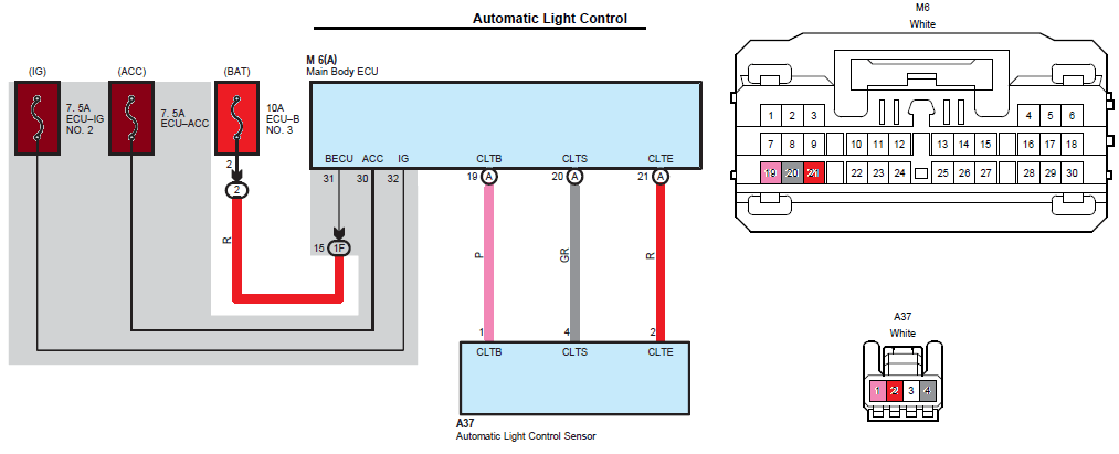

    My DRLs, automatic headlamps, headlamp delay when leaving vehicle have suddenly stopped working. Lamp stalk is in auto and I’ve played with that, I’ve gone into the head unit and checked my settings there and they are all good, even changed those settings and still nothing. I’ve got a little over 5,100 miles on the truck. Any suggestions on what it could be or something I can try?

    Light sensor has nothing covering it (hat, papers, etc.) or has been damaged?
    Do you have a DMM and know how to use it?
