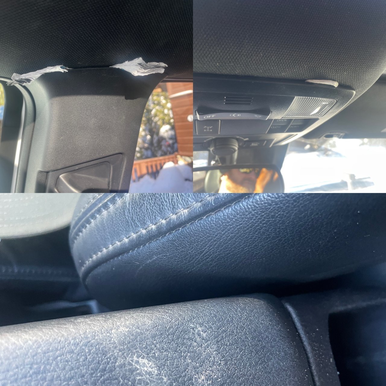

    Hello! I just picked up a new to me 2020 off-road. Great truck so far aside from some chronic rattling. One that I have chase down and finally identified is over the passenger side front seat where the headliner rattles when you are on anything other than smooth road. If I press and hold it the noise goes away but I’m not sure how to fix this for good. Would this be something that would be covered under warranty? Any idea how to fix something like this? Every day it seems like there is a new plastic rattle somewhere inside the truck. Is this normal?

    Maybe someone dropped a screw in there while modding. Or maybe it's why it was traded in. I'd just go to a body or interior shop and pay them to drop the headliner.

    I’ve nailed down a few places where it rattles. first, between the door and the dash, I added some rubber tape so that the door and the side of the dash are actually touching each other now. Without that they would intermittently rub and specifically when I would play music I would get a major rattle in my passenger door. This solve that problem. The photos attached show my problem areas. One is the overhead light area and the other is above the passenger seat belt. I’ve been trying to nail down the specific places by stuffing paper as you can see into these areas. This seems to solve the problem but obviously is not a long-term solution. Trying to figure out what I can stuff in there to make things quiet. The rattle in the overhead light is unbearable as it’s right by your ear. Also another area is between the seat and the armrest, also shown in the photo. They just barely touch causing all kinds of squeaking and rattling. If I stop something between the seat in the armrest that all goes away. Seems odd that these materials touch each other and there’s not even a quarter inch of space between them.

    I purchased a piece of carpet padding for my headliner rattlingly issues. Both the driver and passenger sides between the door frame and sunroof rattled like crazy.
    Carefully pull the U shaped rubber weather strip down from the top of the frame. Once removed you'll have enough space to slide a piece of carpet padding between the liner and metal roof.
    Reinstall the U shaped weather strip and you'll be rattle free.

    My overhead rattle was a piece of trim above the headliner around the overhead switch panel.
    Switch panel pulls down (4 plastic push style clips near the corners), takes a pretty hard pull.
    Take some red backed 3M tape and tape that under “ring” to the headliner.

    I’m not sure where you are speaking about with regards to the U shaped rubber weather stripping. From within the sunroof mechanism?

    When the doors close against the body of the truck, the doors close against a piece of black rubber. That black rubber weather strip wraps around the entire door. Grab the rubber strip at the top of the door opening and steadily pull down. Once that rubber strip is removed from the door opening you can slide your hand under the headliner.

    You sir are a genius! How is able to pull the rubber seal out and stuff some material between the headliner and the plastic and it seems like the problem is now solved. Onto my next rattle…
