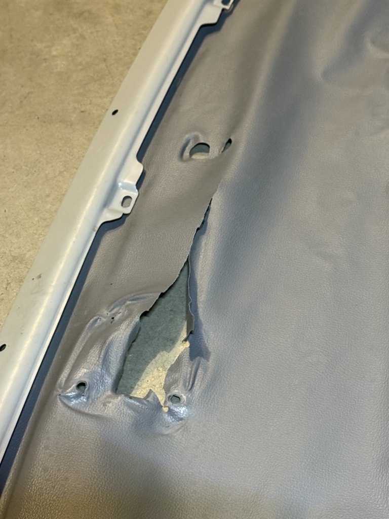

    I need a little help/advice replacing my headliner on my 1996 extender cab Tacoma. I recently replaced the rear light above the bed and the light inside the cab accidentally ripping the plastic headliner. After doing research there isn’t many videos or forums or information in general on replacing the headliners on 1st gen Tacomas.

    What I’m looking for is replacing the plastic/vinyl headliner with one that isn’t ripped that doesn’t cost an arm and leg. I have replaced the fabric on a different vehicle's headliners in the past but that vehicle had a rigid molded board which was relatively easy to replace the fabric on. My Tacoma comes with a bow style headliner and doesn’t have the rigid molded board behind it.
    It looks like my options are replacement of the headliner with a new one which is $300-500 which is the least appealing option due to cost but easiest?
    I could get one used on eBay for $150-200 and gamble quality/rips/tears plus I would need most likely need to paint it to match the rest of the interior.
    The option which I would prefer but looking for anyone with experience or expertise, is replacing the headliner with foam backed vinyl/fabric. For the fabric and glue it looks to be around $100. I would have to cut it myself to the shape then spray glue/roll it straight to the foam insulation that I installed. My concerns are the foam backed fabric/vinyl sticking to the insulation that I have installed and falling down over time without the help of a rigid board.

    Lets see a pix of the dmg
    I 2nd Topdog’s suggestion…apholstery shop
    in fact, AS can customize the headliner to your needs/budget
    Fairly inexpensive way…. They could overlay a fabric (your choice) over the existing cheap/thin vinyl HL
    Hide the dmg AND you have a custom headliner

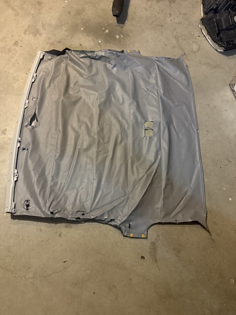

    So I think after exploring my options I think I’m going to first try to “patch/repair” it with the kit from Permatex from autozone which looks like it uses some sort of material and burner tool to melt the vinyl back together. The tear on the light looks not as bad when I have the entire piece off. My plan is to paint it black with vinyl spray after to match the rest of the interior of my truck so I’m not to worried about perfection.
    That being said I am completely missing the back piece of the vinyl from rear of the headliner that connects to the cab but might just find some way to cut and add a strip of fabric from the last bow to the back of the truck.
    If that doesn’t work my plan B is that I am going to give it a go making my own replacement headliner. I found a great YouTube video that shows how to measure, cut and then sew together the fabric for a bow style headliner. The metal bows are in great shape and clips that hold in to the truck look like great condition. That being said hopefully the vinyl repair is good enough and I don’t need to do plan B
