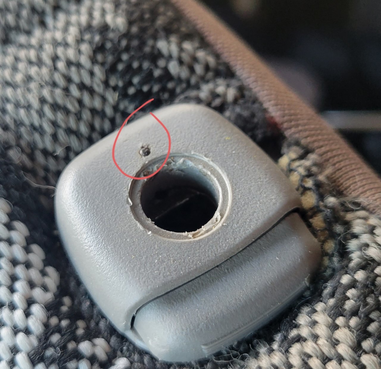

    How do you remove the pin/nail from the button bracket? Can’t seem to get it out

    Bilstein 5100's Firestone Riderites Deckplate Mod & AEM Aisin Clutch plate Luk Flywheel Timken bearings Marlin Crawler shifter bushing GTA CarKit Gentex 453
    You need to pull up the little "bump" or "set pin" with something that won't tear it up too bad. Besure to HOLD ONTO the side push button because the second you pull that "set pin" up the spring for the side button will shoot it out and the spring will go with it and you can lose the spring super easy.

    Redmond, WA
    2004 dbl cab 3.4L 4WD
    Thanks for responding… what did you use to pull it up? I’ve tried a push pin to kinda dig it out and a magnet to try and pull it up but nothing was working. Any suggestions?

    2001 Silver Tacoma 4x4 Xtra Cab
    I wouldn't advise for it cause it could cause possible damage, but I wrapped the ends of needle nose plyers with electrical tape and was able to get a small purchase on it.

    Redmond, WA
    Awesome thanks… I was gonna try a stronger magnet and if that doesn’t work put some sort of tacky adhesive on the end of a paperclip… any other suggestions are welcome

    Wyoming
    2000 Tacoma TRD v6 5-speed
    The pin on mine had worked it's way up a little, so it was easy to get it the rest of the way out. Maybe the hole goes all the way through and you can push it up from the bottom.

    Nate
    2001 Tacoma xtracab
    I got mine out by working it up with the tip of a sharp knife (disposable razor blade). Kind of ended up gouging the surrounding plastic, because I had to dig for the head of the pin a bit. Worth it for a locking headrest! Bonus tip--if you can't find a new clip for your driver's seat, there is always a passenger seat ready to cannibalize ;) Also can vouch that the clip and springs will come flying out with 3x more force that one would imagine, have a catch cup or something ready.
