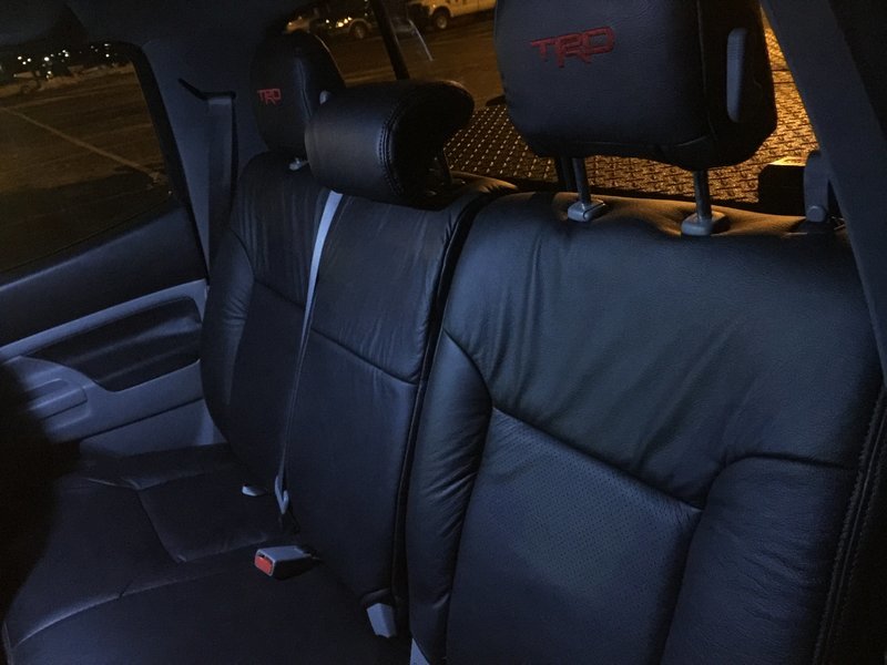

    Forgive me for the bump, but I know I'm not the only one who's going to run into this issue. As we all contribute our findings or "fixes" for problems, I believe we can individually contribute to this forum.
    Here is my update:

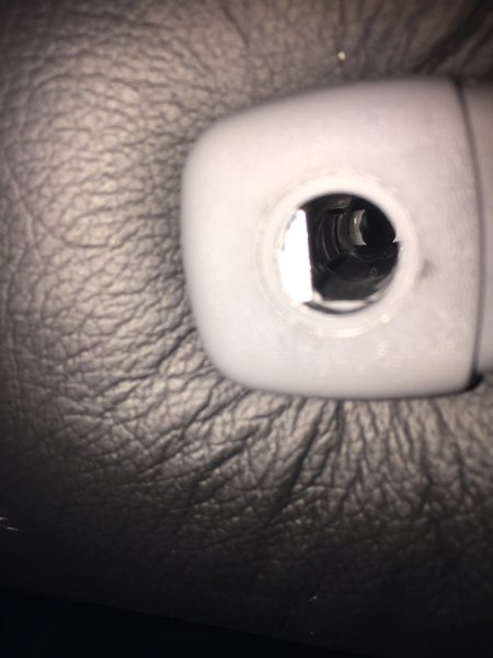

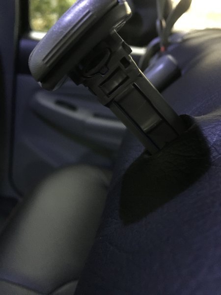

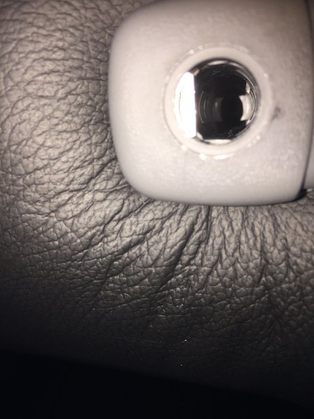

    Problems noted after leather install. (You can also see the rear center headrest is not flush as well.)
    I began to remove the plastic posts to further investigate...
    And found the root of the problem...
    If you look carefully, there are tabs halfway down that hold the posts in place within the frame. (I am NOT referring to the adjusting metal tab. Look down further to the plastic tabs that stand in the way.) These tabs also act against our favor when they do not completely spring back out upon complete removal of the plastic post or headrest.
    Here is another view as to what the tabs should look like IF it was mounted inside the frame. (Best picture I could do to demonstrate this was to slide plastic posts on rear center headrest while out of seat frame.)
    Notice how the center tabs stick out - which would hold the plastic posts in place. This is its proper position but they get pushed back in upon install, or in most cases, when people remove the headrest.

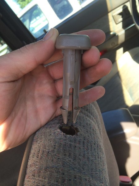

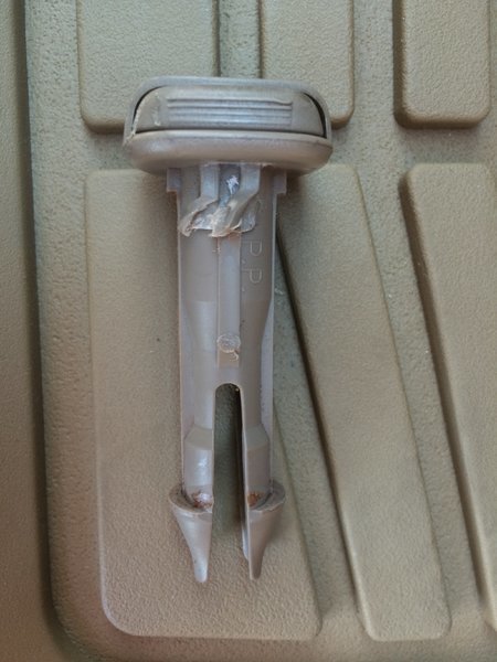

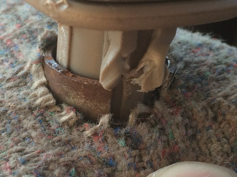

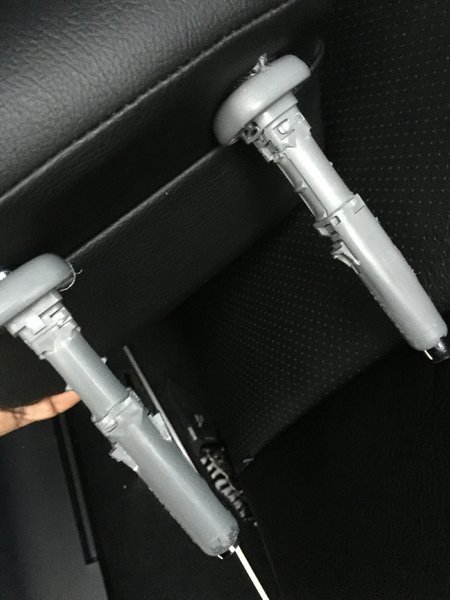

    So I finally got around to messing with the headrest posts on my 1st gen and you really just have to get tough with it. I ended up having to twist it 90 degrees then pull up to pop it off, but doing this sheared off an indexing post that keeps it from spinning when mounted.
    This is a pic when I first got it off:
    Here you can see the indexing tab that basically got sheared off:
    And it fits into a slot in the metal tube of the seat:
    Once I got the piece out I just used a sharp knife to cut off the damaged portion and the post went right back in. There was enough friction that i didn't have to worry about it spinning but if it gives me trouble in the future it can easily be hot-glued in place or something. I will make a separate tutorial for these in 1st gens but just thought I would share my findings here like i had promised.
