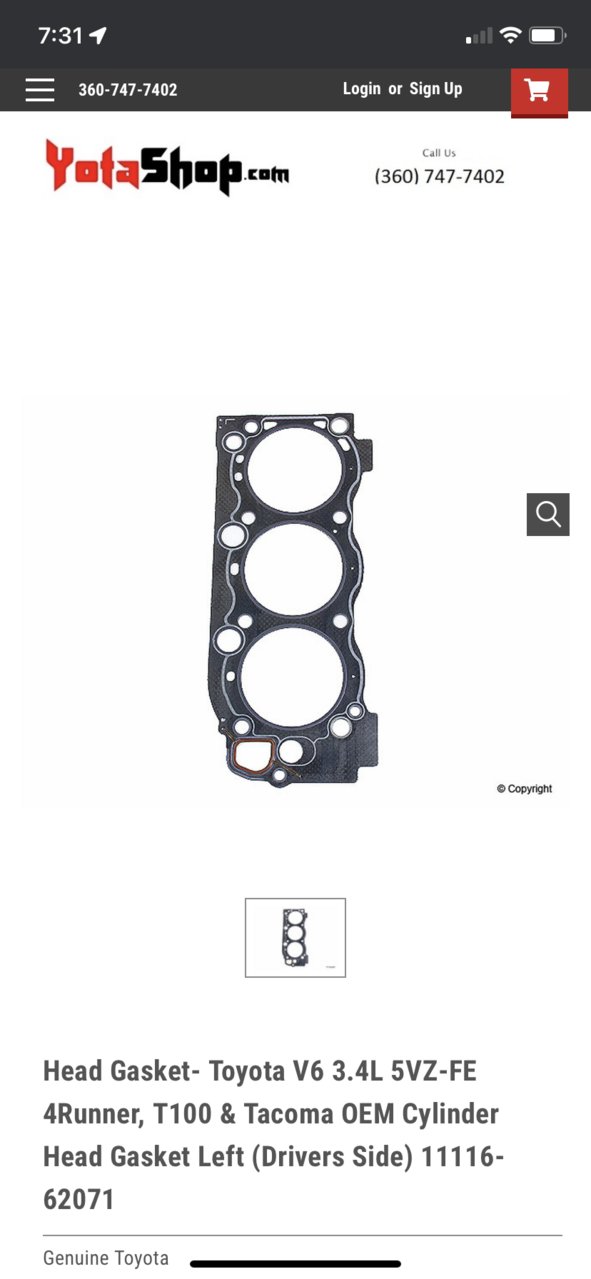

    Looking at this image and the bolt holes it may be possible but I still don’t know. You can try calling the number in the upper right of this image and ask them if it’s possible.

    You can put it on backwards on a lot of engines but it does NOT look possible on the 3.4
    You would be leaking like a sieve.
    Didn't this come up before?
    edit: Does look like it's possible to install them on wrong side though as there are two diff. part numbers and only one has a large hole blocked off.

    Yes you can install and visually see if its flipped. The alignment Tabs in the outside corner (Right side in the image) on the gasket stick out a bit under the head. without knowing how long or how many times the engine has overheated (how much do you trust the seller?) I would tend to agree with the mechanic on the rebuild. Flipped gasket would starve you engine for oil & coolant and thats no bueno

    When I did my 3.4 HG I was paranoid about this and read that you cannot put the head gasket upside down on a 3.4 - does not mean its correct though.
    There is a section of the HG, I believe its at the front of the head, exhaust side that is visible and this is used to identify the version, 1 or 2 holes. I think you can clearly see it on pass side, driver side is obscured by alt bracket - going by memory.
    I believe there are 2 guide pins for the gasket/heads that are asymmetrical and thus gasket cannot be placed backwards.
    I looked for pic online but could not find one. I'll get a shot because the diagnosis is troubling to say the least.
    Edit - checked mine and unfortunately cannot see the HG once the accessory brackets are on, probably need an inspection camera. In any case if HG is really blown I suppose it does not matter much what the reason is. Unfortunately overheating these engines increases chance of head crack so you might lean more towards engine replace.
