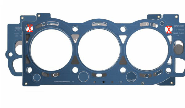

    This is the two sides overlayed, with the right side flipped horizontally to simulate upside down placement. The red Xs are where there are protrusions on the engine block for placement. As you can see, the coolant passage would be completely off the block so it's not possible that it'd even be driving with coolant. That's assuming the installer was that level of negligent and the block studs can actually even line up (doesn't look like they can).

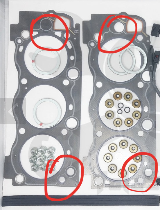

    Backwards may be the wrong term. I want everyone to pay close attention to everything circled in red and maybe other places. Obviously someone would have to not be paying attention. I mean they are labeled left and right.. But before we start giving the op wrong info…it’s definitely possible depending on how you flip the gaskets and has happened to people with 5vzfe engines.
    Take the top gasket how you have it laid out, flip it on the vertical plane and see if they are close.

    I went ahead and did it so we can confirm.
    It’s not perfect but sure seems like you can royally screw this up….and people HAVE done so.
