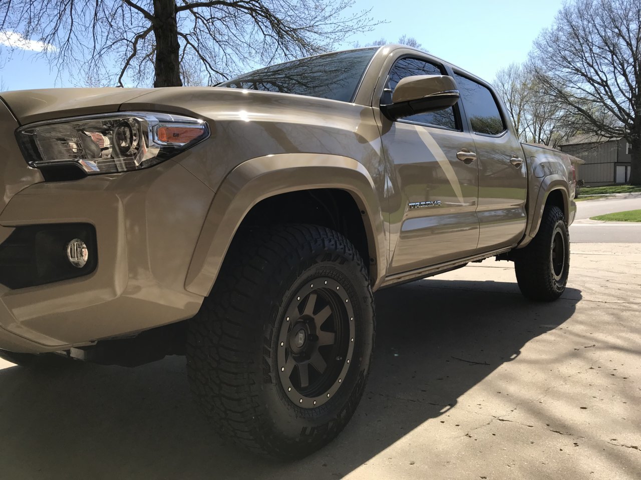

    Who has done this “lift”? I don’t want anything crazy. Stock shocks have 5k miles on them, so don’t really want to swap them out...yet. Just want a little clearance, so my tires stop rubbing.

    Lifts rarely create clearance.
    Tire size and wheel fitment do much more.
    Where is the rub? Some pounding or trimming might be in order.

    I would stay away from it, body lifts can change a lot of things down the line. What size tire are you running? Your SR8s are probably fine, probably need to heat mold the plastic fender liner and maybe bang the pinch weld. What are you alignment specs, might need more caster

    Passenger side (with passenger) rubs the inner fender. I could probably heat and push, but I’d like that small front level as well. Haha

    I have a 1/2" top plate spacer that = 1" of lift
    On top of my ome coils tho

    Don’t do a body lift man. I’d order 2 inch spacers for the front, that’ll make the truck sit level and keep your tires from rubbing.
    Everyone here will tell you to stay away from spacers and they definitely have their points but if your truck is mainly just a daily driver and you need a couple inches to clear your wheels, a 2 inch spacer lift in the front is a great affordable choice.

    Just put half inch spacers for 1" lift. You'll be fine
