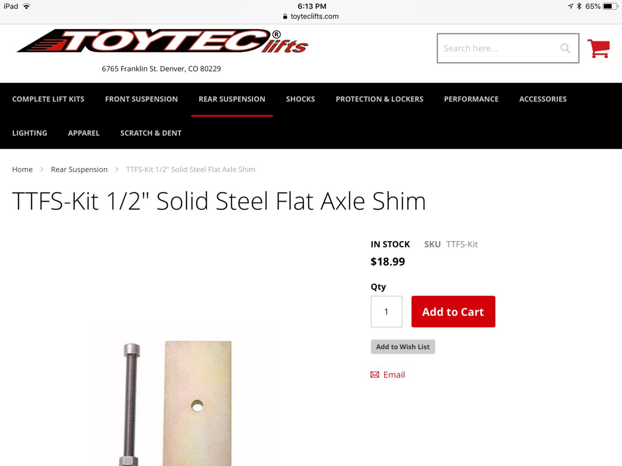

    You could probably use some axle shims. I think Wheeler's has a a flat shim you could use as a block.

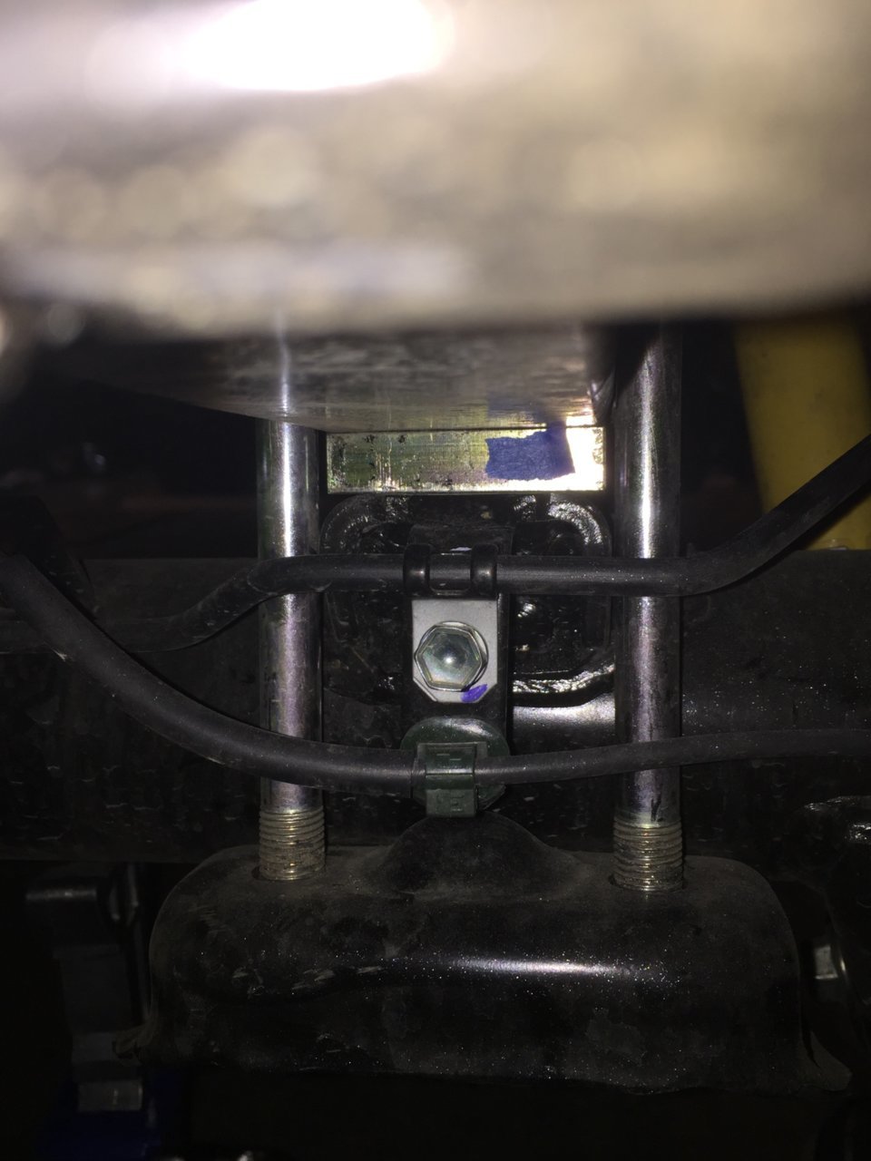

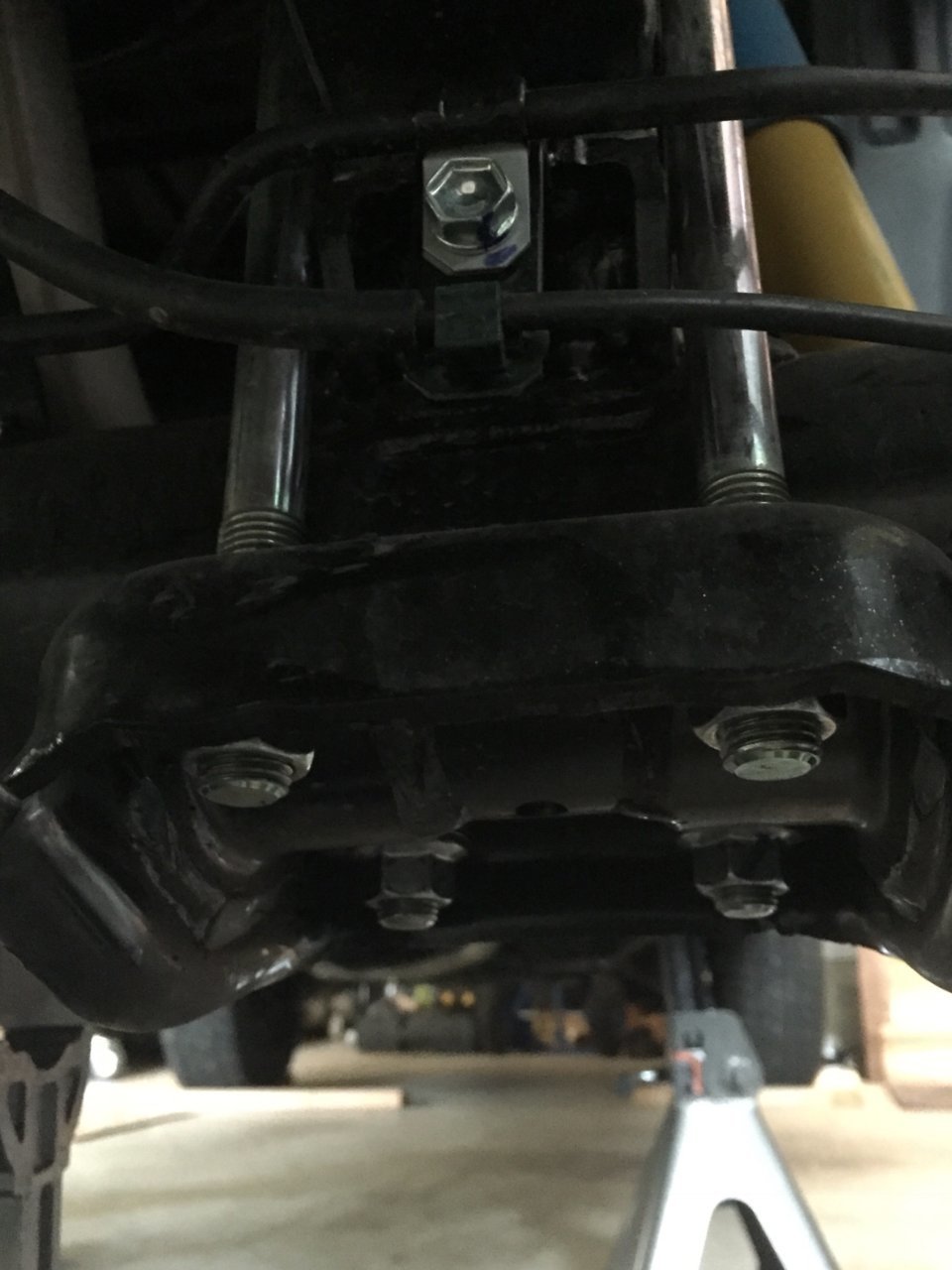

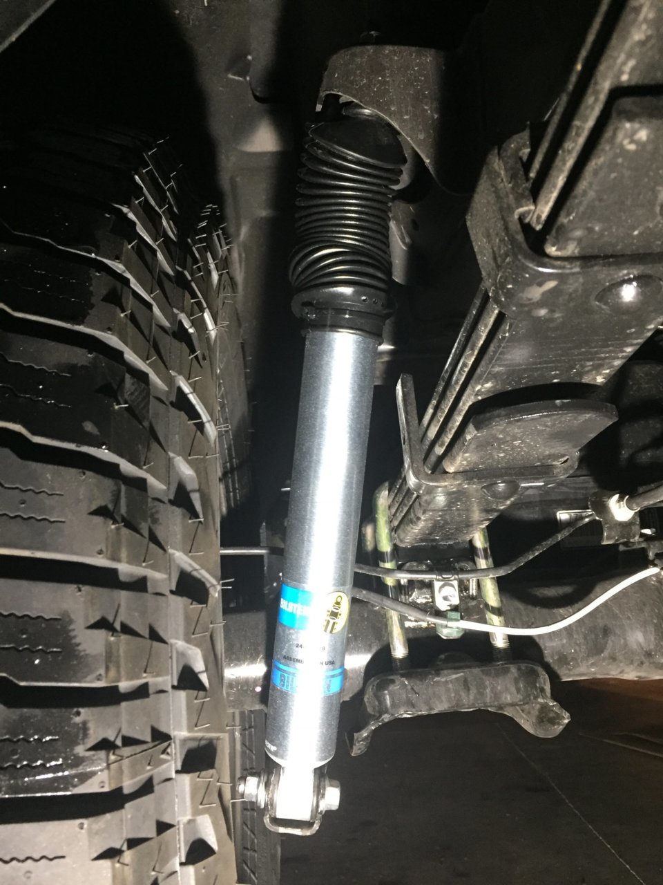

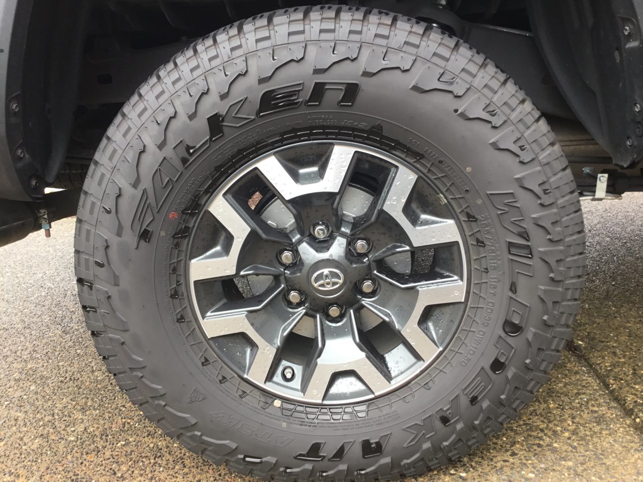

    Zinc plated flat 1/2 inch block with stock U-bolts.
    Blue tape on block.
    New tires, blocks, then shocks.
    987CB0E3-62D5-450D-BEFC-78F1FCFA0A6C.jpg A2373136-F4A9-4C96-8560-32EF21CC7444.jpgE3B01D57-8945-4A76-8E72-6228A4781C1A.jpg5A8DE115-08B2-4863-A131-59C35AA04BF9.jpg

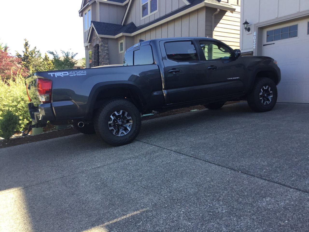

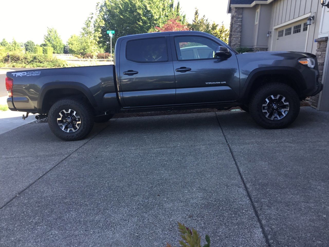

    CB20BB5E-BFE2-4579-A219-F837D426E7C3.jpg 6777D733-E910-454B-8938-761FA3AD741D.jpg
    1.15 higher front, 1 inch higher rear.
    With 1/2 inch block rear, 5100’s at .65 inch front, 1 inch taller tires.AFE701B0-321B-4BFC-8B75-66B3DB51E0E3.jpg
