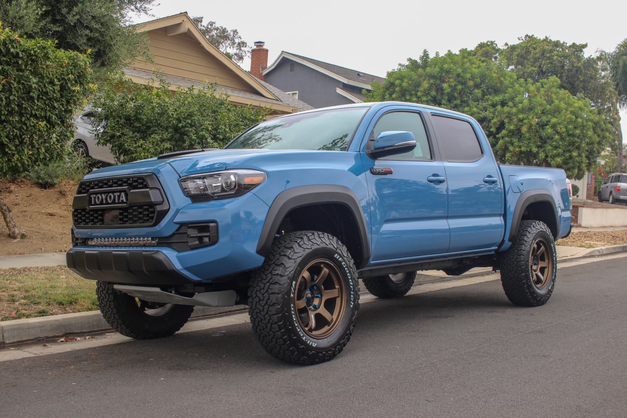

    You will need at least a 2 inch spacer up front to make up for the negative rake. When I had fox 2.5 resi/dcs front and rear with a 1 inch block and at full 3 inch lift up front it’s barely level. Here’s a pic

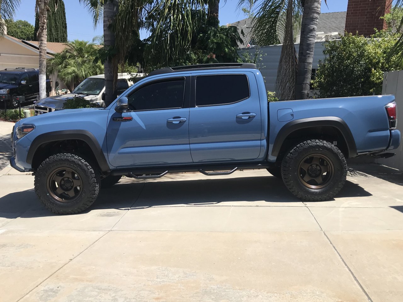

    I had these put on my Pro. 1” block in rear. I also had some Total Chaos UCAs installed, ECGS bushing done, and a cab mount chop. Currently using 17x8.5 SCS F5s with 285/70/17 KO2s. No rubbing at all. Sometime next year I’ll shell out for the complete coilover upgrade. Until then I just stick with light off-road usage.
