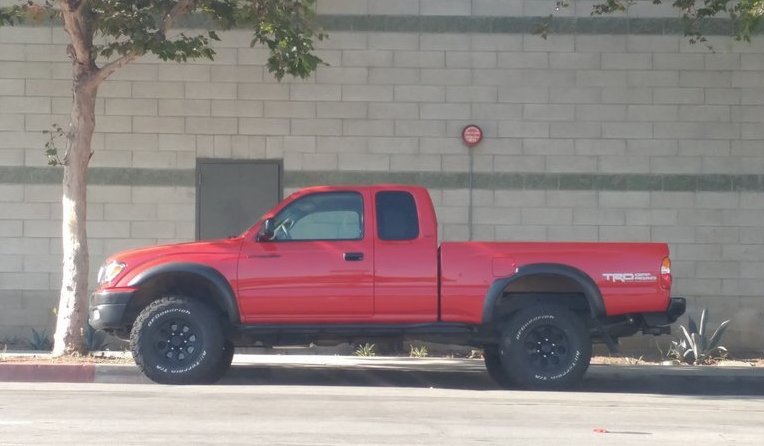

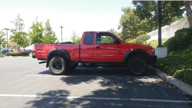

    5100s, OME 881s, Headstrong Offroad 3 Leaf AAL's in the rear (factory overload retained), .25" spacer on driver's side for lean.
    Bought the kit through Headstrong a few weeks ago and got it installed this week. Love it so far!! Rides so much better than the tired stock setup I had on my '04, feel much more in 'control' of my truck and it isn't rough at all, except maybe a little bit in the rear since I have no weight in the back end (yet). The rear is raked 1.75" higher than the front because I left the factory overload leaf in, if I take it out it would probably sit level. But I do plan on putting a topper on it eventually, with the added weight and settling factor over time I'm sure it will even out. I kind of like the rake anyway.
    Excited to take it out this weekend to Pilot Rock and hit up the trails!

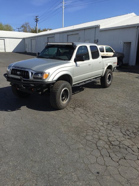

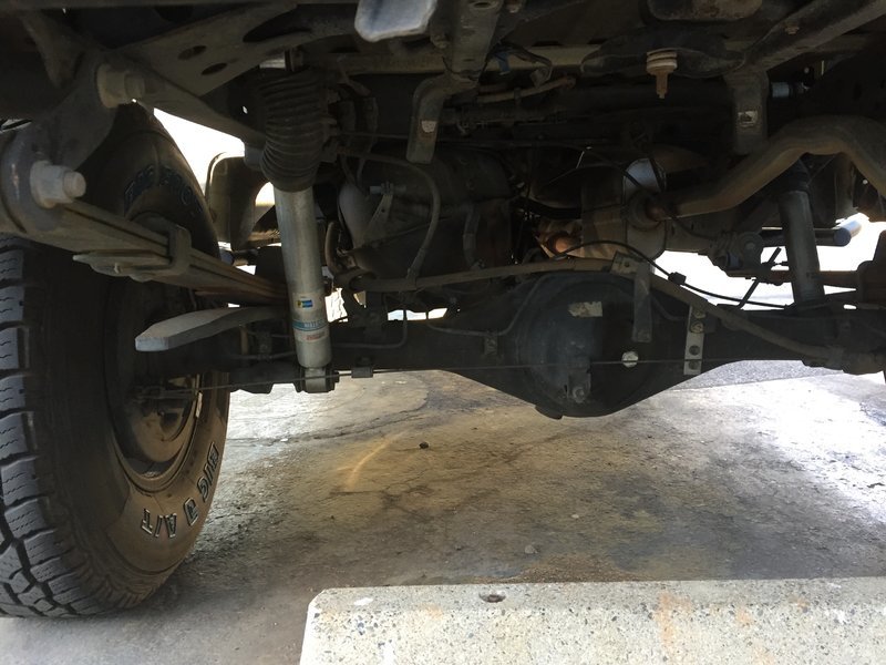

    Yeah cause I have a 3" lift up front & 1.5" AAL in the back. Just can't decide on if I should jump to the 2" progressive or 1.5" progressive or just leave it alone. Mine sits like this.
