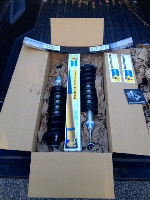

    Finally arrived today:

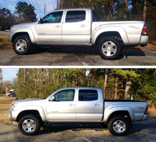

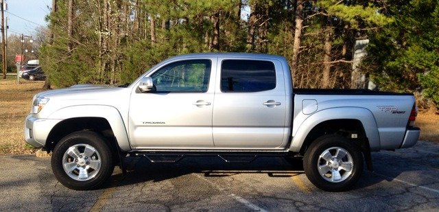

    For comparison:
    Bilsteins set at .85, OME 884s, Deaver 1.5-2" AAL:
  19. Mar 17, 2015 at 8:29 PM
    #159
    MadDaddy
    MadDaddy Pork Rind Extraordinaire
    Jan 1, 2015
    #145405
    6,857
    53 Miles West of Venus
    Many & varied
    Before & After:
