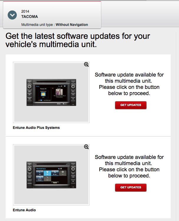

    I have a '14, and while I've not applied it yet I was able to download an update.

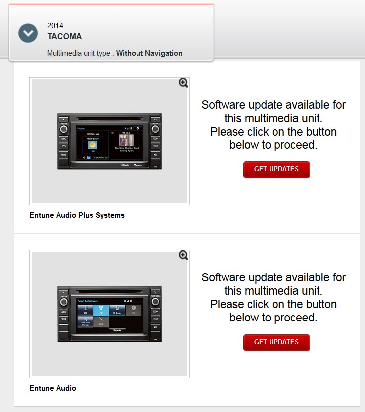

    seems without navigation is available as well

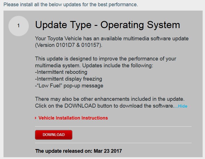

    Ah, this is what you are missing;
    Looks like you are out of luck on this one.
