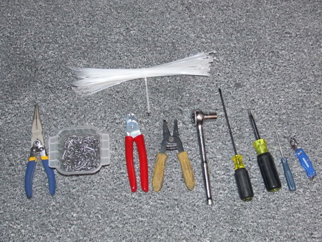

    First the tools I used:

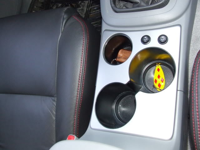

    The heater switches:

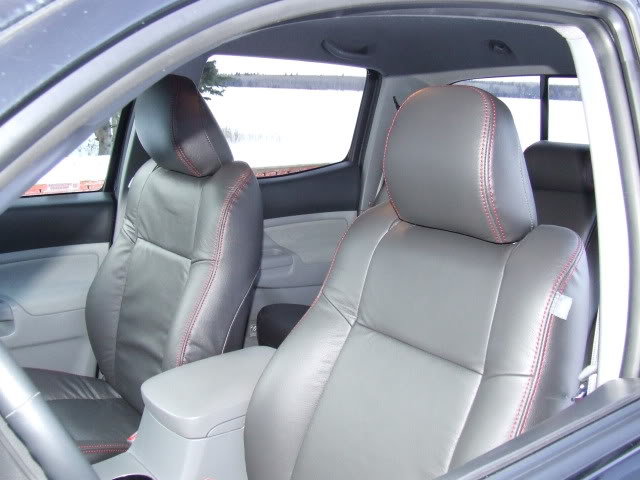

    The front seats: (Passenger side looks really wrinkley in this picture but really isn't)

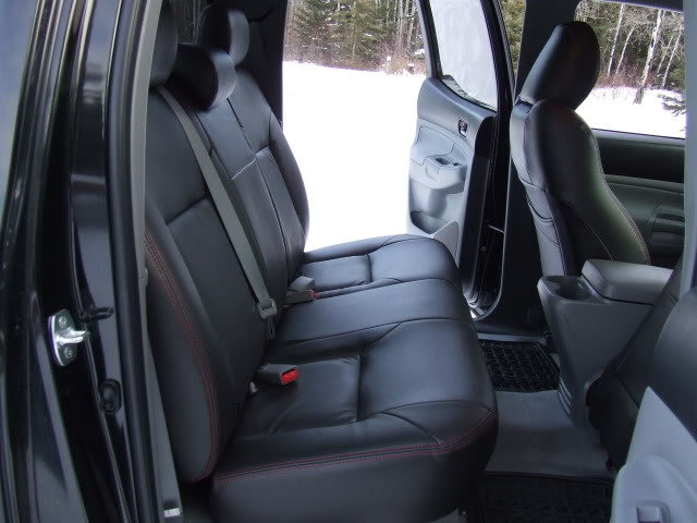

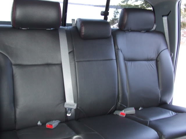

    The back seats:

    Looks great. I need a full picture of your center console. I have ideas swirling around in my head.

    Not sure, you mean the 3 cup holders?..... it's a manual transmission.

    Hopefully that is what your after. If not let me know and i'll try and get better shots.
