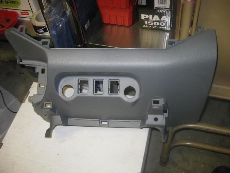

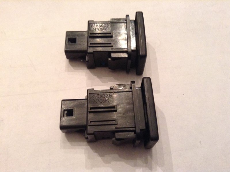

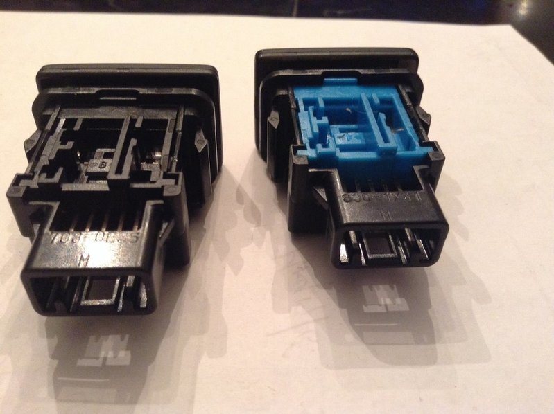

    So I've looked into the fitment of the Under the AC switches into the dash and was a bit surprised with what I found. Below is both a green and amber illumination switch. They are built the same including the raised ledges. image.jpgimage.jpg
    Member @Denk had a fitment issue with his switch and had to remove two ledges. Although I had only installed one under the AC kit myself, the switch slipped in just fine. After doing a bit of looking into it I can see now that the switch openings under the AC have multiple keyed configurations.
    These keyways don't assist in any way to hold the switch in place. My best guess is that each slot is keyed differently to eliminate a switch from being put in the wrong location at the factory.
    For the under the AC option you may need to remove 1 or more ledges for the switch to fit. A quick way to do this is with a palm sander, a dremel with a round sanding drum or even a small block with coarse grit sand paper. Given the different variations for each switch blank I will be unable to determine which ledge must be removed for everyone as that will change based on what year Tacoma you have and what switch blank you use.
    This seems to apply just to the under the AC option. The left of steering 15 minute switch has had no reports of not slipping in and the 5 minute switch does have one extra ledge that I remove before sending out.

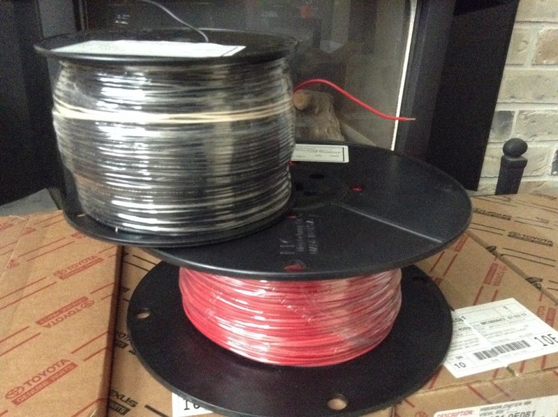

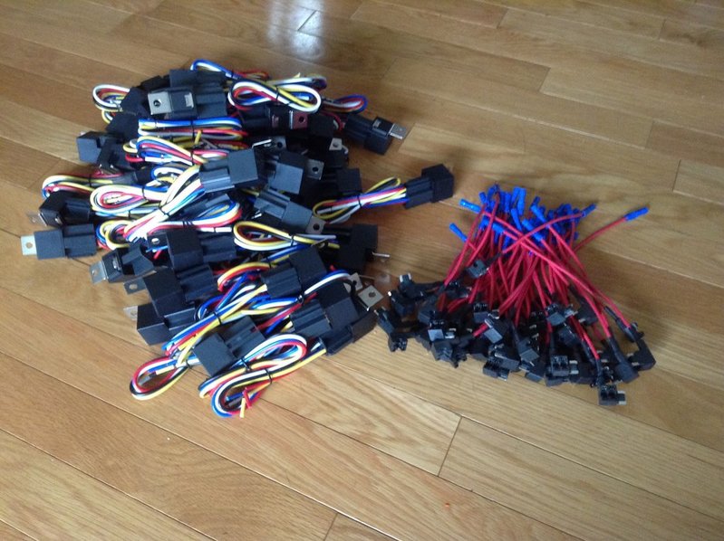

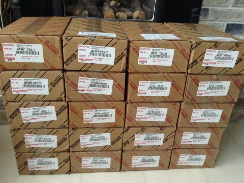

    Some supplies are starting to roll in :thumbsup:
    Relays & add a fuses
    Couple thousand feet of pure copper primary wiring :eek:
    Some mirrors for you guys north of the border :cheers::canada:
    Lots of other stuff like switches, terminals, wire loom etc. My wife has forced me to relocate to the basement to build these now lol, guess I can't blame her though.
