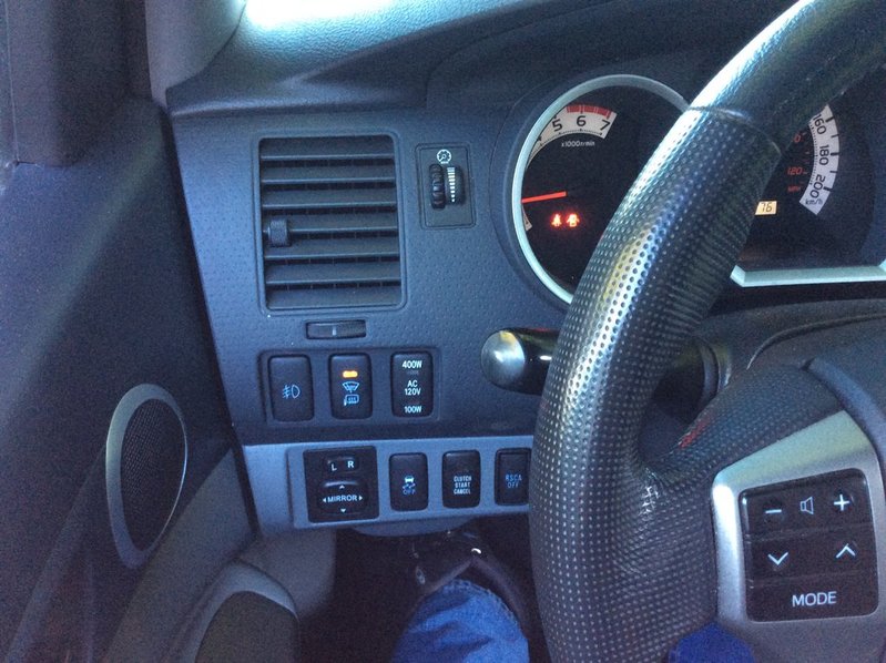

    How easy is it to put the switch to the top row of switches? Thinking about changing my location to the upper one but didnt know how to access it.

    Looked daunting at first but dig your fingers in there to route the wiring through. I thought I was going to have to loosen up the upper dash at first but just phish it up from below the switch bank.It fits fine and I took the power of the fog lamp button to light the new switch. Easy peasy!

    Look at this link, this iswhat I used to take apart the dash for thetop row of switches.
    http://www.toyota120.com/forum/showthread.php?t=3380

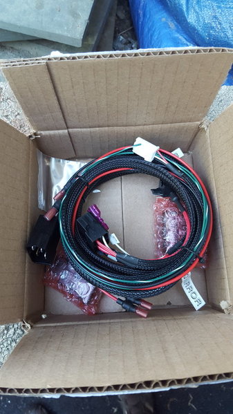

    Opened the kit up, very nicely packed. Only question is, is it supposed to come with install instructions? Only piece of paper in the box, was the packing checklist.

    Montreal, Qc, Canada
    2015 DC LB 4x4 SR5 SSM
    Instructions are available for download at the end of the first post in this thread.

    Auburn Ma
    2021 TRD Poser Pro Manual.
    Thanks found it.
