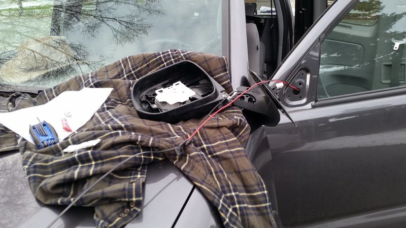

    Both mirrors in and door panels back on. Fishing the pax side is the easy one, lots more wires on the drivers side. Now just to hook and put the piece under the steering wheel back.

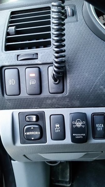

    I thought i had asked for a green switch, but no matter. I dont want it bad enough to take the dash back apart. Both mirrors are warm to the touch.

    2014 TRD Sport DCLB
    Ah cool you got it done.
    PS the status rectangle at the top is amber on all switches. It is the graphics below that can be either green or Amber when the headlights are on

    So 6:06 actual working time. Not the fastest install on record, but i didn't break anything. I ended up mounting both the relay and the switch ground to the outboard end of the metal piece pictured in the instructions. It looked like the relay would interfere with the bluetooth dongle on my OBDii connector for monitoring transmission temps on my smartphone.
    All in all totally completely satisifed. I figured I could maybe have bought all the parts for about what the kit cost, but mine would not come out as nice as the harness Jaimes already has made up, and it would have taken a TON of time to get from wire on spools to finished harness.
    I have decided to stick with the amber light on my green dash. I'll know what the indicator is just by the color.
    5/5 stars

    By that I meant the graphic of the heated mirror with the heat waves running through it

    Well there you have it. the two tiny green wires on the switch connector are a bit short to get to get to the proper leads on a switch on the lower blank from the upper bank, and getting the fog light switch out to taps those wire leads was nto happening.
    If you got room, put this in the lower switch bank left of steering wheel. I had to modify a switch hole for my OPTRAwhatever light switch, so even if I had pulled it and moved it up the defrost switch from Jaimes wouldn't fit into the enlarged hole correctly.

    The four hardest things are pulling the wires through the two boots and then at 3&4 feeding the bare wire ties through the boots.
    5&6 would be getting the new glass to snap in, the rest of it is comparable to legos if you got a 10mm socket, a #2 Phillps, a sharp pointy thing and a coat hanger to cut up.
    Edit: And a torx 25 driver, a common size.
