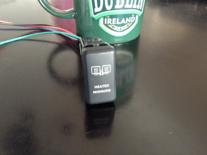

    Sounds good, just let me know when you are ready. I've actually looked into the AOB switches and still have one that I used to test out some things.
    There were a few downfalls / complications to using the switch for this though so decided not to make it an option.

    How bad were the complications? I just don't like the windshield heater button for under the AC and that's the only location option I have.

    They weren't things that couldn't be overcome... When I get home I'll pull up my notes and let you know.

    The complications I had noted are:
    1) since the are LED bulbs the will not dim as fluid as the rest of your switch bulbs... I didn't really investigate that too far
    2) the way that the switch is designed it will not have a status light on when the mirrors are heating up. There is a way to modify the switch to have the status light on but involves cutting parts off the circuit on the switch out and adding some wires and a diode in.
    3) Although the switches do light up, they are not a close match to the rest of the toyota lighting.
    Some of these things won't matter to some but I figure it would not appeal to most.
