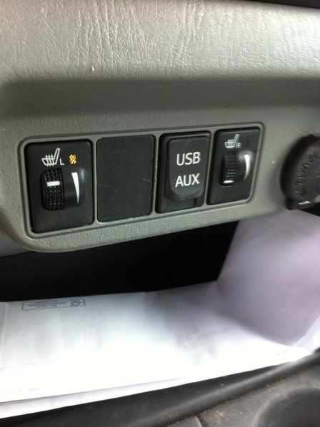

    Well if you want to go with a stock look here is what I have for mine.
    Although it was a factory option here in Canada so I didn't need to wire it myself. I imagine wiring them is likely very much like the heated mirrors where there are only two wire leads for each heating pad, one gets grounded and the other is the power in. I'm sure the switches I have likely increase and decrease the voltage going to the heaters which would adjust how warm they get.

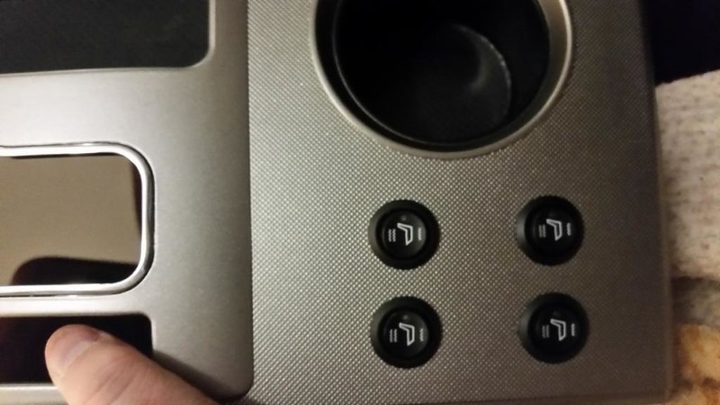

    You can do heated seat switches in the console too like these

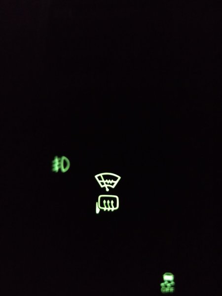

    Installed this kit last night. It's a stellar kit but I have one concern. Is there a reason I received a switch with a Tesla windshield symbol on it and not the one in the first post?Screenshot_2015-11-15-09-14-53.jpg IMG_20151115_053049.jpg

    I figured it out. Didn't realize that the timer is actually in the switch as explained on the first page.
