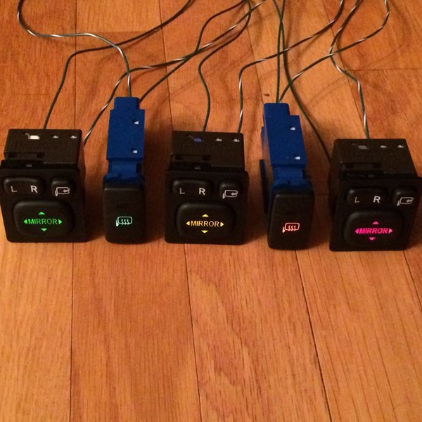

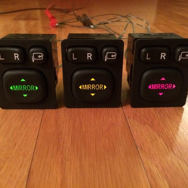

    I think your pictures came out great honestly. I'm still good with the amber switch.

    They appear good but I can tell the shades are a bit off. In the top photo the amber is fairly accurate but the green is a lighter shade and the red is a true red whereas the photo has it looking more pink.
    That being said a few pair of eyes all agreed with the description provided.

    Check the camera settings - a lot have settings for color correction, white balance, etc that may be throwing off your pics. Try turning them all off, and then play with the color and contrast when looking at the pics.

    The amber will still look good to me, because the mirror switch doesn't light up anyway. This way, when I have the heated mirrors on, I'll know it. :) Besides, mine are a green in the truck and this will be different...on purpose. Thanks for the update.

    May have to get the wifey involved for that, she has a fancy camera with way more settings then I would care to learn but it's worth a shot. I ended up posting photos taken from an iphone which for whatever reason came out the best but to be fair I didn't mess with any camera settings.
    Absolutely just let me know... it is a great mod to have if you are in a cold winter climate!
    Hmm Toyota Christmas tree lights I like it lol. On the amber I think the only people it may be an issue with are the ones who would like it to light with the headlights on. It's not obnoxiously different but it is a lighter shade.
    As I said I'll need to try lighting them up in the middle of the day in the sunlight to make sure they are actually visible otherwise they wouldn't be too useful as an indicator light. Unfortunately here it is already dark by the time I'm off work so I'll have to save that check for this weekend.
    I think that is pretty much the last detail to wrap up on these and then should be set to get a larger order placed to cover off the options you guys want. Of course once I have the last few details ironed out I'll present them and you guys can make any adjustments to your order if you would like before I get the switch order placed.
