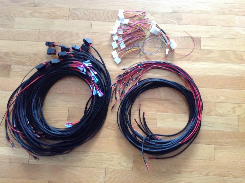

    I took some photos yesterday morning so I can get instructions done for the new kits. Also sent a message out to anyone who ordered a green switch since those orders can go out now. At this point there are two of the new kits installed and functioning just fine along with a bunch of testing I did on my end. Glad to report that everything on the new kit is functioning great!
    Also theses harnesses are well underway to being complete :thumbsup: (Excuse the crappy photo quality)

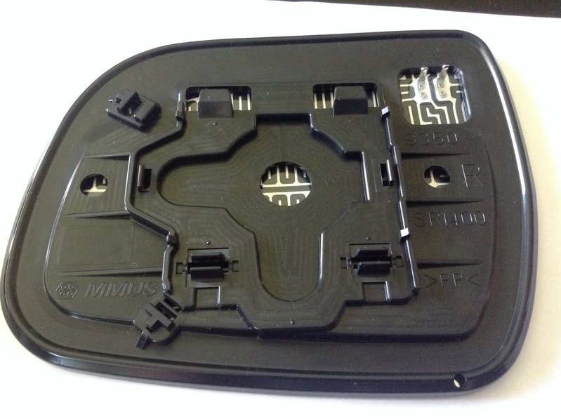

    It might be worth double checking the are seated in properly. The top two tabs on the backing plate are hooks I guess you could say to hook around another piece and the bottom two tans just use compression to secure themselves. I imagine if one of the upper hooks wasn't properly in place it might distort the mirror.
    They are direct replacement but with heating strips so you really shouldn't see any change at all.

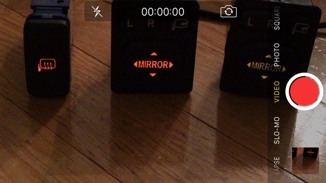

    The LEDs came in today so I went ahead and changed them out on one of the switches. It was certainly a chore to solder them though. The switches have 2 LEDs and both are around half the size of a grain of rice.
    Picture is still a little off of a true representation but not horribly bad. In person I would say the colour match is a little better than what the photo shows. If I had to give my best judgement I would say the mirror adjustment switch is just slightly brighter than the other dash switches in 05-11 tacomas but the colour is a match. Its close to the point most probably won't notice a difference unless looking for it. It's a huge improvement compared to just leaving them the yellow / amber colour that they come stock.
    Left - amber found in 05-11 stock switches
    Middle - modified switch to colour match
    Right - non-modified switch (more of a yellow than an orange)
    If you anyone wants it converted over to a colour match amber it can be done for $20. That's not so much the cost of the LEDs but the time involved to do it. If you happen to be good at soldering SMDs and would rather do it yourself then I can include the LEDs at no charge.

    You can put me down for the modified amber if you're doing it for the heating only option. This way I'll be sure to see when they're on. Besides, what's another $20. :)
