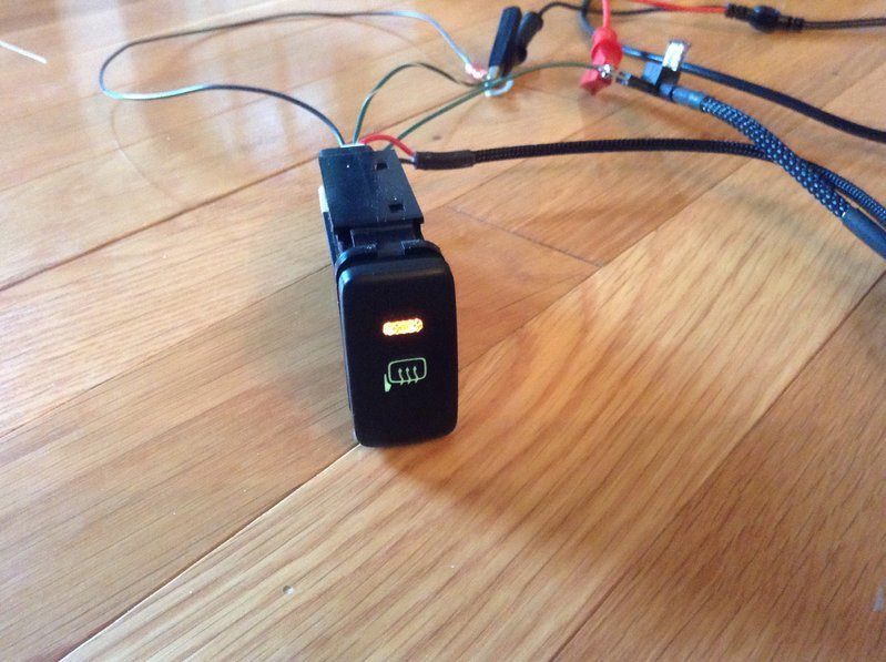

    I am in the final stages of assembly / installation. I installed the switch to the left of the steering wheel, but only have a clutch cancel button on this panel (basic MT truck). The Clutch Start Cancel switch is an illuminated typ. However, the wire colors do not match that of the the instructions so I wanted to make sure before doing something incorrectly.
    I have matched up the solid green wire to the green wire feeding the switch, however, there is not green wire with a white stripe on this switch for illumination.
    Does anyone know which wire I should tap into to complete the illumination circuit?

    I don't have a manual transmission so maybe you can confirm for me if that switch specifically lights up when the headlights are turned on. If so does it also dim when you adjust the dimmer switch? If not then you will just need to tap into a different switch that meets those criteria. The green wire is +12v and the green with white is the variable ground which controls the dimming of the light.
    You technically could just ground the green with white stripe wire from the harness and the switch would then light up but could not be dimmed. Better to locate one of your switches that has the correct wires (any switch that is on the dimmer circuit).

    Clutch start cancel is only illuminated when it's activated, it's not on the dimmer.

    Ah that would explain the lack of dimming wire hooked up to it. I shot him a PM with some alternate suggestions on where to hook up
