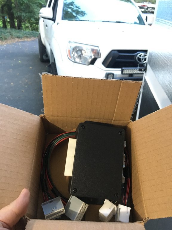

    2Low module arrived today!!
    Pigpen likes this.

    I installed it tonight in 10 minutes!
    Works exactly as expected!
    I will add that I had previously performed the DPDT relay for the "Locker Anytime" Mod which uses the same wiring harness as this module and I had already installed the "ABS Kill Switch" mod and this 2Lo Module works perfectly with both either on/off or whatever. 2Lo works regardless of the others mods status or vice versa.
    Great Job Jaimes!!!!!
    Very Happy Customer!!!
