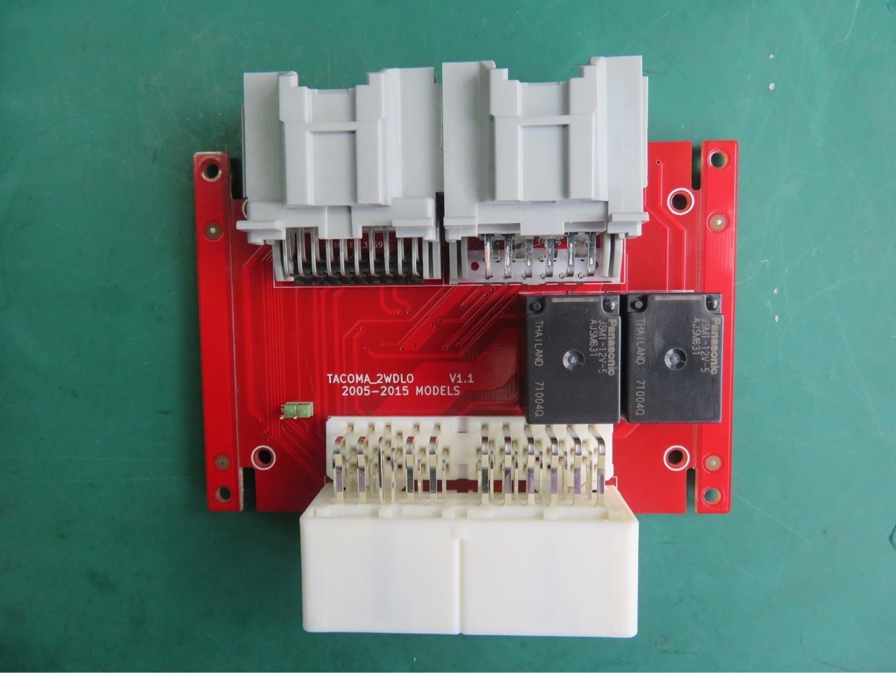

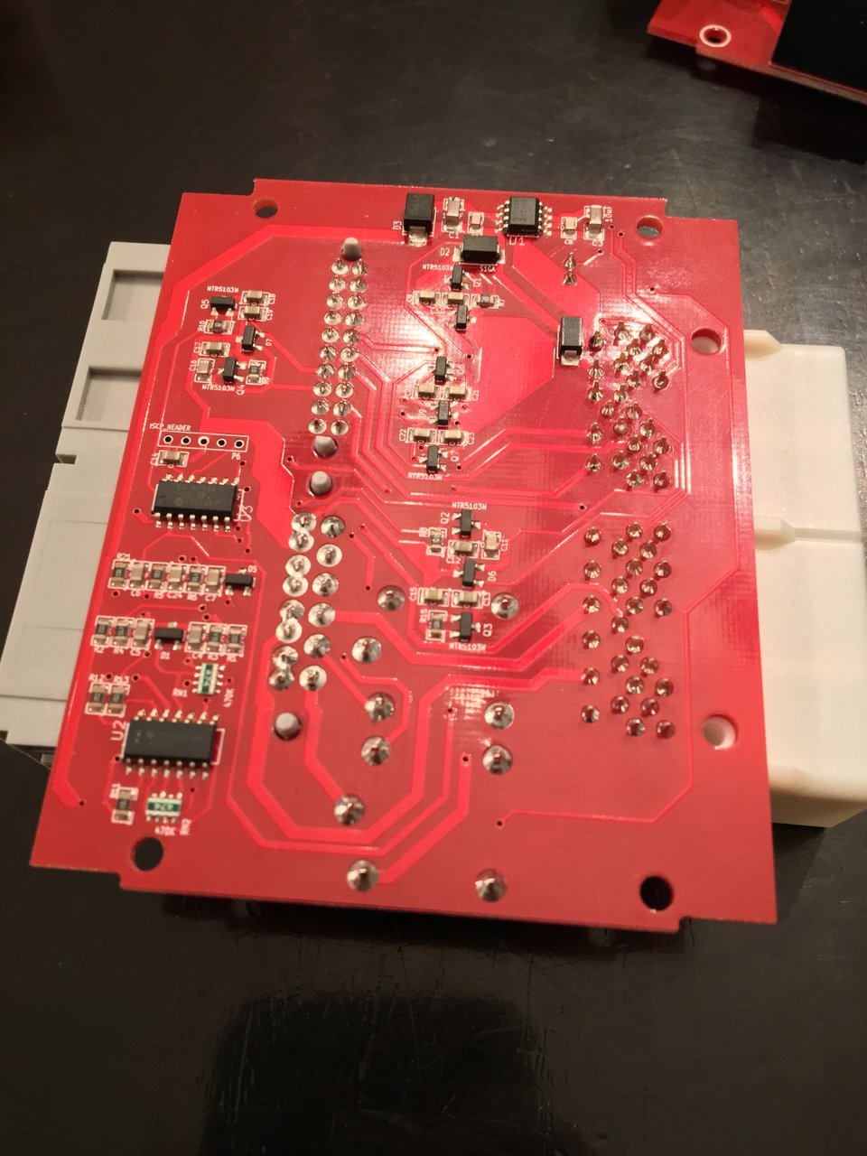

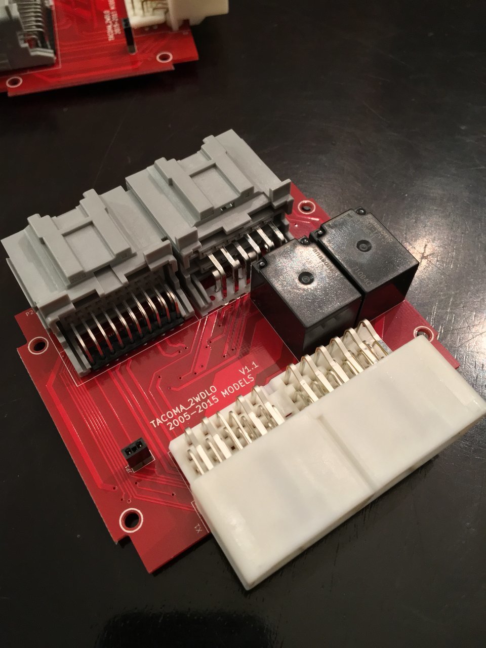

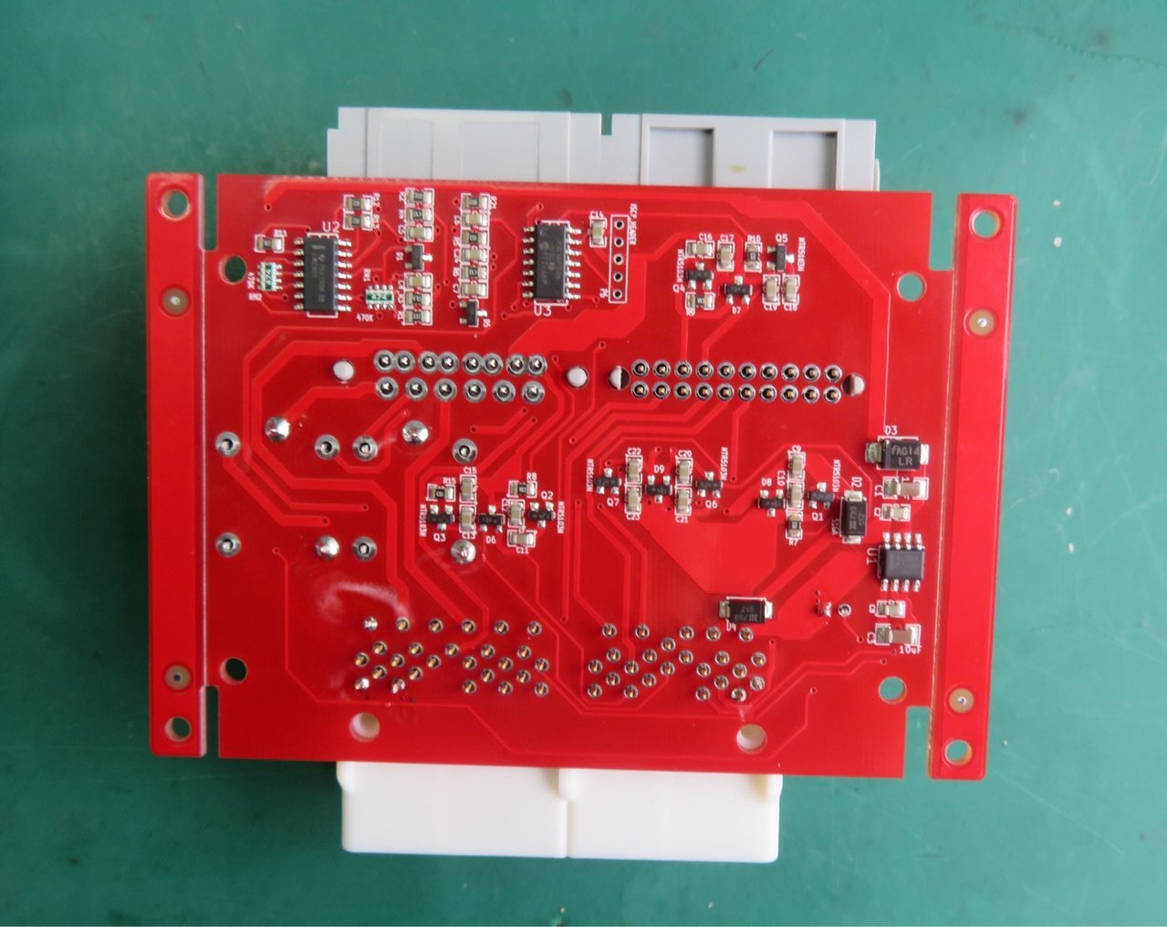

    Just a quick 2lo update. Although I don’t have the PCBs in hand yet, the new assembly company has sent me a few photos. My initial thoughts are that the work looks good, but I’ll have to wait until I can inspect them in person.
    Here are a couple pics

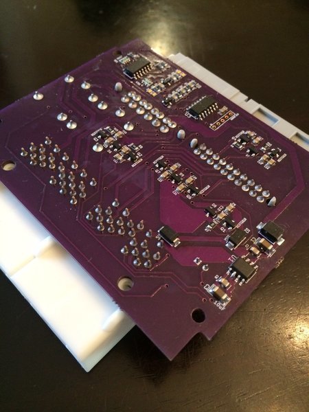

    As a comparison here is the first batch that I made. Had to use Up2NoGood assembly Ltd on the initial batch so they are somewhat of a limited edition (don’t plan to hand assemble them again lol)
    Provided everything checks out good with this small order I’ll move right into a larger order. I only ordered 5 or 6 to first confirm the assembly quality.
    I’m going to be leaving on a holiday right after Christmas so I won’t be able to check out the new boards until I get back in a couple weeks. They should be sitting here waiting for me though :thumbsup:

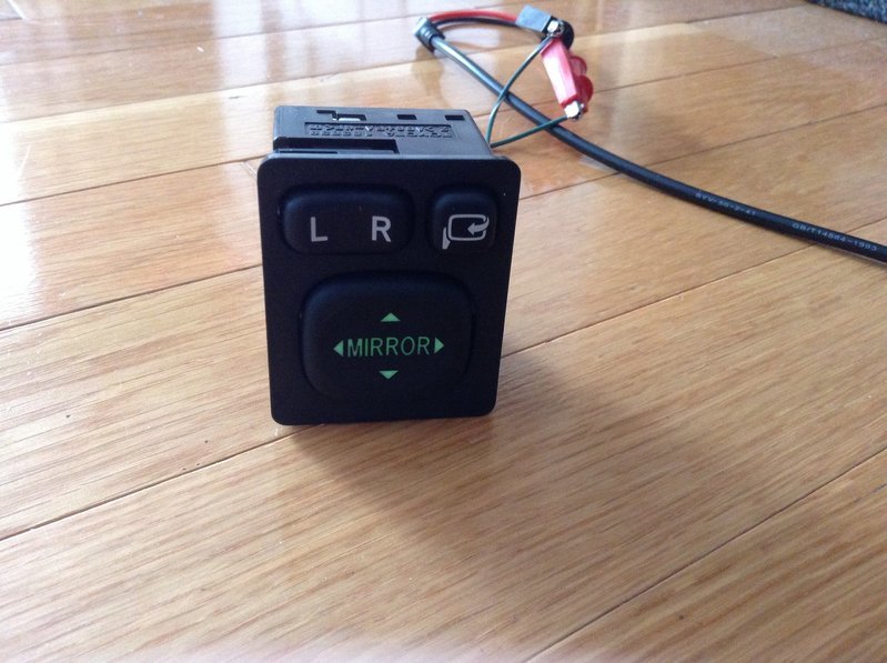

    Question: for the mirror adjust option w/illumination - are all controls illuminated? Unlike the stock switch which isn't obviously.

    Sorry for the delay in getting back to you. I’m out of the country on holiday right now and haven’t been checking in to frequently. The area that illuminates is the “mirror” button and four arrows as shown in the pic below. The other buttons don’t have any transparency so the can’t be lit up.
    G.T. likes this.

    If you are like me and have plans to add other switchable upgrades later go for the mirror adjust switch option. Takes up no additional space and works perfectly, been using mine allot as of late and they've never let me down.

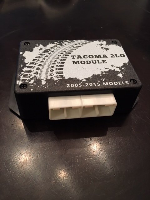

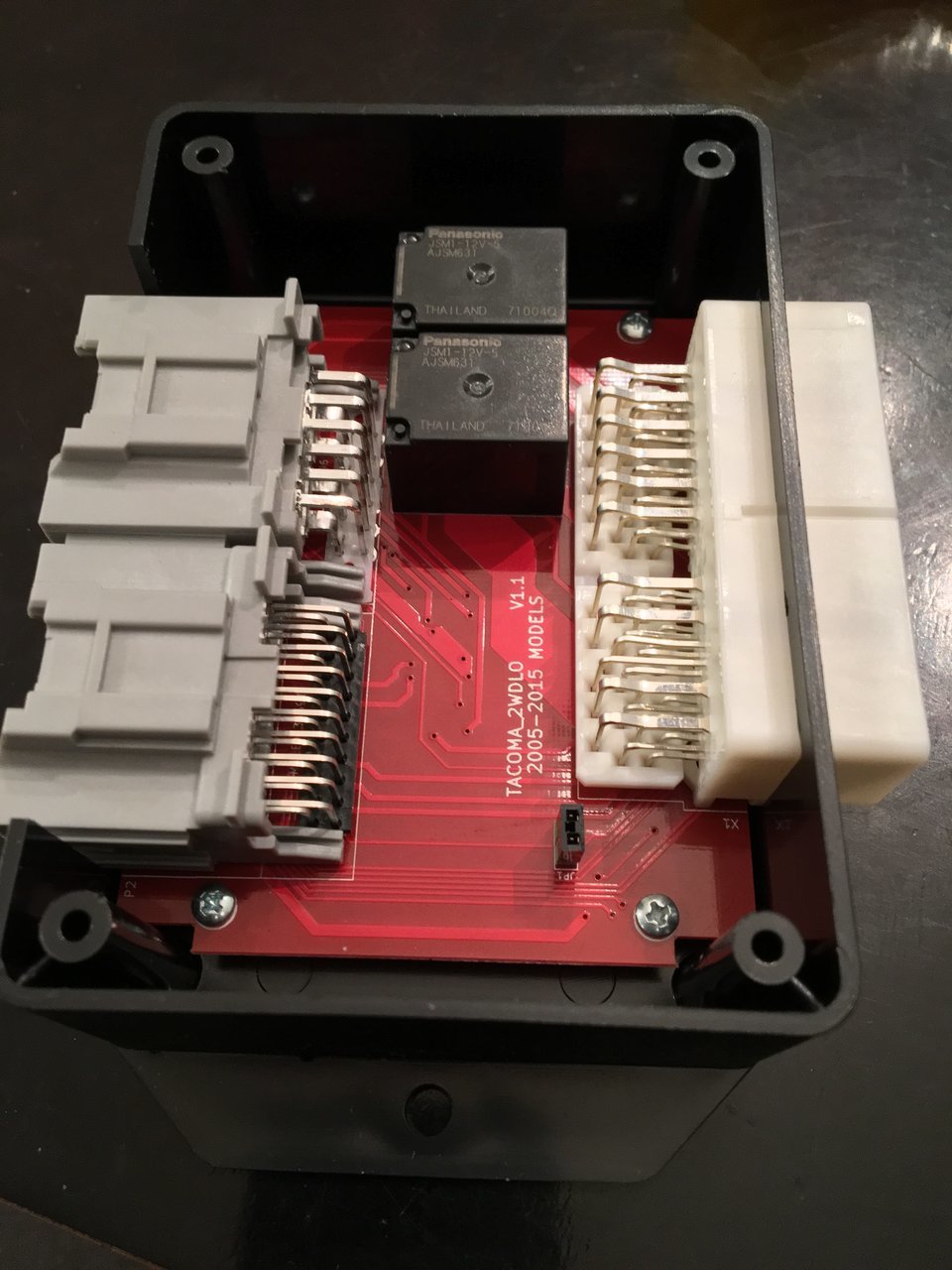

    2lo Update

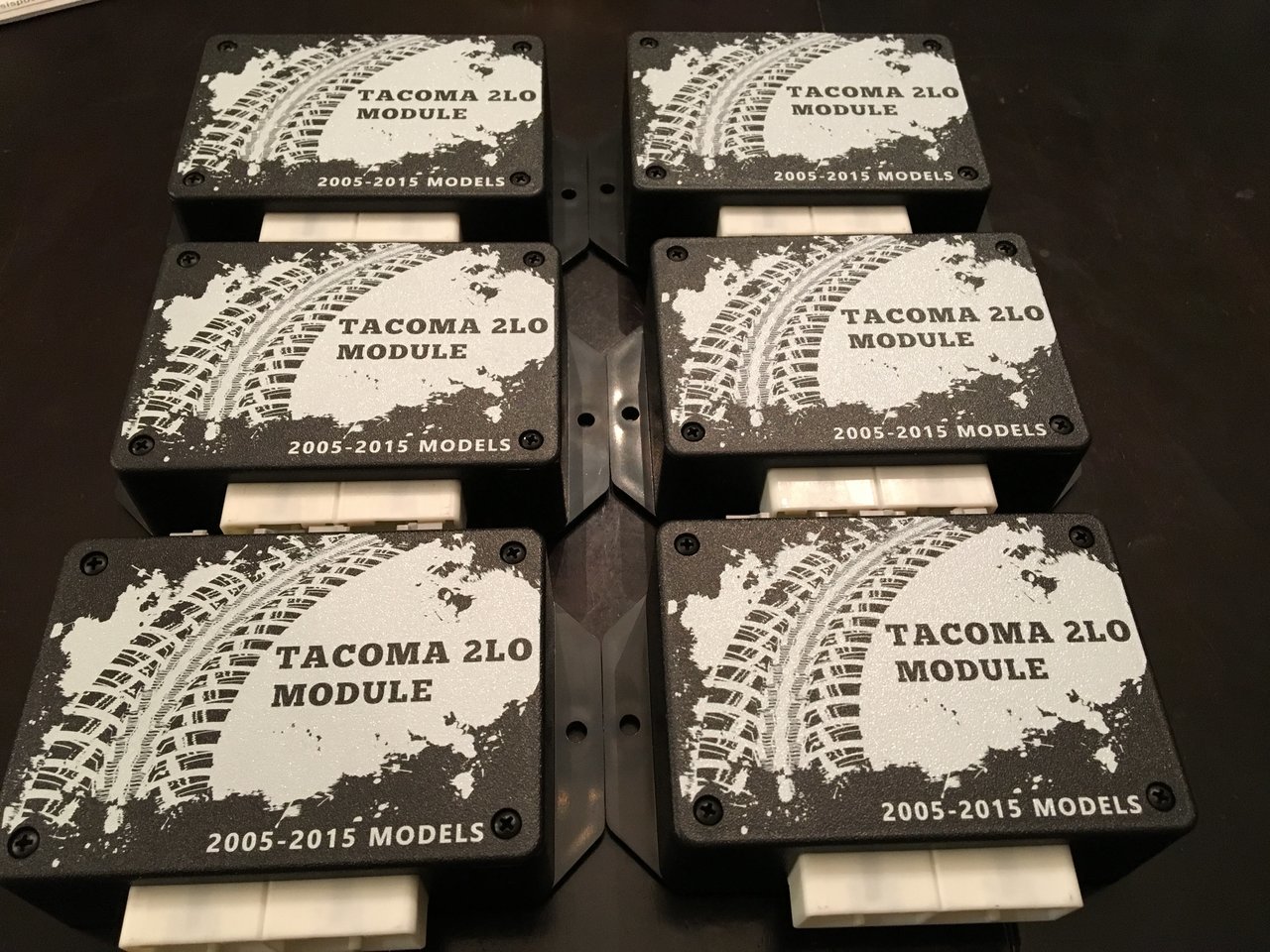

    I've received the boards from the new assembler and everything looks great! Had a very good look at the solder joints, made sure the components used were the ones I specified and of course programmed and confirmed the functionality of the units. I was probably being overly cautious but I just didn't want to place a larger order and then find out there was a problem since these things are a bit costly to build.
    I've sent out PM's to a number of people who were interested but still have a few left if anyone subscribed on this thread wants one. I'll probably be posting them up in the buy / sell section later tonight.
    Cost is $250 US which includes:
    - PCB
    - Custom Enclosure
    - Wire Harness
    - Shipping within Canada or US
    Payment accepted is mailed check, postal money order, cash or first born child ;) ... No PayPal on these as the suppliers I'm using don't accept PayPal.
    If anyone would like to order just send me a PM or post in here etc.
    Pics below
    FD08AC98-EF6F-4DD5-8D70-B359DE00864C.jpg DAE71823-F240-4629-86A5-57E6A7AD3A3A.jpg F89E2AFA-64A5-4B4A-884C-FF0DAA8850A8.jpg 859877CA-B7EC-4DAB-A481-E2CABA29B199.jpg

    Btw, I think I found OEM Suzuki heated mirror switch that looks like it would fit in the below A/C location. Will verify and update.

    @Up2NoGood Hey Jaimes, I've got one of your mirror kits that has the left of steering timed switch and I'm interested in changing over to the mirror adjustment switch to free up the dash slot. What's involved in the change and how much would you want for just the switch and any bits required to get it to work?

    That's the switch I have, well worth it to free up another space

    I guess it would depend how you do it. Unfortunately those are two very different kits but here is what I think is possible:
    1) It wouldn't be too hard to set up in such a way that when the mirror adjust switch button is in the in position the mirrors heat and when it is in the out position they don't. This is a bit of a trade off though since you would be giving up your timed auto shut off option in exchange for an easy conversion. There would of course also be the risk that if you forgot the switch in the pressed in position then the mirrors would be heating all of the time until you noticed it.
    2) It could be wired up with a TDR timer relay that would trigger the standard DPDT relay that you have with the left of steering kit. With that option you would retain the auto shut off feature and also the cancel feature if you wanted to shut off the mirrors before it timed out. The downfall on that option being a bit more wiring and parts needed and also adding in a additional point of possible failure since you would be needing 2 relays to do what should really be a 1 relay job.
    You've already purchased a kit once so if you really want to proceed with one of these options then I'll just sell you the parts at cost and no charge on my time etc. It won't be overly cheap though, just adding the new switch, relay & shipping and your north of $100 at my cost.
