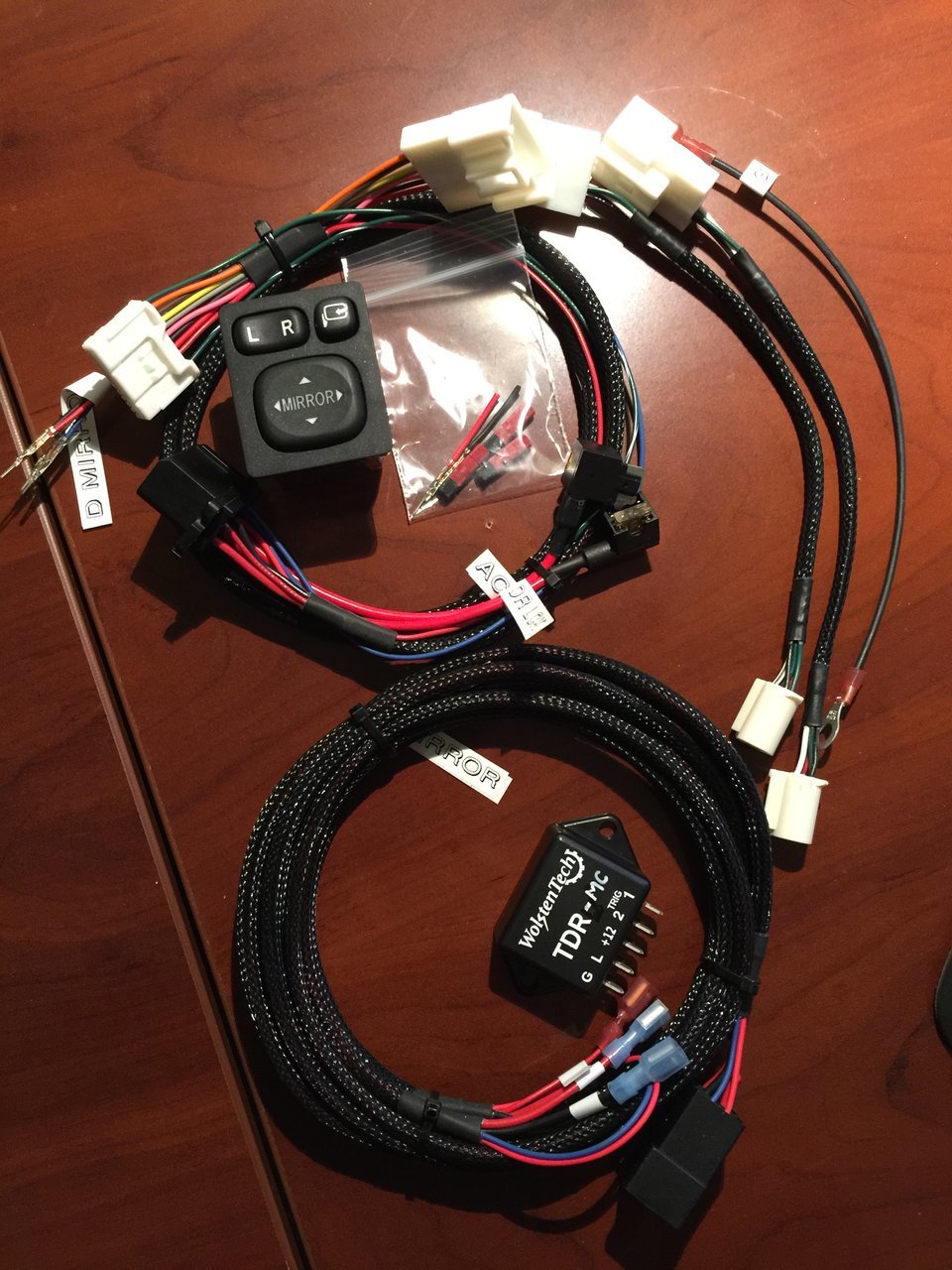

    I have the discontinued kit with the 15 minute timer built in. That probably changes option two a bit. I'll think about it and let you know. I wasn't thinking it would be that pricey, but thanks for getting back to me.

    Order the new kit with what you want and simply pull the old switch and wiring. Once out, sell it here in the B/S/T section. It will sell, I know this because that is what I did and mine didn’t last three hours after I posted it.

    Option 2 is still valid. Both the 5 and 15 minute options for left of steering have the timer built into the switch itself.
    The cost is certainly not cheap. One area you could save a lot of money is on the switch itself. I use genuine Toyota parts with the kits, but if you are okay with aftermarket I think you can pick up a similar mirror adjust switch for only around $10 - $15 vs OEM around $75. The TDR relay is about $35 which would be needed on the second option. It starts adding up pretty quickly!

    Even on the nastiest days here in northwest Montana very near the Canadian border, I find no need for the 15 minute switch. 5 minutes is more than long enough on the worst days. This kit is awesome. I have the 15 minute switch and find myself manually shutting it off almost every time after 2-3 minutes. Sometimes I forget and realize my clear dry mirrors are being heated unnecessarily 10 minutes later.

    Up2NoGood can make you a harness so the 4Runner mirror swap and heated mirror mod are all plug and play. I bought one and it's my favorite mod to date.

    Sadly the switch is a little bit too tall.

    I was wondering... how about relocating the VSD/Traction control switch to the center console using a Highlander switch to free up space for the OEM heated mirror switch. Could be an option for TRD O/R folks without blanks on the left side of the steering wheel. Would make sense to locate it right to the A-TRAC switch actuaally.

    It would require a custom harness to do 4Runner mirrors. I’ve done a few but they are a bit more work and materials to make it a click together integration.
