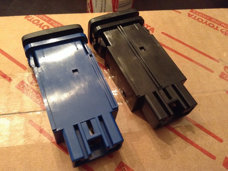

    So this afternoon I had a chance to help a friend do his install and documented it with pictures. I'll be using them to get some instructions written up. Unfortunately with this one we hit a couple of unexpected snags both right at the end.
    The first was with the left of the wheel 5 minute timer. This particular switch is the only one I hadn't personally installed and as it turns out there is a minor fitment issue.
    On the left is a 5 minute timer and on the right is a 15 minute timer. The 15 minute timer goes in no problem but the 5 minute timer has a raised piece on the right side of it as you can see from the photo that is not present on the 15 minute timer. The raised portion is around 1/16" high and there is no slot in the switch hole to clear that. We were able to get it in with some force as the hole was able to deflect around it but it wasn't all that easy. We ended up pulling it back out and just sanded off that 1 raised edge and then it slipped in no problem.
    So for all you who have ordered the 5 minute option do you want me to ship as is knowing it could be a very tight fit to get it pushed in, or would you like me to take that raised edge off in advance?

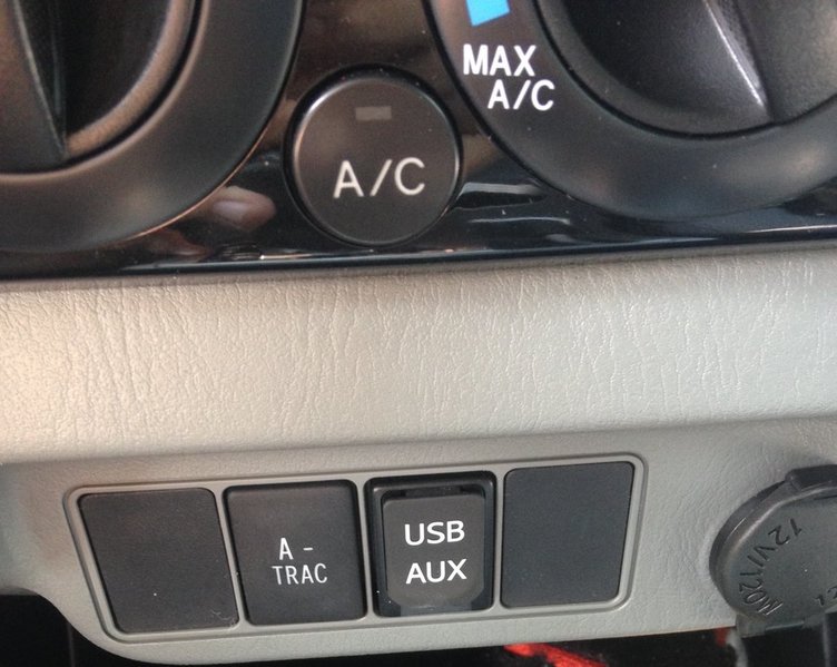

    My son was nice enough to take some pictures of the dash while I'm out of the country. It appears I have no blanks on the left, so below the AC it goes. Amber, 15 minutes.

    Although I could do it myself , I do think that if you are going to market the kit as basically drop in , it would make sense to prepare the 5 minute switches ahead of shipping

    No disagreement there. Some people may be hesitant to have that sanded off on a brand new switch, but in reality that entire area is tucked behind the dash and is causing issues for it to simply push right in like the 15 minute switch. I've got no problem taking that small ledge off though.

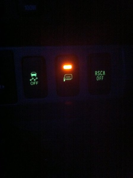

    Is this the green or amber? I know it sounds like a stupid question but it seems like both colors are there and just wanted to confirm as color is the only thing I am debating

    Sorry, Left of wheel / 15 min timer / amber

    That particular switch was green illumination. Check out below for a easy distinction between the two colour options.
