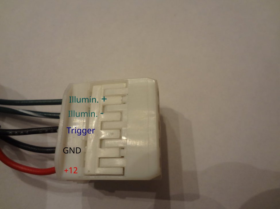

    @Up2NoGood
    thanks for all the clarification,
    I am Trying to understand the wiring here, is the relay for the Left-to-Steering-wheel switch setup triggered to activate the ground signal ?
    I am not confortable having a permanent +12V running through the door to the mirror to be honest, any chance of switching through the Positive +12V
    Do you mind sharing the switch connector connector pinout for the left side switch please ?
    am I getting it right here :

    Can anyone please tell me if the wiring setup in the above picture is correct.
