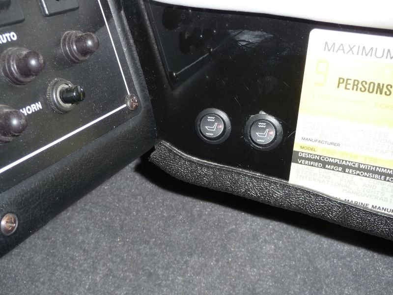

    The rounds that you reference (if they are the same ones I use) have a small tab on the side of the barrel. I trim that off and then drill 7/8" dia. The switch will fit much easier and will indeed stay in place. All of that said with the caveat that the same round switches either go in a blank insert for fit or a stand alone surface.
    With your choice of kits, make sure the kit provides four pads (two seats).
    Here is the last set I used this past summer.

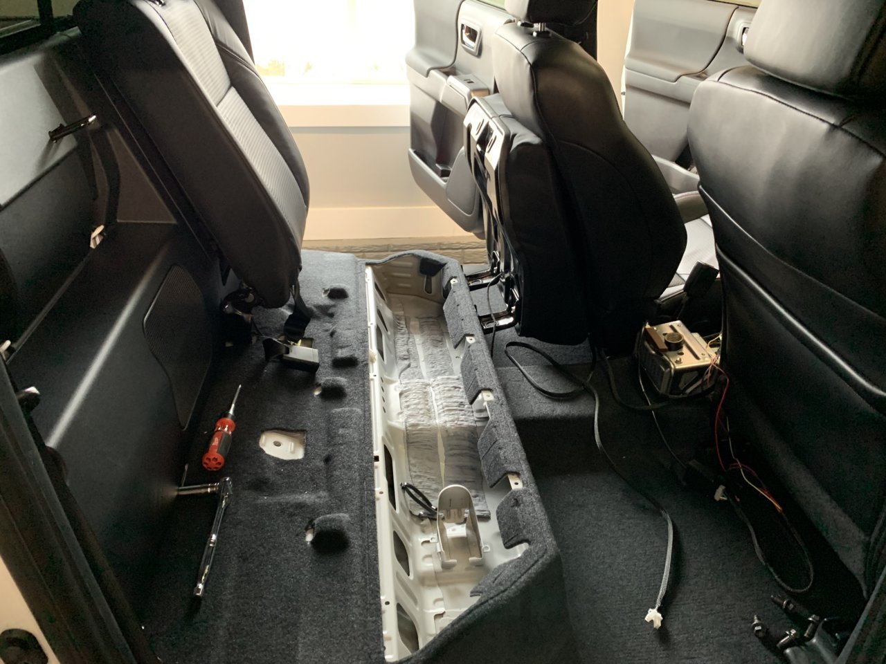

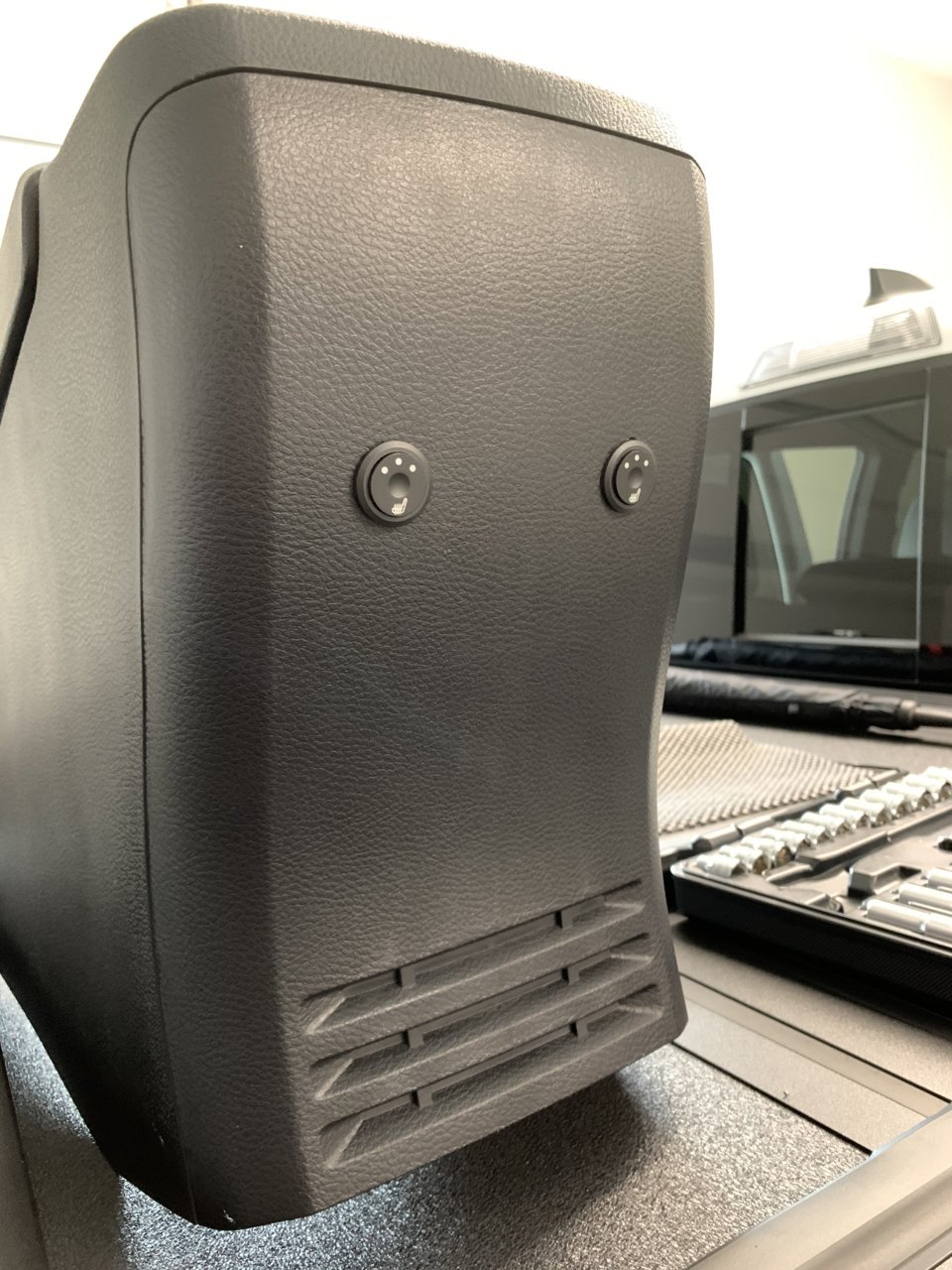

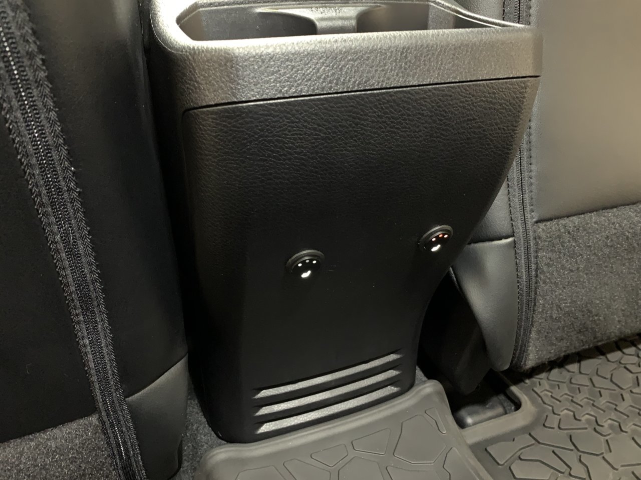

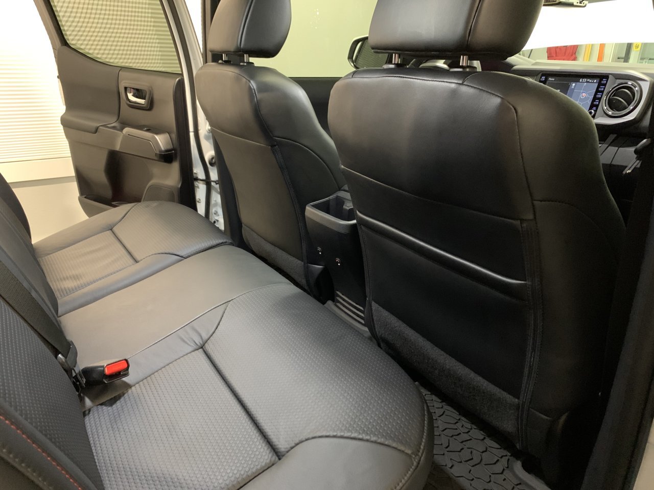

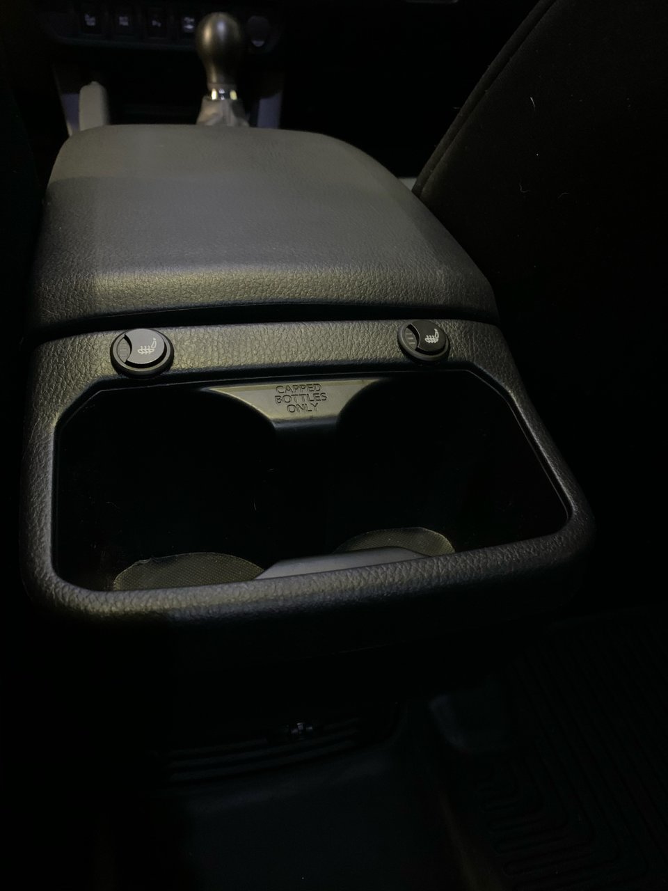

    Well I pulled the trigger and ordered a seat kit from Amazon. I was able to get it installed this week. I’m happy with how it turned out. Now I’ve got option for 4 toasted buns!
    Applied some 3M spray adhesive to help hold them in place.
    Routed the wires under the carpet, into the underside of the storage tray and then along the transmission tunnel under the carpet up to the center console.
    Drilled out holes in the back of the center console and installed the heater controls. I was able to affix the relay and control board in the space under the rear cup holders as well out of sight.
    Tapped into the 12V for the center console for power.
    After testing and cleaning up all the wiring with shrink tubing and 3/8” wire conduit I got the cab put back together.
    If you have any questions let me know bid be happy to answer if I can.
