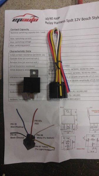

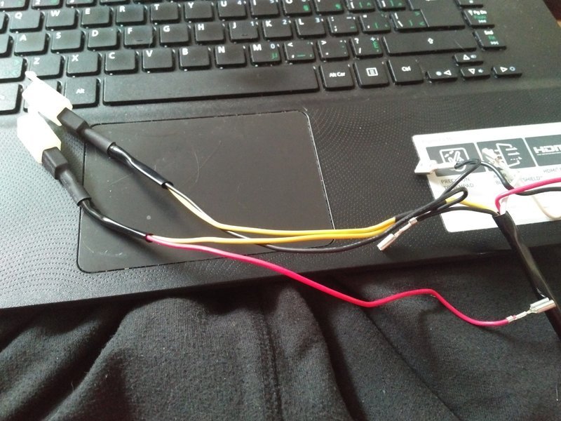

    Ya your probably right, Im just being lazy and finding it hard to understand the simple basics of doing the install.
    I just dont understand still how to hook the relay up because its the 5 prong type like this picture. Also here are the two seat heater plugs and they have yellow wires running from them. Its confusing. It runs to the switch

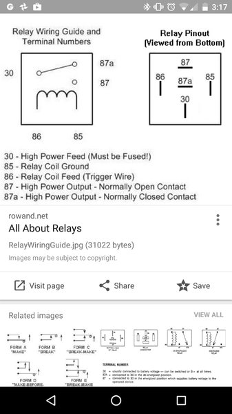

    Try looking at this pic instead...
    I did not remove the shrink tubing on the relay connector on my install. However I can tell you how it's wired by the way it's operates. I had 4 wires to connect in order to make it work. Main power, ground, key on, and illumination.
    Main power was run to the fuse box and an add a circuit used to tap a feed.
    Ground wire was connected to bare metal under the dash.
    Key on was tapped from the cigarette lighter
    Illumination was tapped from the lighters light.
    When I hooked up the key on, the relay clicked. That's number 85 or 86 on the relay, with the remaining terminal going to ground.
    This tells me that this relay is feeding power to the switch that turns the heat on and off through terminal 87. The main power is connected to terminal 30. 87a should not be used.
    Hope this helps.

    If you decide to wire it up to the battery just follow the diagram I posted last week. Stick a piece of heat shrink over relay pin 87a since it isn't needed for this circuit.

    Ok makes sense, I was like wtf goes to that one. Shouldnt be hard to cover it with the plastic thing already there. Do you know what the hell they have going on with the yellow wire from the seat pads to the control?

    If red is hot and black is ground on the harness then the yellow is probably the connection between the two heat pads (similar to connecting two resistors is series since each heat pad is essentially a resistor). One thing I'd suggest you do, since you don't have the schematic, is trace where all the wires go and draw a picture of the circuit. It will probably make more sense to you once you have a diagram.

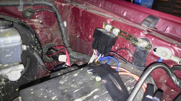

    I ran 2 additional relays that are triggered by an accesory circuit, 12 gauge wire runs from relays to seat heaters. When i did the wire sizing, they want the distance from battery to seat heater and back to ground. Came between 14 and 12 gauge. Can take pics if interested.

    So this is how i went about wiring my seat heaters. I have hi/off/low settings on the seat heater rocker switch, high draws just 5-6 amps and low is about 4 amps. I mounted the relays and tied the grounds together (pin 85, black wires). For me the blue wires (pin 30) were power off the relay so i ran each to a 10 amp fuse that attaches to the battery. The yellow wire (pin 87) off each relay supplies power to the seat heater so that goes to a 12 gauge wire i have running through the harness grommet, i follow the ebrake cable path and connect to the seat heater power (that comes off the seat heater relay). I tied the white wire (pin 86) together and this goes to a 16 gauge wire that is connected via fuse tap in the accessory space (ran through grommet). Red wire is just taped and not use (pin 87a).
    So power comes off battery, through 10amp fuse to relay mounted by battery, then ran inside vehicle to 10amp fuse of seat heater power wire (which then goes to seat heater relay then to seat heater (if you were to follow the path). Seat heater also has its own groun that i have attached by the ebrake mounting cable (pull back carpet).
    Doing it this way ensures you will not overload any circuits and you will not kill your battery as the relays are switched power from the accessory fuse.
