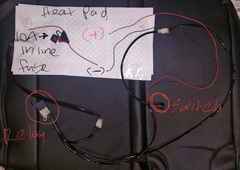

    There are lots of ways to wire this up. Some methods carry less risks than others. If it was my vehicle I wouldn't do it that way since you're dependent on whatever else is also drawing current on the tapped circuit. In my opinion a dedicated circuit is the way to go for a seat heater install. Granted it will take a lot more time to wire it up but will significantly lower the risk of something going wrong (as long as you use appropriate wire gauge, connectors/splices, etc.).

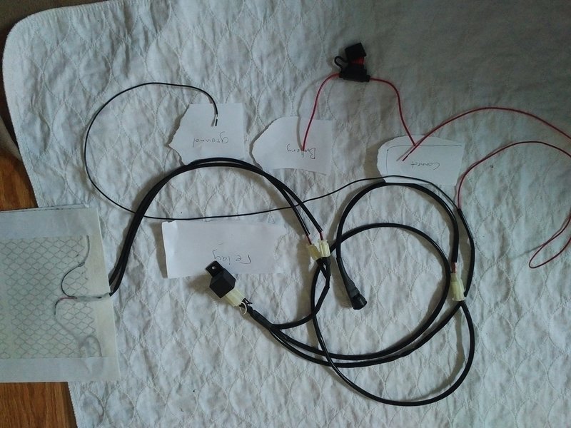

    I don't think it needs to be as complicated as the diagram. Here is the harness and relay. Looks like the switch and the power/ground wires come from relay. I figure I can wire both passenger and driver (+) together and run it to the add a circuit.

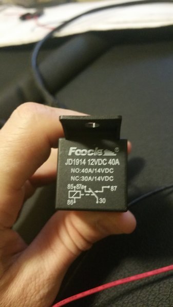

    And relay

    Looks right to me. The harness takes care of the relay connections, all you need is power from the battery and ground.

    A relay is a switch for high current. The switch you press with your finger controls a small current that turns the relay on allowing the relay to supply the much greater current used by the heater. The fuse protects all the wires behind it from shorting to ground. If a short occurs the fuse blows instead of the wire(s) overheating and causing a fire. The red wire is in two pieces because firewall. The red wire from the harness goes through the firewall and connects to either end of the red fuse wire. Other end of the fuse wire goes to the battery +. Battery - is the best ground but it's common to connect to the frame or chassis as long as you ensure bare metal to bare metal contact(no paint)
