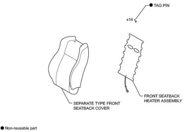

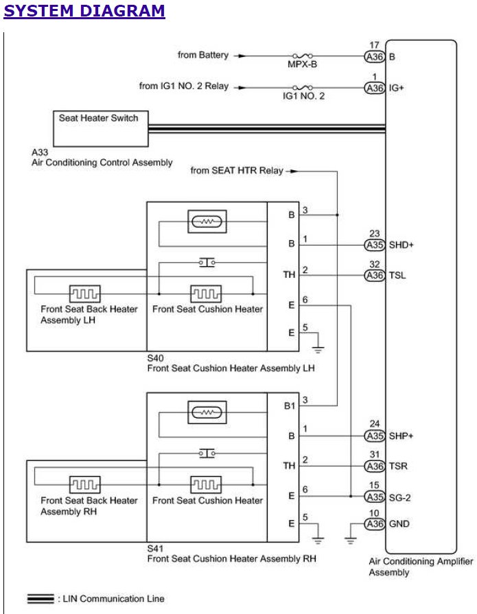

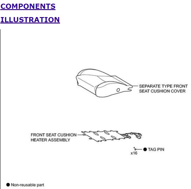

    Is the seat back even heated? I have heated seats but never use them. But I was pretty sure that only the seat cushions are heated, and that's all I see on the pdf that @ktbell444 posted.
    EDIT: Nevermind me. Caribe's diagram proves me wrong. But like I said... I never use the seat heaters :anonymous:

    If you look closely, the heat sensor is part of the seat pad, not the back pad.
