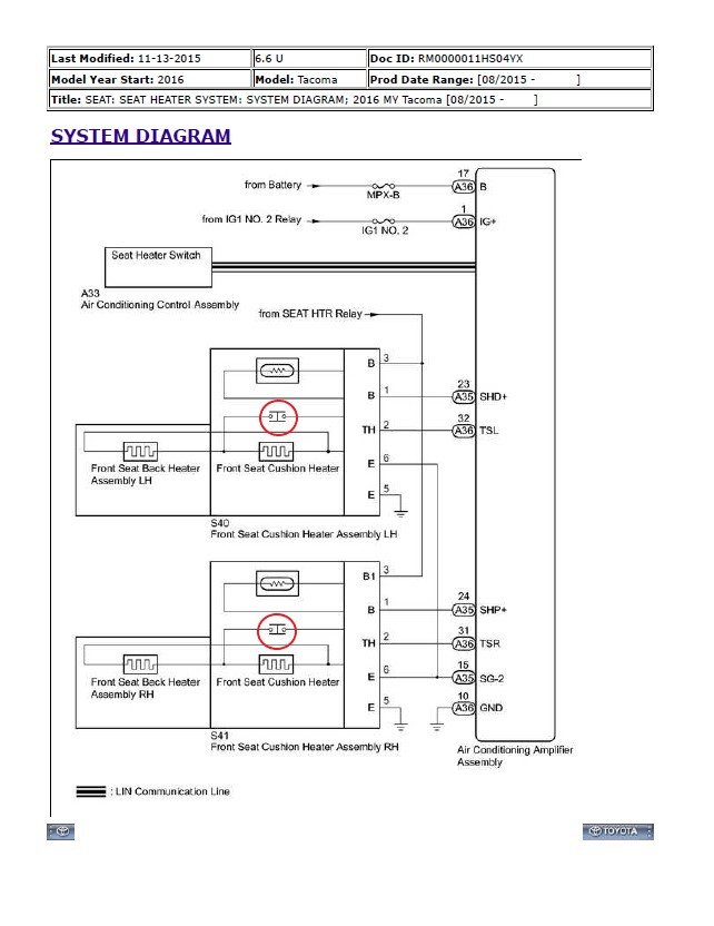

    I have a feeling that heated seats, especially ones similar to those in our trucks (they get hella toasty) would draw far too much current to be safely used with the vehicle turned off.
    Also, the seat warmers only activate when they sense someone sitting in them, therefore a remote start does not really solve that problem other than just generally warming up the inside of the truck. However this would be really awesome, but I think it's probably not the best idea for your battery/charging system.

    Edit: Although the diagram seems to show otherwise, the seats do indeed heat up when empty (ignition on, dash seat heaters switch on). I tried it. Time to eat crow. Yum.

    They work off the switch on the dash wether or not there is someone sitting in the seat does not matter, they will still heat.

    After checking out the service manual diagrams, it looks like you're correct. I was under the impression they were wired into the seat belt/airbag sensor circuitry. But it also appears the heating elements have fail safes for overtemp/no temp change/no signal from the seat temperature sensors.
    Would seem pretty dangerous/inefficient to have an unmonitored resistive element just running without a heat sink (your body) but wouldn't you know it, it seems those Toyota people might just know what they're doing!

    I just saw your edit
    MOC221_
    I too tested this today, nothing on the seat and the warmed up nicely, but this is what im trying to avoid, i'm surprised that they are not connected to the Air bag on sensor.

    When you look at the diagram though, the cushion/seatback heater elements are wired in parallel with that "switch" component tied to both before being tied to a return path (presumably). It doesn't work the way the diagram portrays, as we now know.
    At least there appear to be thermistors supplying feedback for temp control as you mentioned.
    It doesn't make much sense to me that an unoccupied seat would be heated, as the fabric doesn't sink much heat at all. You're just pre-heating the heaters themselves lol. Maybe it makes sense for leather :notsure:
