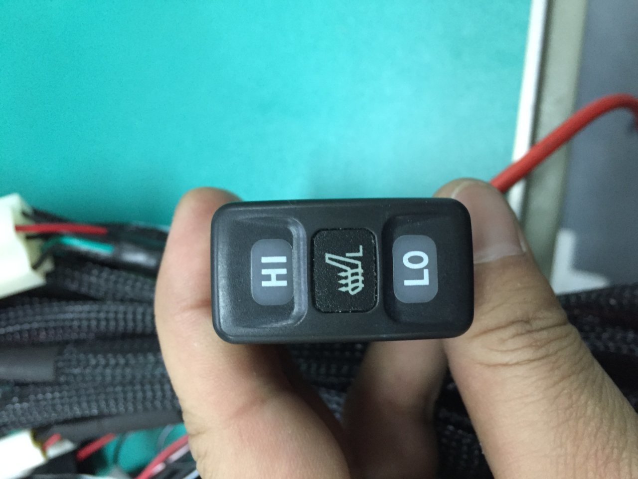

    My 4Runner console switches are from a 100 series Land Cruiser. It's a Low / Off / High rocker switch. Not a rotary switch (like in my 06 Limited).
    The switches/spots by the steering column on my 06 Tacoma, appear to be the same size.
    The heating pads were wired to function as 12V to each heating pad (high), or 12 to both (upper/lower) pad (low). The heating pads are also meant for a 100 series Cruiser.
    btw - The rotary switch method typically requires a brain box to function.
    Rocker switch method just requires relays.
