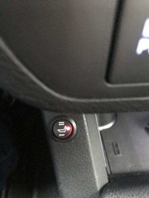

    This is the brand I have. Purchased an add a fuse and used the 15 amp auxiliary power location at the fuse box. Works perfect. Instructions specifically state to not wire to battery.

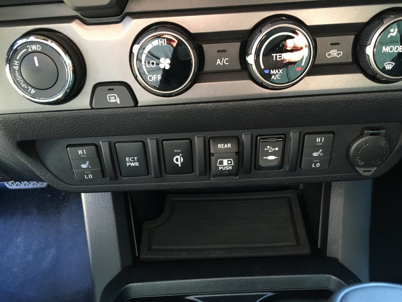

    Anybody used factory Toyota switches for an aftermarket install?
