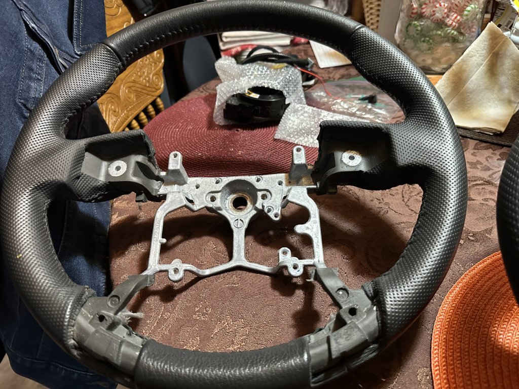

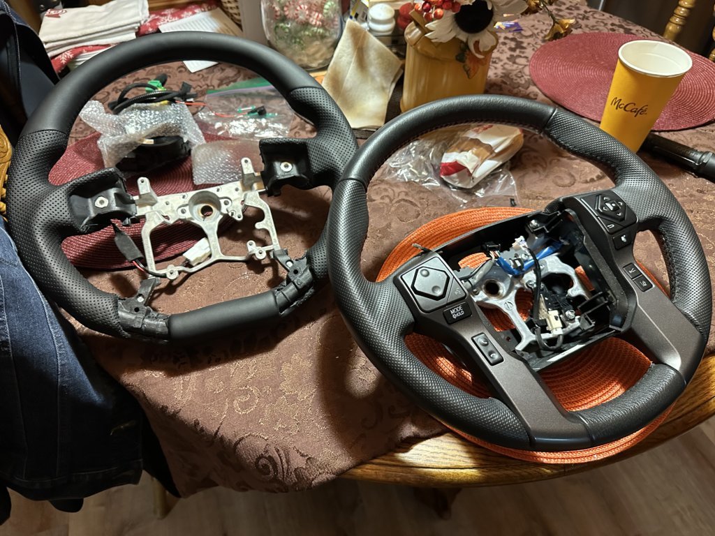

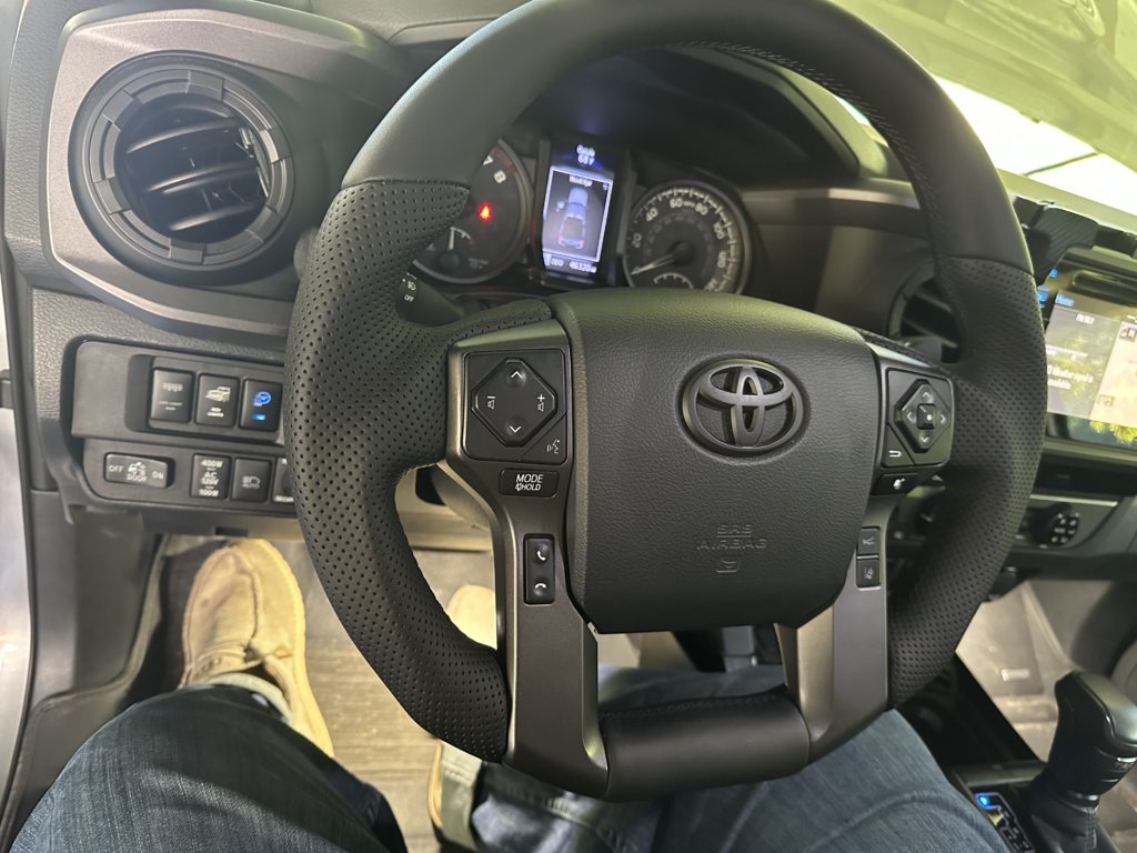

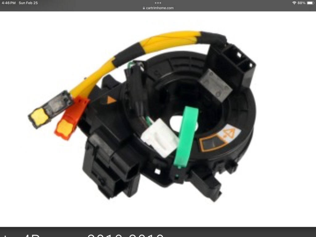

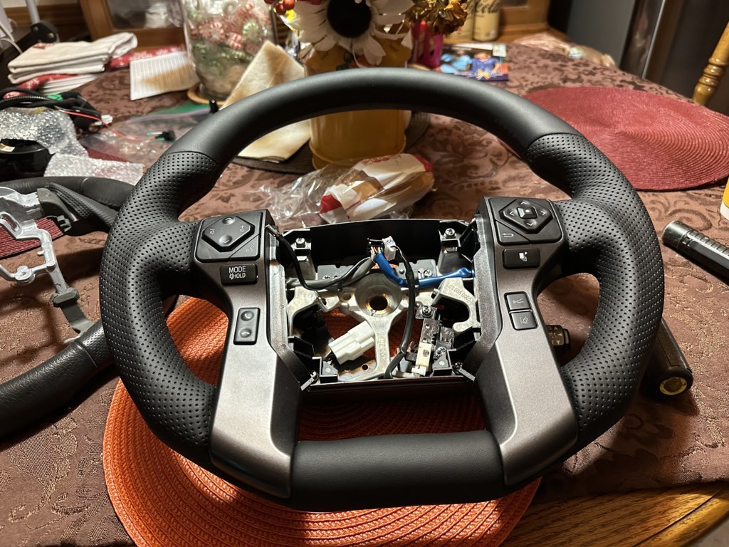

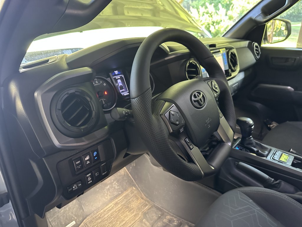

    Finally getting around to post some pics for the heated steering wheel. Been installed awhile now and no problems. It gets hotter than my heated seats, Don't know actual temp. Install was easy if you follow the video from earlier post. Just make sure the back plastic cover tabs are latched on posts for a snug fit. The heating element is all the way around wheel.
    https://cartrimhome.com/Heated-Steering-Wheel-Perforated-Leather-Toyota-4runner?search=tacoma&page=2
    The extra white connector is for the heated steering wheel

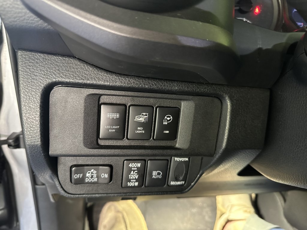

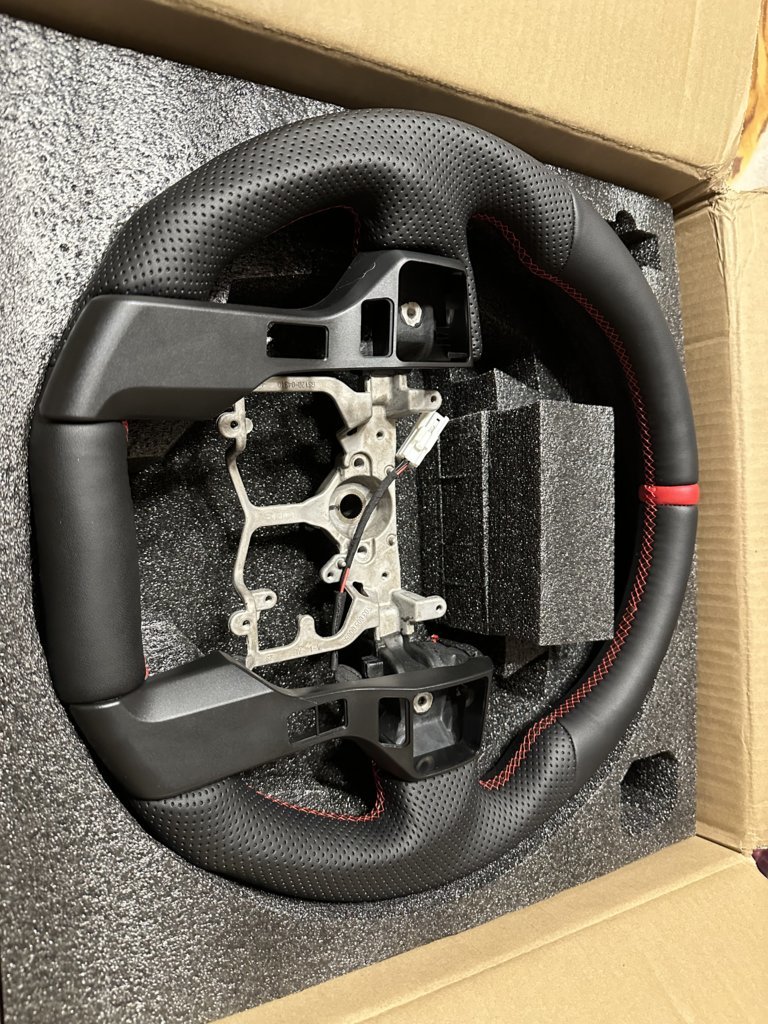

    That is the one I had on order but they sent the wrong one being in all black. Waiting for the new and need to find a spot for the smaller switch as the only opening is the larger switch blank opening on the left side of the dash is my issue. Might put it in the QI charger spot.

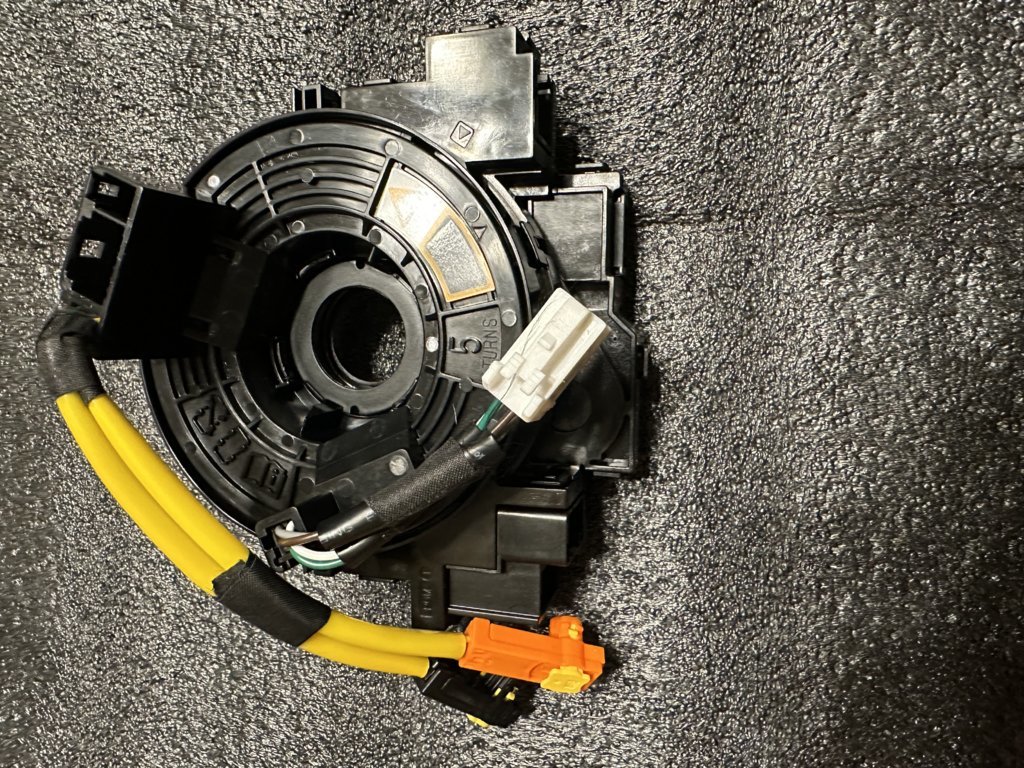

    My first set was with red stitching, but they didn’t have a clock spring for the 3rd gen Tacoma.They thought it was the same as the 4Runner, but different. So I got another set with red stitching and 4Runner clock spring. Being one of the first to buy, they sent me another 3rd gen Tacoma clock spring. (2 sets)Have fun with your heated steering wheel, nice on cold mornings. Goes well with heated seats.
    4Runner clock spring. It has a green clip you pull after installing, engaging it to rotate. The Tacoma clock spring has a center that is pressed down when installing steering wheel engaging clock spring to rotate.

    May be too early to tell, but how's the quality of the steering wheel leather? The link says it's ABS? Does it have a more padded feeling compared to the OEM?

    Appears to be like factory material, but it’s a little bigger in diameter. I do like the feel. It’s heated all the way around steering wheel. It has a small flat on bottom.
