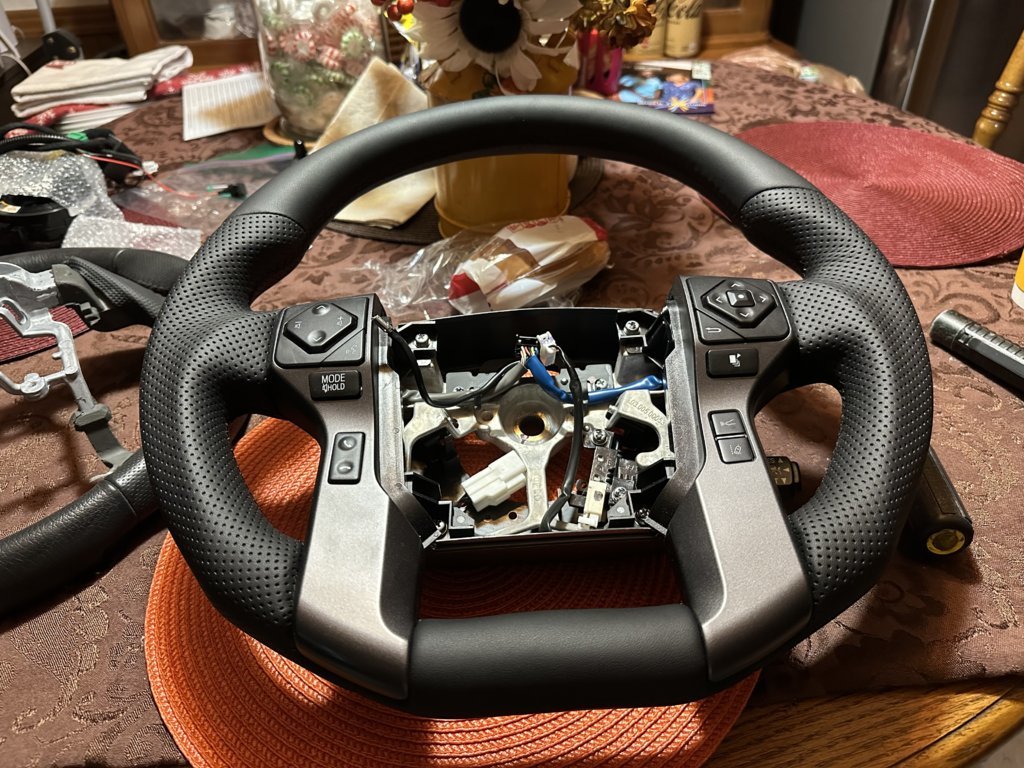

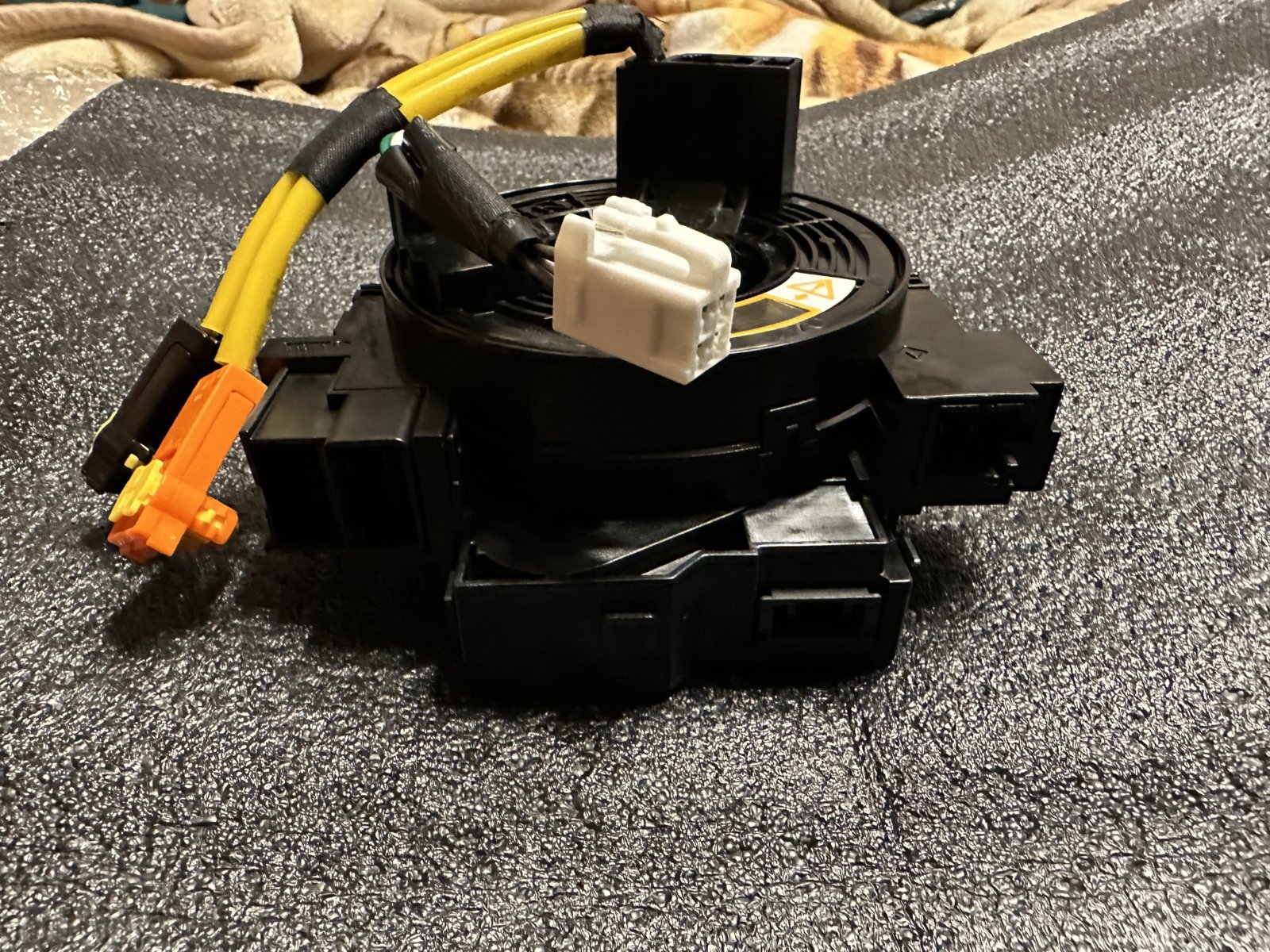

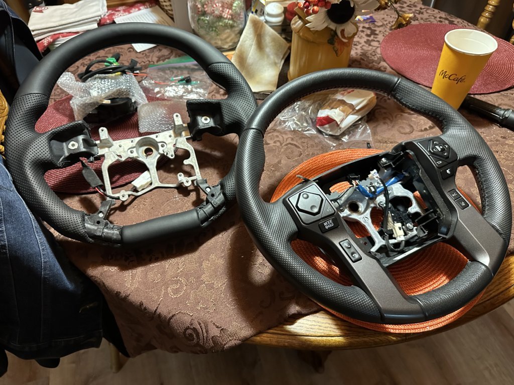

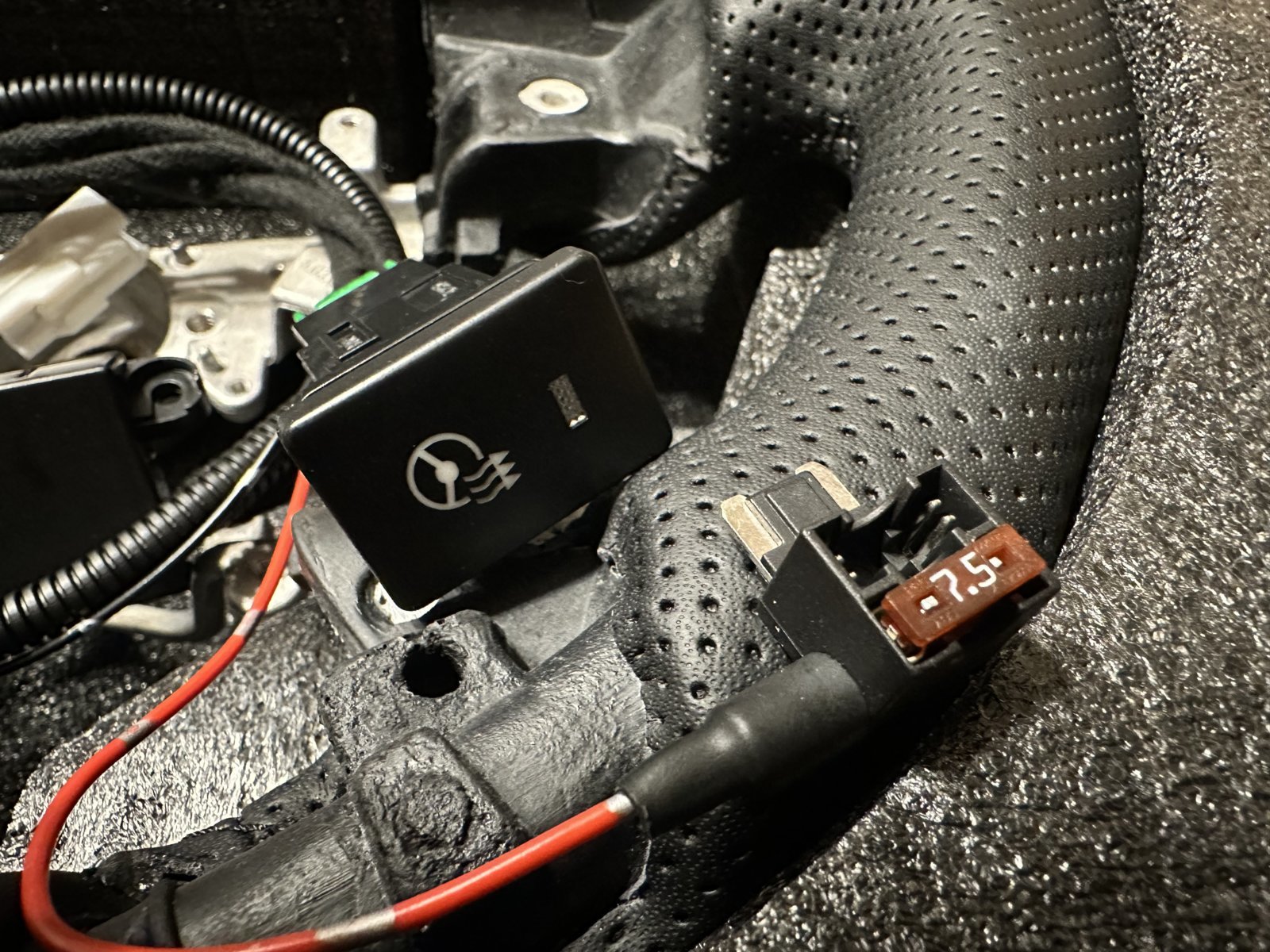

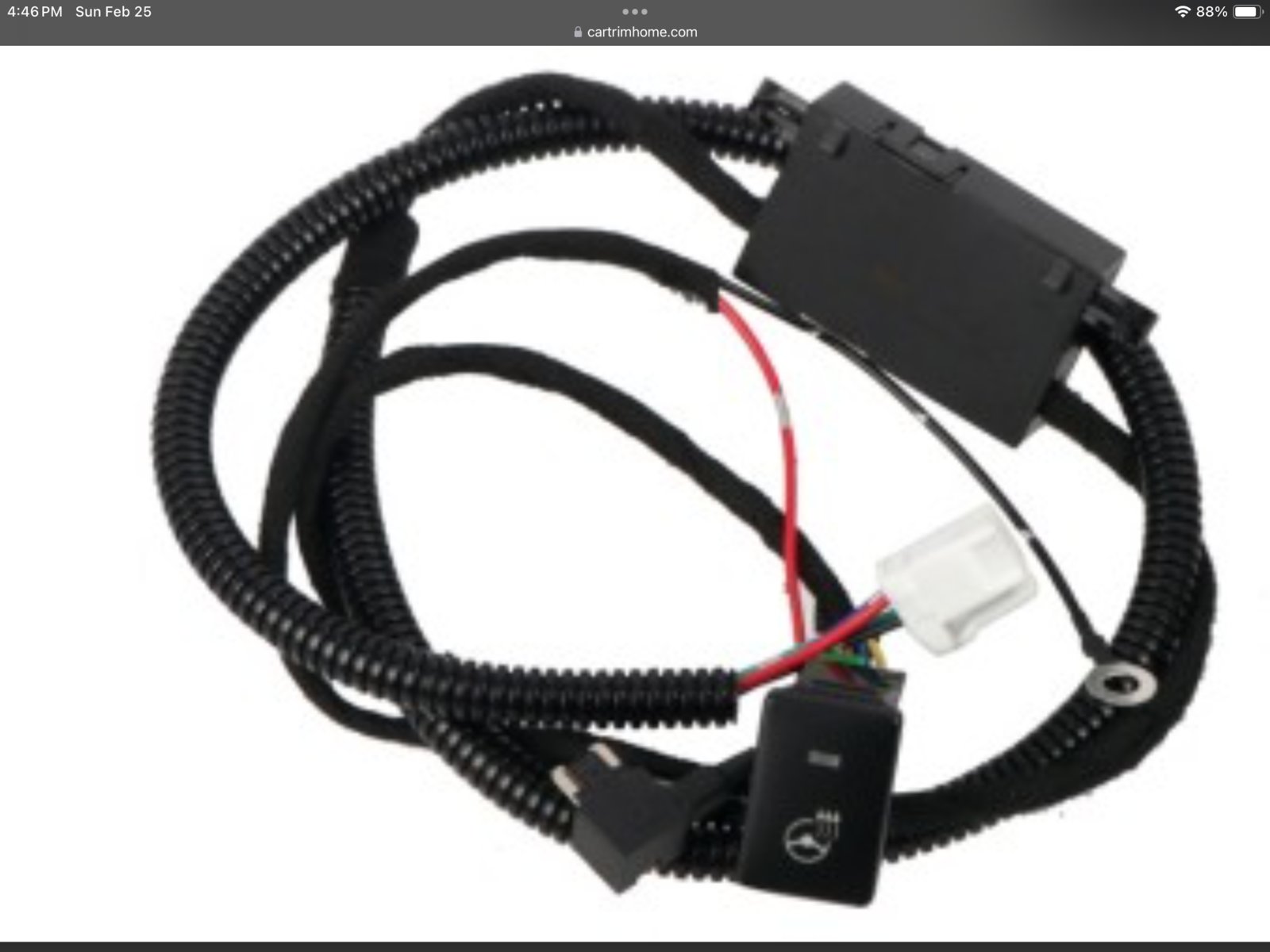

    The wheel itself is of exceptional quality, but IMO for the price they took the lazy way out when it comes to the switch. The backlighting is tied to the on/off function on the switch, so both the backlight and LED light up only when the switch is on. It's easy to improve, just de-pin the ILL+ and ILL- wires from the connector and tie them into a breakout harness (available from multiple sources). That'll allow the switch to illuminate and dim with the rest of your switches. Mine is ready to install, just haven't had a chance yet. Let us know how it goes, the new Tacoma-specific clock spring they provide includes the steering angle sensor already installed which is a nice bonus compared their 4Runner version. Did yours ship with the plastic switch bezels included? Mine was the wheel only, the bezels had to transfer over from the existing wheel.

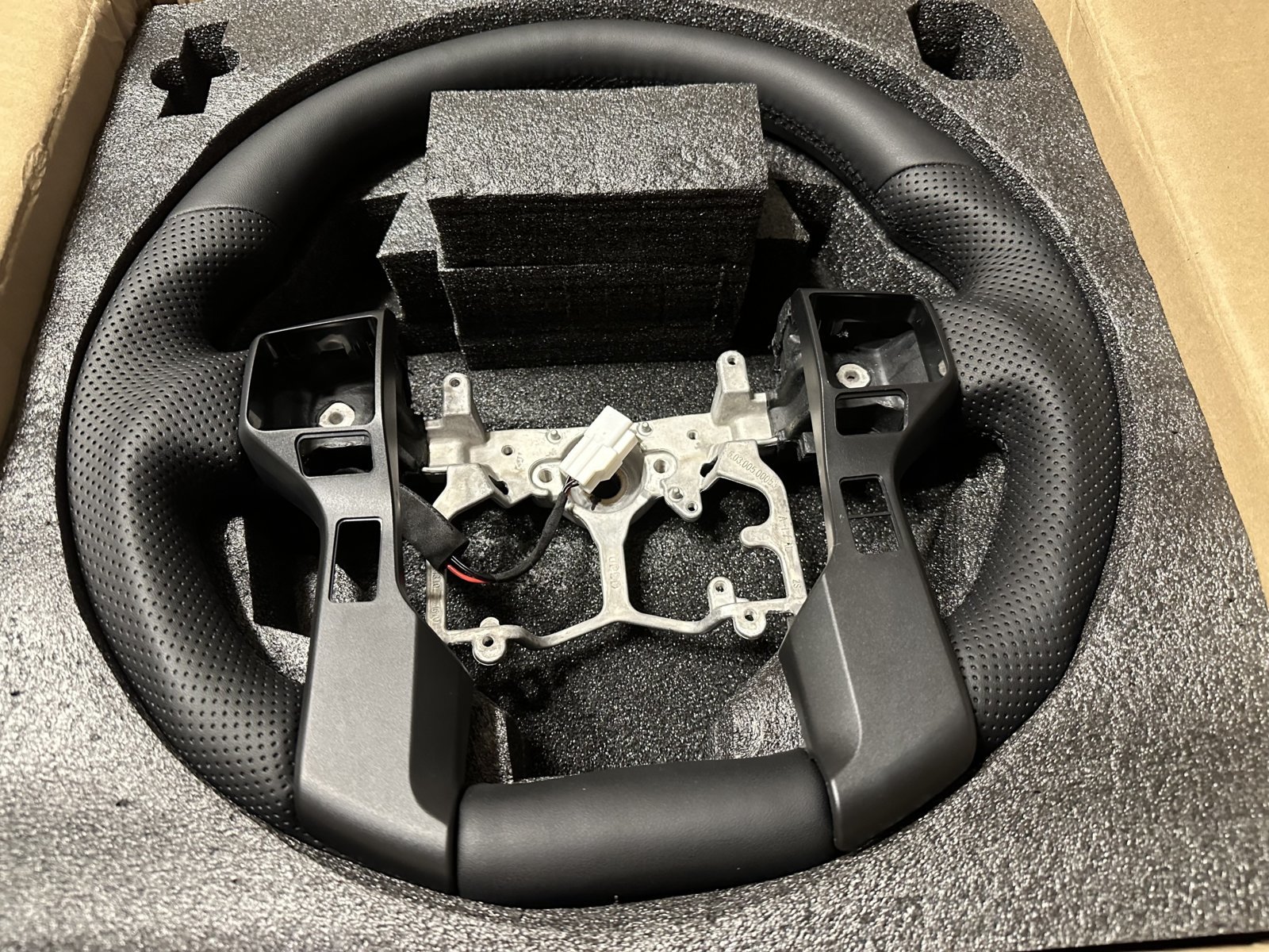

    Just an update and review. I bought the heated wheel and got it installed it a couple weeks ago.
    The wheel gets to a gentle warm which is good enough to prevent your hand and fingers from freezing any further. I do wish it got a more toasty but I only had it on the 15-20mins drive to work. The wheel does get heated all around with the warmest spot between 10 and 2.
    Something that I'm trying to get used to is feel of the wheel. The wrap is less grippy than stock. The description says it's leather but the quality is not on par with OEM. I wouldn't be surprised if it was suede but having that said, it feels decent and time will tell if this will last. It is a noticeably beefier wheel, enough to be feel quite different. There's also a ridge/groove starting at the 3 and 9 o'clock positions down to the plastic bezels which I'm trying to get used to.
    Overall, I'm satisfied. Drives will be much more enjoyable this winter season. A couple of nit-picky items but it accomplishes the purpose.

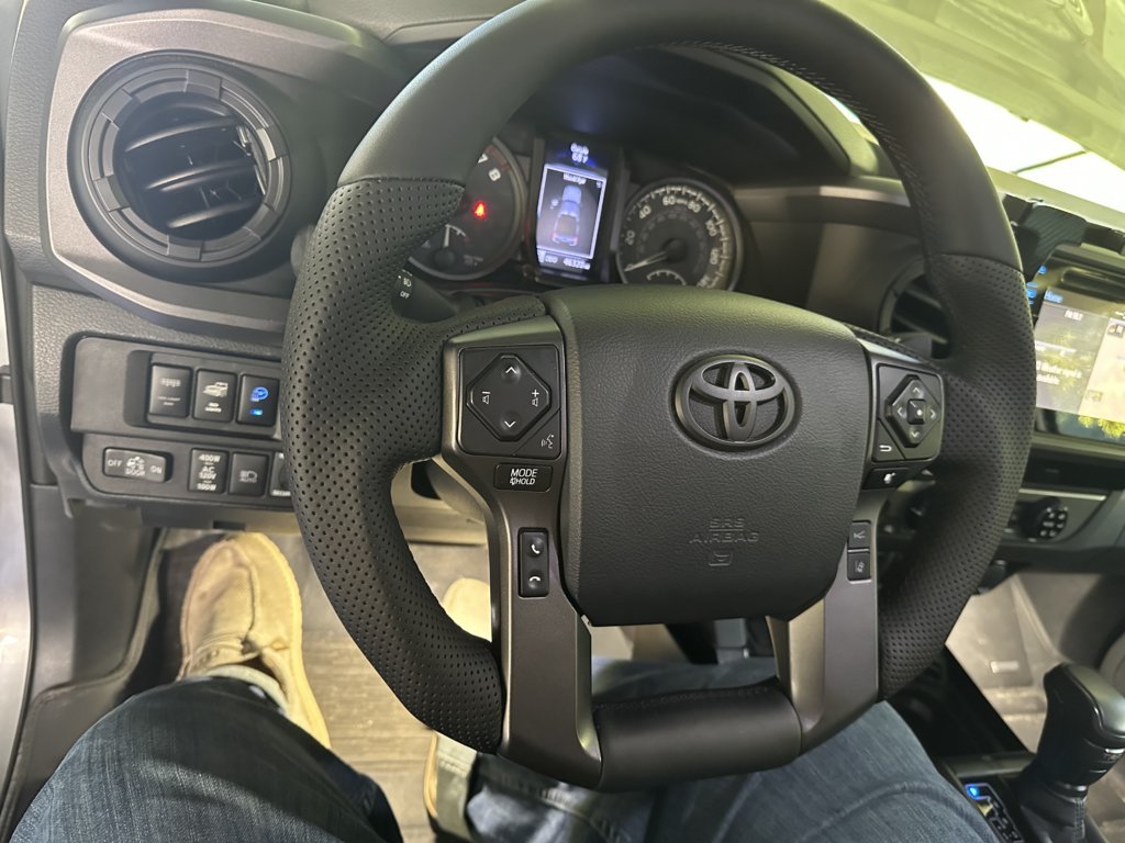

    Here’s mine installed and comparison. The heated steering wheel has a small flat on bottom.
