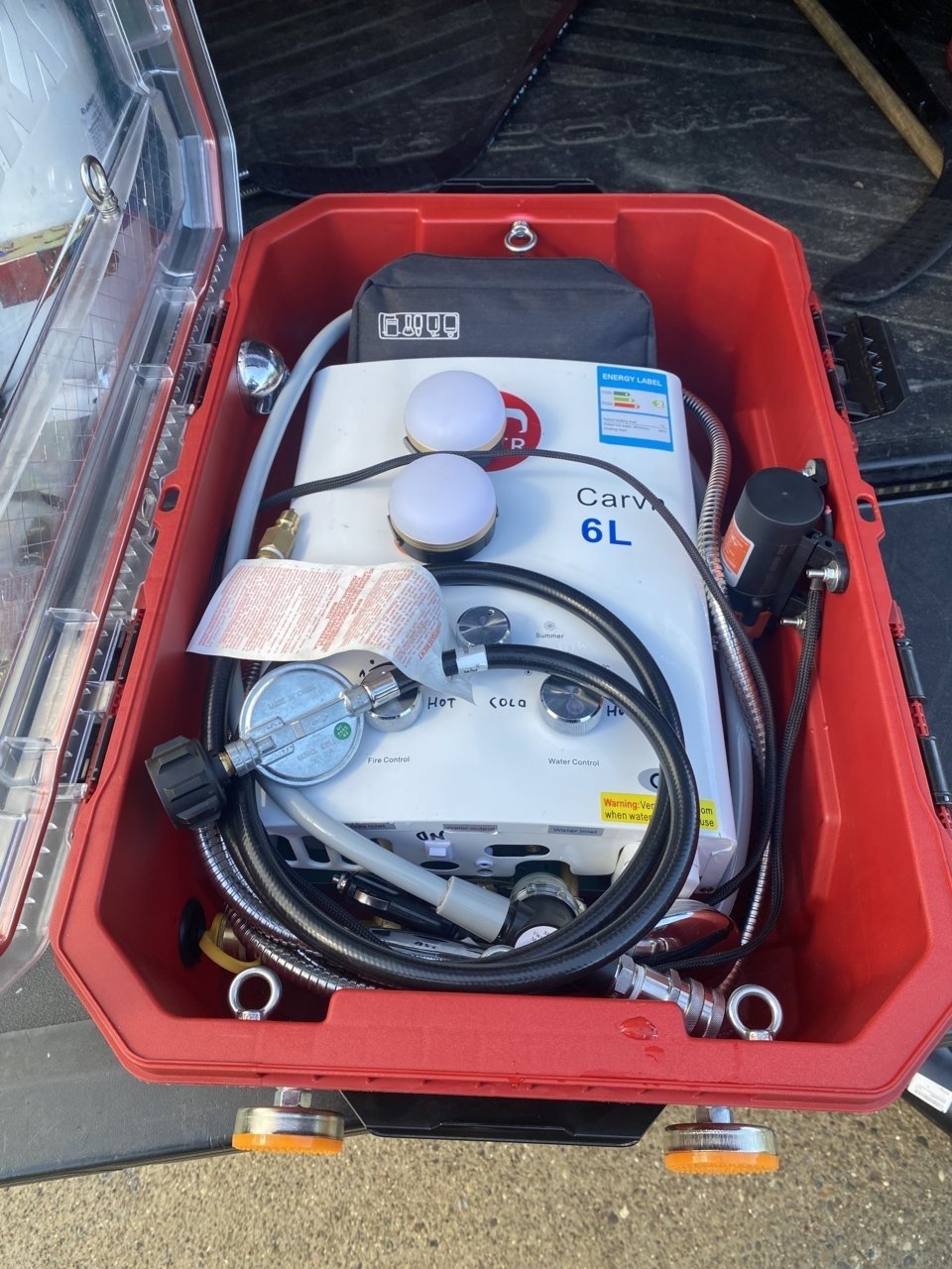

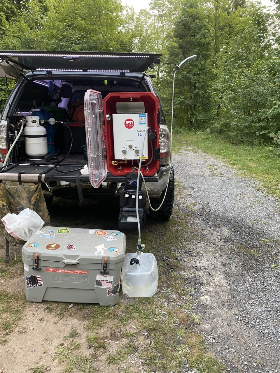

    Hey! Can you give us some pics of how you mounted this under the bed?? I have wanted to do this but havent found the right tank for the job. I do have an 18gal mounted in the bed up at the cab and have a rv pressure pump and use an instant hot water heater for my hot showers (Jolca, would not recommend). Works great when the hot water heater works, but would love to move the tank under the bed.

    Stevo, man, that setup is ROCKIN! Me like. Can you please post a bunch of close-up pictures so I can rob you blind of your intellectual property? Asking for a friend...
    And links to your bits and pieces would greatly aid my hijack efforts too. THE HEATER AND BOX'S bits and pieces, not your bits and pieces you sick puppy. One question: even with the heat divertor plate mounted on top of the water heater, will the box above the water heater get too hot?

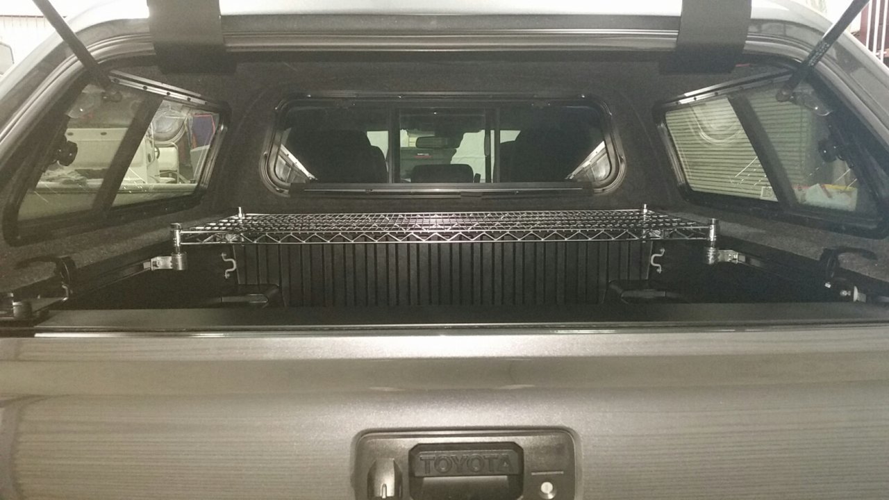

    Heath, I haven't mounted it yet. My wife got cancer and I spent all of my time since then taking care of her. I am pretty sure I won't be mounting it. At first anyway. I'm going to see if the sprayer tank in the front of the truck bed is a viable option. If it works, fine. If I find I need that space, then I will mount the tank underneath and somehow mount (removable) and use the sprayer tank's integral pump and pressure control features, but utilizing the under-bed tank. I've got miles and miles of other stuff I need to do first. New at 10...
    Here is the shelf above the sprayer tank. It's main purpose it to hold the window air conditioner that blows into the cab when it is too hot to camp in the hammock or in a tent. Affords more storage space above the sprayer tank as well:
