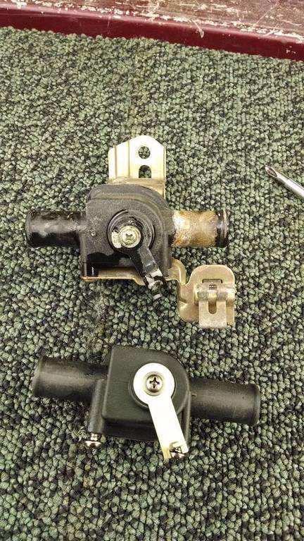

    Well, for the valve, I had to replace mine cause it leaked. NAPA carries them.
    Here is what they look like. You can also use a piece of copper pipe in it's place just to get the coolant flowing.
    You'll have to go in the dash for the cable. Good luck :)
