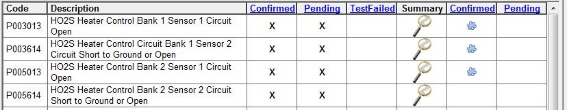

    6. I cleared all the history on the codes and ran a scan, in which the codes P003013 and P005013 came up and a minute later codes P003614 and P005614 showed up. With abosolutely no luck whatsoever on locating the issue, I decided to continue with my life and let the car sit from January 2019 to around now. I drove it occasionally, but mostly left it in the garage.

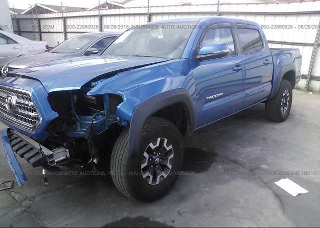

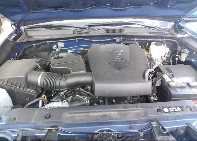

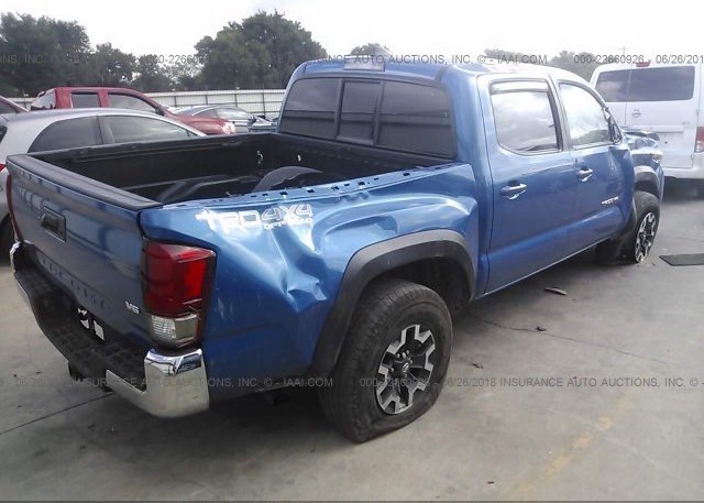

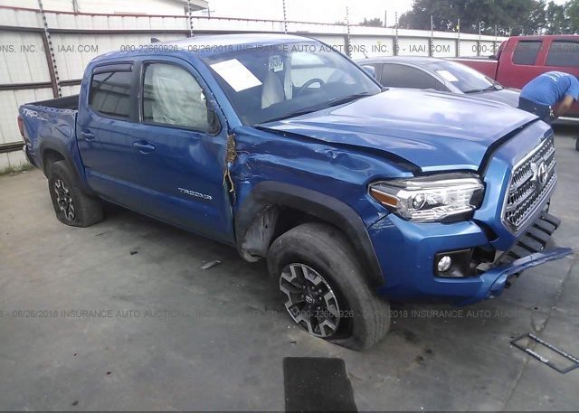

    I was hit right on the right fender and the right side of the bed, nothing too major compared to some i seen. Its mostly just big body parts that were replaced, no frame damage at all

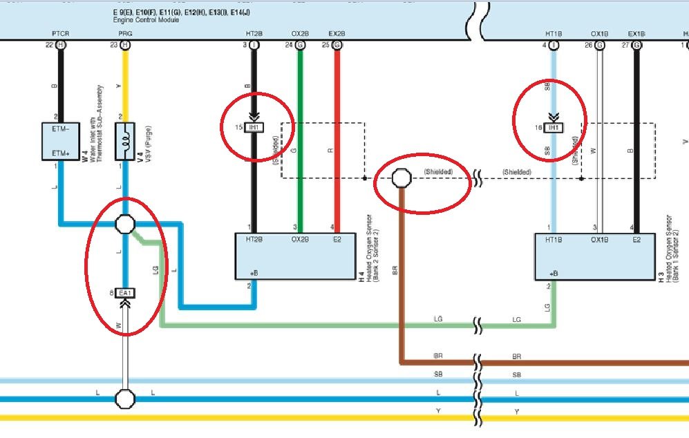

    Ive been trying to follow that diagram but get lost since im not real good at this. I really have to beg you to please bear with me with some questions I have.
    1. Im tryin to find the IH1, now is that inside or outside the car? My guess is outside as the likes that show "shielded" must be going trough the cabins firewall. Right? If not, then what does "shielded" line mean?
    2. Are the octagons found in the circuit some sort of conectors or wired that are join together?
    3. That EA1 line, were is that in the car possibly? Im trying to follow the cables but i loose most of them in the harness that goes from the heating sensors to the top of the transmisson and then to the back of the engine.

    You're doing great! You checked what you have, compared to it's mate and compared to a known-good part. You seem to have your head on straight that's why I'm trying to help!
    I'll answer questions first.
    1.1: I have no idea where IH1 is, I haven't found anything to layout where connector locations are yet, I've just haven't found the resource for that yet. I'm new to Tacomas, just got mine at Christmas, lol
    1.2: shielded means, in this and most cases, that they are wrapped in foil and/or woven metal strands that go to ground on one end or another. It serves to absorb electromagnetic interference and zap it to ground. In this case, it's to keep interference out of the circuit and keep a clean signal to the ecm. Maybe the harness drapes over or runs along the alternator's cable or something, maybe just good insurance, I dunno. Sometimes a cable will be shielded to keep interference IN. Like on a 3-phase low pressure fuel pump, it'll usually be shielded from the controller to the pump but it's to keep the voodoo in, not out. And no, doesn't necessarily have to have anything to do with the cabin per se.
    2: to me, the octagon would appear to be a splice where all the wires come together and are bound and insulated. In my world its a sonic weld and a butyl cap thats taped up in the harness. A Toyota tech could tell you what exactly you'd be looking for.
    3: EA1... see 1.1 lol, sorry man, I just don't know yet.

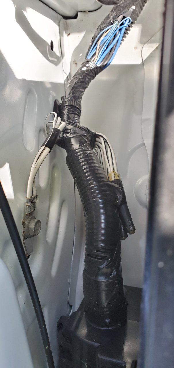

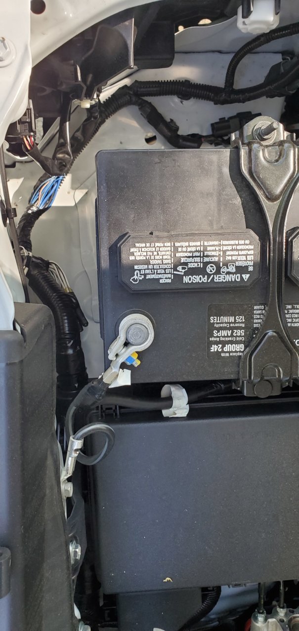

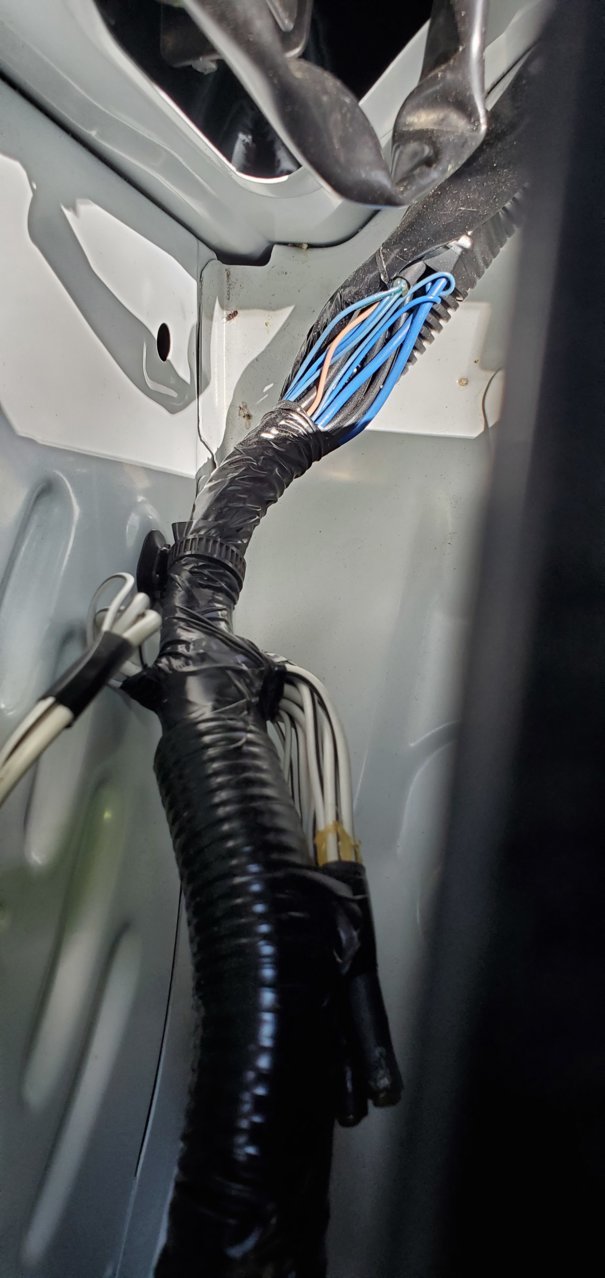

    Well hot damn, look at those splices right in the open by my battery. White/black are ground, look down in the tape... I see at least one, maybe two blue splices. Looks an awful lot like your octagon above and its right where you truck got hit. Have fun digging, thats definitely where I'd go before going back to the meter!

    I finally decided to order brand new four sensors hoping the issue will be cleared.
    To my surprise the fault code never went even after replacement of all sensors.
    Upon further investigations and inspections I found a lose ground wire that connect to power steering pump (vane pump). Luckily I connected it and the fault disappeared immediately. Went back to the old oxy sensors and everything was fine.
    Don't ask me about the link between the two - oxy sensors and steering pump ground wire- though.
    Check your car hopefully it's the same issue.
